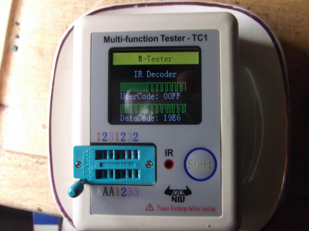

Those TC-1 testers are good for silicon parts except older germanium ones. They all do LCR.
I have a TC-1 and discovered after it arrived that it also tests IR remote controls. The on line manual tells you how right at the bottom.
For germanium parts and high power output transistors I fall back to my home made one with a range of collector current settings. It was made to recreate the graphs in data sheets and can do TO3 lumps on heat sinks at several amps. I built it in the 1970s.
The first upgrade for my home made one was to add an electronic calculator for working out the HFE followed by a bench power supply for IC above the on board 100ma.
It took a good low cost unit for me to upgrade.
Reactions: mrjayviper
Wait, that's not an LCR (Inductance-Capacitance-Resistance) meter. An LCR meter will not help with measuring a transistor.
The circuit you show will sort-of measure a transistor's beta, but transistors are temperature sensitive and that may be the cause of the variation you see.
