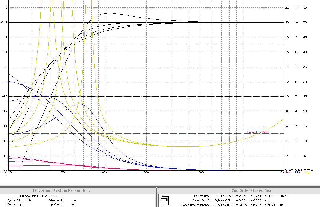

I‘d like to fill in the bottom of small single driver satellites. They tend to begin from around 100Hz to 150Hz. They’re set up in a small apartment living room, so they don’t have to go low and can’t go loud. I don’t listen to a lot of bass-heavy music. I strongly prefer something crtically damped.

After reading your post: You probably will be well served with a 6" or 8' bass driver in a closed cabinet. Something usable down to around 40 Hz, not too much Xmax, low Le, so that it will do the 'low kick' as well.

i‘m experimenting with CHN-50, ScanSpeak 5F, and Bandor 50. The first is vented, while the other two are sealed.
i played with the ScanSpeak & Bandor drivers in sealed one liter boxes (approximately) several years ago. I high-passed with in-line filters (second-order at either 100Hz or 150Hz) to a relatively cheap & vented Yamaha sub. The single drivers sounded great. The sub could have been better. The setup was very near-field, and the satellites were very close together. Today, I have more space & knowledge, so there will improvements there.
i don’t listen at high volumes. I live in a second story apartment, and most of my music lacks heavy bass. I’m after articulate bass, not thump-thump. For that reason, I’m thinking of a sealed alignment, critically damped, using a 150 or 200MM driver, which could be metal. Based on your recommendation from another thread, I’m interested in a plate amp that will crossover as high as 200Hz. I could possibly squeeze in two subs, which would be ideal, as you said.

For bass units, I’m thinking of using two SB Acoustics 8Ohm 5”x8” drivers in parallel per channel. I like sealed. I could use the bass cabs as stands for the single drivers.

SB Acoustics SB15SFCR39-8, from Madisound.

F-3 is only a useful number iof you are adding a subwoofer (ref Toole).
Extention of 2 woofers is the same as one. So the graph posted above applies. I used the Buitterworth/max flat alignment when i suggested 50 litres.
If you were adding subs and not HPassing the mains you wouldbring them im at 50 Hz or a tad higher with a 2nd order LP.
Push-push means way fewer box issues, 2 drivers means +3 dB efficiency, another +3 dB if they are wired in parallel (and the amp does not have issues with the lower impedance).

Thanks very much for the design. It is very much appreciated.
Where would you place the drivers - near the floor (for loading) or near the top of the cabinet?
I now have to work out the dimensions & find a woodworker who can cut a straight line & whose work won’t require me to sell a kidney.
