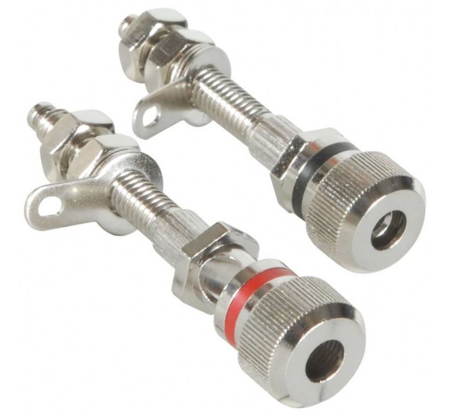

I will probably use this kind of binding posts because they need only a small area on the speaker's back, which will have a small surface.
I plan to connect the wire to both the binding posts and the transducers with this kind of terminal.
The question is: do I need a special tool to attach the terminals to the wire? I'd prefer to avoid buying an expensive tool if I can use a simple pair of pliers as I don't plan to build more than a very small number of speakers.
Otherwise, is there any way to tie the cable to the speaker and the binding posts by screwing it?
Thank you for your help.
I'd solder directly to the driver terminals...
What Matt said.
I do not like terminals.

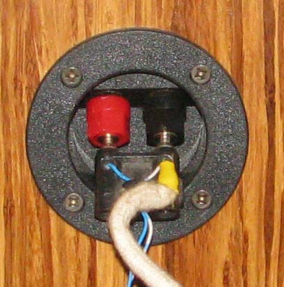

And those binding posts are not something i would use… look for something with less metal. And with that kind mounting in the back panel, can you get the soldering iron into the box to solder the wire? I like to use a removable terminal cup (as small as i can get) to make wire installation or change fairly easy.
dave

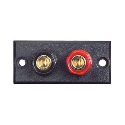

I believe — some will say it is silly — that less metal helps things sound better. The pinnical of that would be the Eichmann or WBT Next Gen. Both horrendously expensive. Fortunately knowing tha some of the cheapest connectors (with plastic nuts) due to cost constraits have less metal to keep cost down.
These are decent, cheap, and better than the ones you linked (IMO). We mostly use the cup — kinda hard to find thou. The 2n dis from PE.
