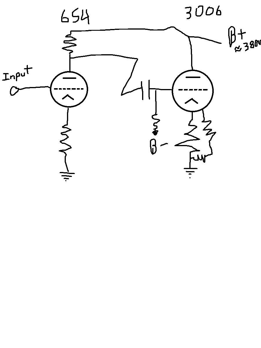

OK, I had an idea, but I started thinking and I don't think it'll work anymore. I think I might be creating some kind of feedback loop but I could use an expert opinion.
I drew it out in paint, lol, so bare with me...
Notice there is NO resistor between the plates.
What is the general value required? Or typical voltage drop required between plates?
Or will it work...

Grounded??? I don't see how, it'll be decoupled and plates aren't grounded, cathodes are. I think you're confusing me.
Could you elaborate please?
In that schemo, both plates are at AC ground, since the DC rail is AC ground. An ideal DC source won't have any voltage variations across it. If there is no AC across the DC rail, then that's AC ground.
Active devices (hollow state or solid state) won't develop any output without either a passive or active load, and here there is none.
So, I'll need the resistor between the DC rail and 6s4 plate to allow for an AC to pass to the grid on the 300b, I thought as much, never seen a circuit like what I drew.
So then what sort of value is needed? If I threw a 5k in there would that be OK? I think I measured approx. 25V drop on 5kohm. Or does it need to be more to be equivalent to voltage swing needed or something? ie; approx. 150V drop???

Lol, I'm not, I just try stuff out, learning, occasionally with success and sometimes with disaster, if I don't know I ask. I really prefer to learn that way as it's way more exciting. I've been playing around with the same amp nearly everyday for hours tweaking for over a year, it's allot of fun for me. However I think I'm developing Audio Autism.what amp are you trying to build? your circuit as shown will not do anything...
Agreed. This seems like it'll be a lesson in frustration for the OP.Trial-and-error valve amp construction without the benefit of any electronics knowledge seems a bit of a Darwinian pastime.
OK, If I did this, this would work, and both plates are still being fed by B+ like I already mentioned (by me) the difference is a resistor, and still no one can suggest a value???

Google "tube load line" to discover how anode resistor values are chosen.
Remember, intuition has to be constrained and educated by facts - if not it can lead you seriously astray.
Playing with 1kV supplies without the benefit of a good knowledge of schematics is a good way to enter for a Darwin award. Since you have kids, does your wife have you well insured?

Go here: Steve's Tube Pages. Scroll down to "Loadlines Pt 1" (in the rightmost column). That'll answer all the "dumb" questions.
