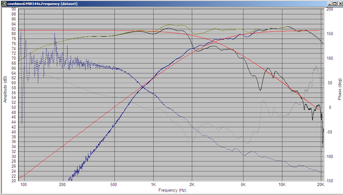

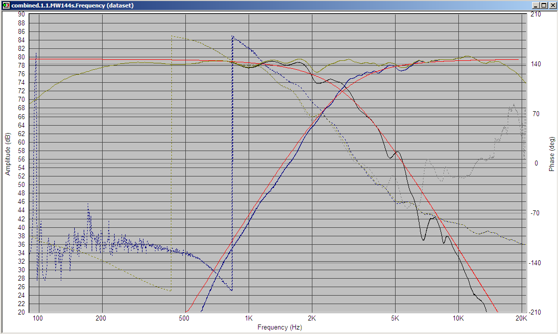

Attached are images of the first crossover I did for my MTM's and the final one. The difference here is not subtle! Most obvious difference is that I dealt with Baffle step in the new one (which I was originally planning on doing at line level), but the other difference is a change from 2nd order bessel acoustic rolloff to 4th order bessel acoustic rolloff with MUCH better phase tracking.
I'd be very surprised if you could not hear the difference between these two crossovers, regardless of experience . However I lived with the first one for quite a while (probably about 12 months), because it didn't sound too bad. It was certain tracks like the ones I mentioned that sounded bad that got me looking to fix the problem, and a post from Lynn Olson that started me on the right track. Once I redesigned and implemented the new crossover the difference was very noticeable
So I guess where I was going with that was that perhaps the changes you are making whilst they are making the speakers different, they may not be changes that make the speaker substantially better or worse. Just sub optimal in differing ways.
