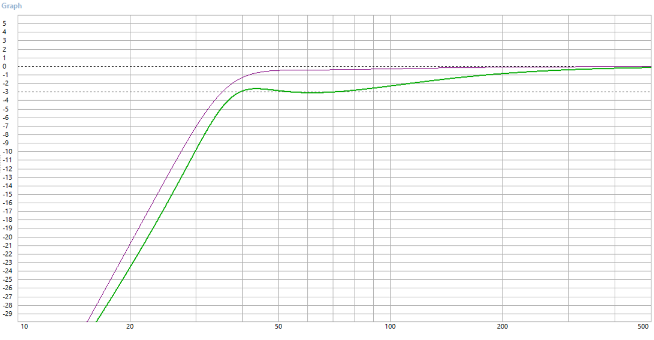

Did a wee bit of simulation using WinISD to compare the Proac R2.5 Clone vs the M5. Results are a bit puzzling (to me at least).
Red = M5
Green = R2.5 with 38Hz tuning in 34L box (as per spec I believe)
Blue = Must messing with tuning on the R2.5 to see what happens if tuning dropped to 30Hz
Couple of observations:
1. The Proac looks very bass heavy
2. Proac with modified tunning looks pretty nice
3. M5 looks a bit bass light but this is not consistent with Goran's simulations. I think Goran uses LSPCad. Is LSPCad including other factors in its simulation?
Cheers

simulation results depends much on which parameters you are using, official or those you measure yourself. try those measured by audioexcite, see under measurement, what do you get then?
That could be it. Unfortunately, no measurements have been published for the 18w/8545.
I've downloaded the demo LSPCad so will try to find some time to simulate the official results in that tool over the week. If it reports the same as WinISD then I guess it must be measured via official data.
Cheers.

Audioexcite has measurements of the 8545-01 on the website, quite different values then officials
Thanks. I did not seem to be able to find a link to that page via the main site. Google found it though.

Well, hot damn, doesn't that just make it all better!
Looks like perfect agreement with Goran's results. Thanks for pointing out the measured data on the site.
-6dB at 32 Hz seems pretty good to me. Excursion and port velocity all look nice too.
I'm starting to think this looks like a winner.
