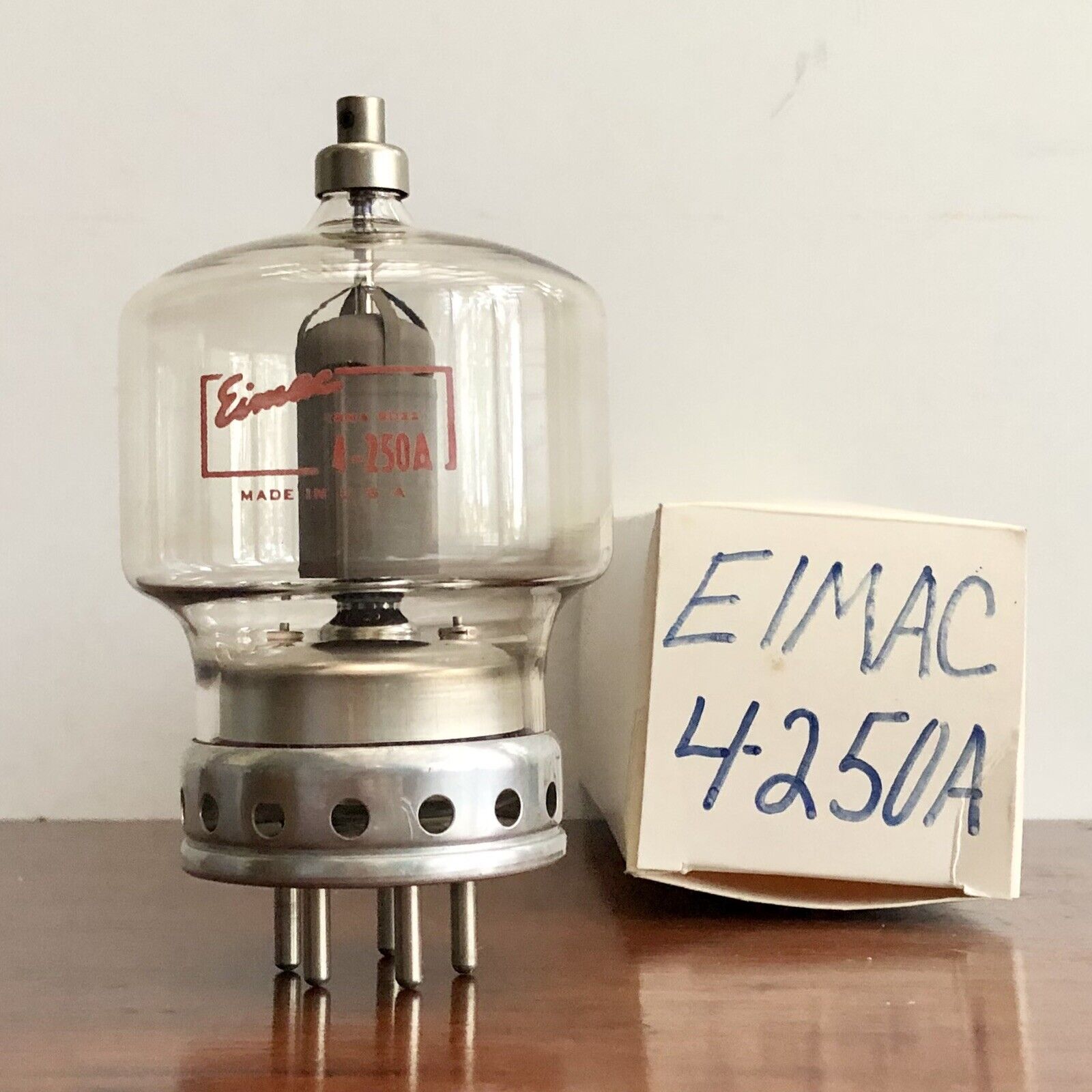

i have the 4-250 with circular plates...they are also good for audio...Why didn't designers and manufacturers make audio tubes that used circular elements?

Yes, your 4-250 has a circular plate . . . But both g1 and g2 are circular bird cage grids.
I am not sure whether the Thoriated Tungsten Filament is approximately circular or not; can you look at it and tell me if it is, Please?
I used a 4-65A with circular plate, circular g1 birdcage, and circular g2 birdcage.
I can not see the thoriated tungsten filament to see if it is approximately circular or not.
I experimented with the 4-65A, I grounded the plate (no plate current), and used the g2 grid as a Plate (10 Watt dissipation Screen).

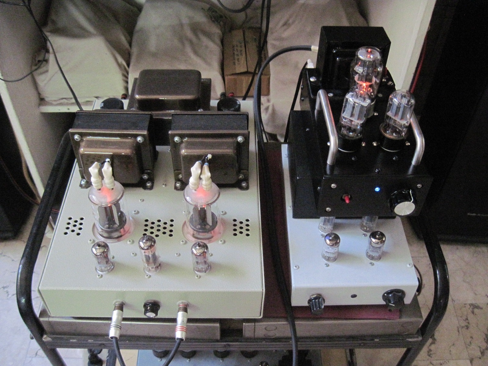

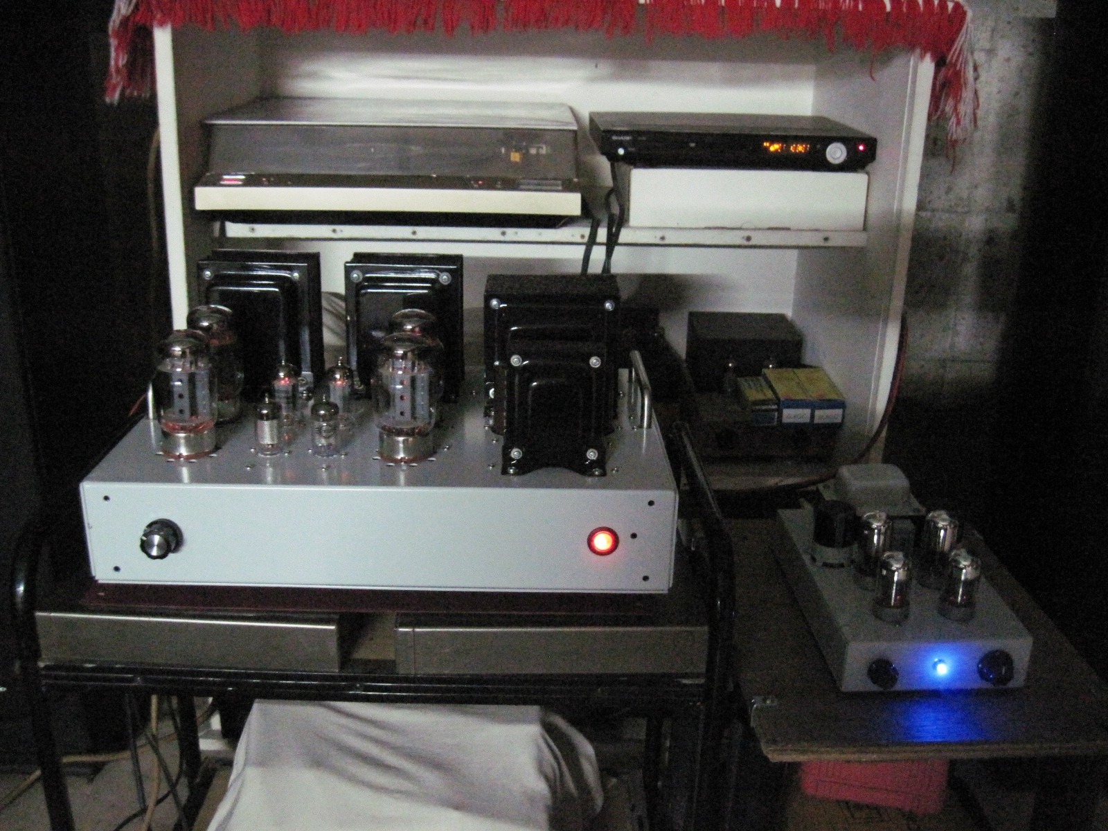

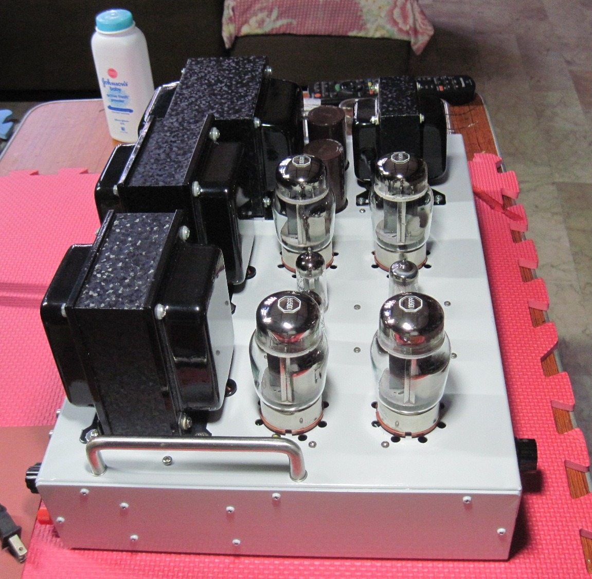

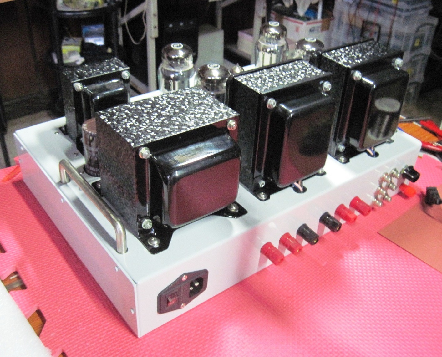

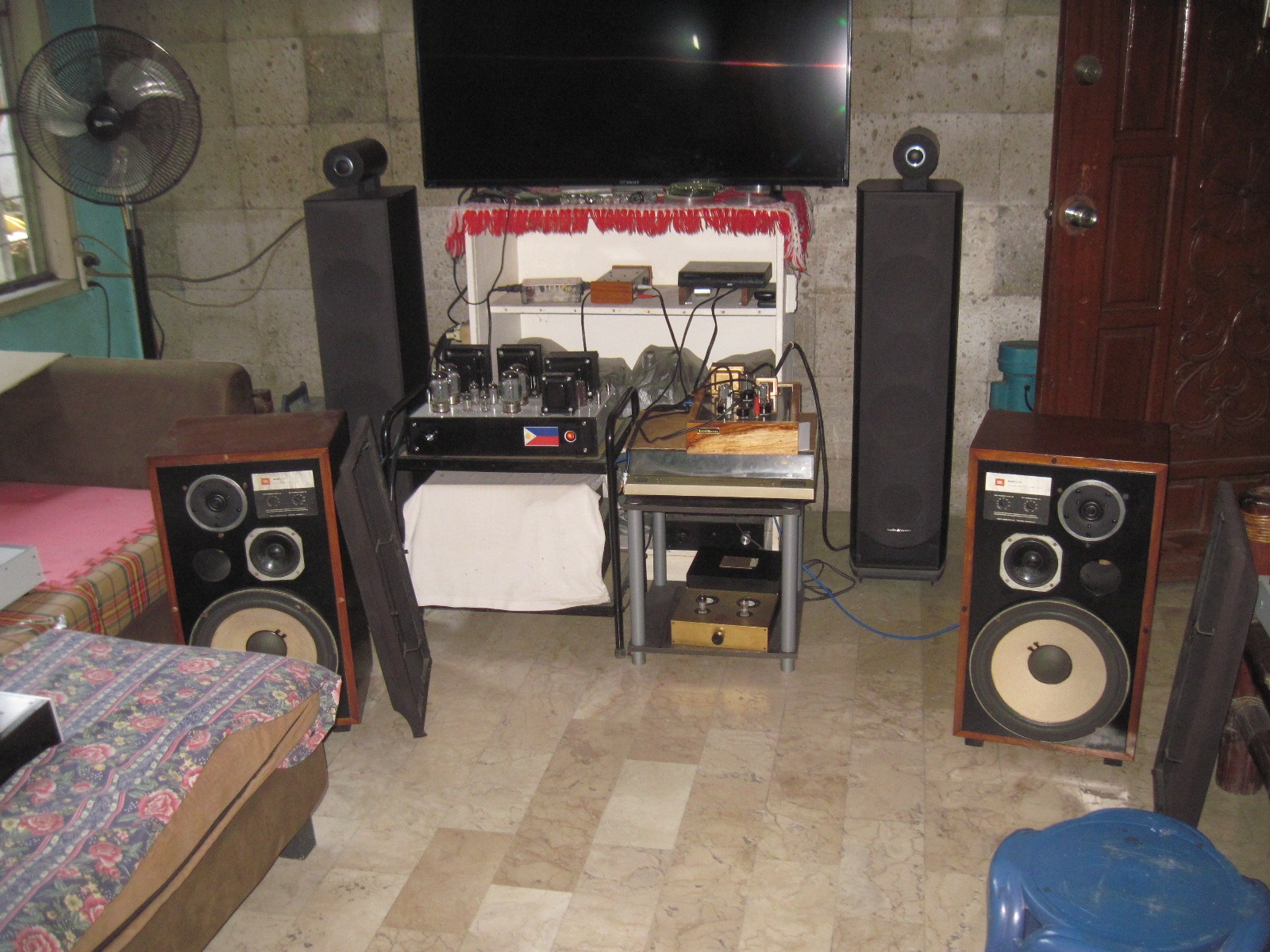

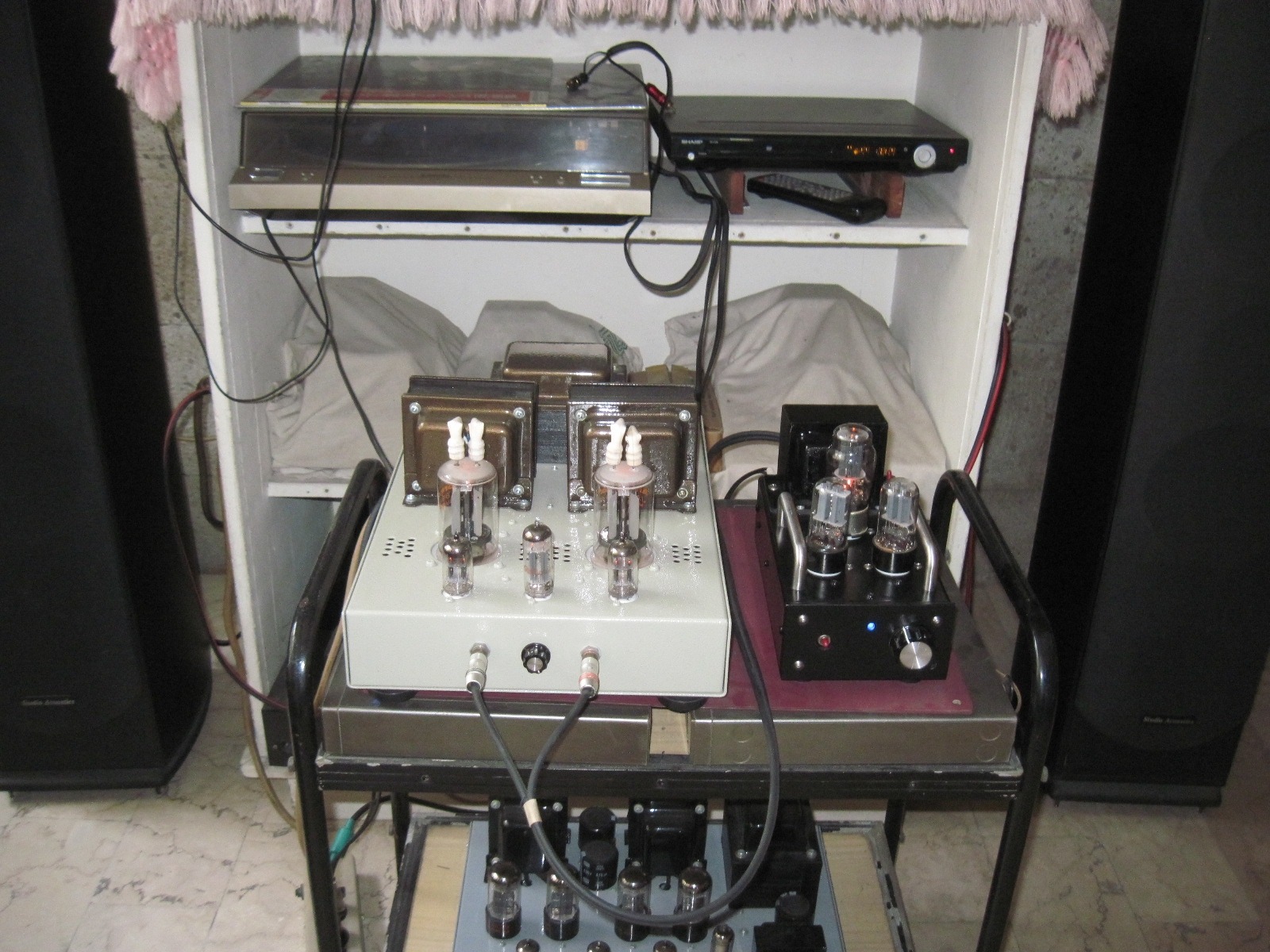

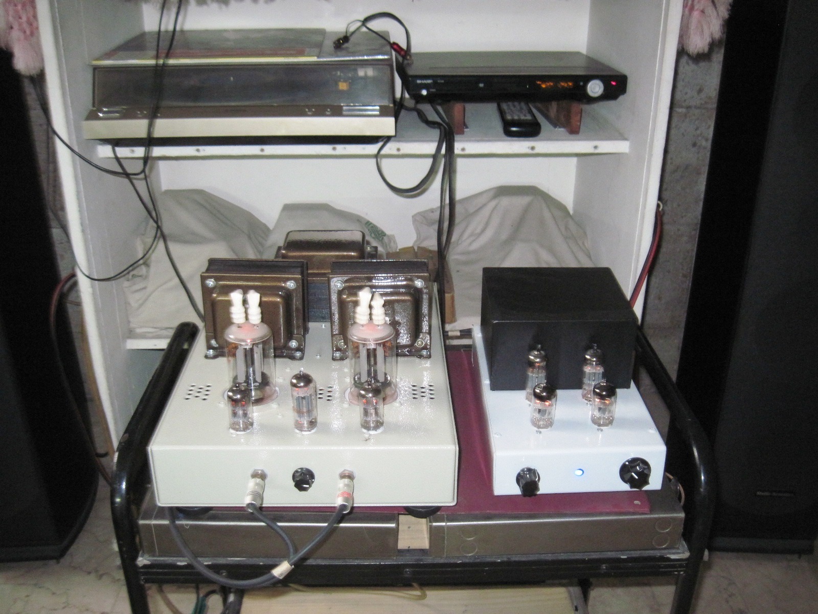

the D3a did not have round plates, but was well received.....
so is the 12HL7,
the 5894, a dual pentode, sounds fantastic in my amp, go look at their plates...
i attached pictures of tubes that i actually used in my amps...
With the 5894 are using one tube in push pull?
better than the 829b in ingle ended, push pull is excellent...With the 5894 are using one tube in push pull?
what i liked with the 5894 is that it had only a single cathode structure so that matching between sections are bery good indeed..
oh yes, one tube for push pull, those unfamilliar with the 5894 may think of the amp as single ended...With the 5894 are using one tube in push pull?
