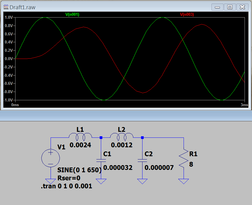

I've shown here a regular filter with input and output waveform, showing phase behaving as delay at one frequency.
All that is then needed is to have the right amount of relative phase shift per frequency to fit the delay characteristic.
Actually delay is not frequency dependant at all.
Fixed delays fall toward zero degrees at DC.
Also dsp can delay the whole signal without any phase shift at any frequency.
No, it only appears this way if you subtract the delay.. which then misses the point.
Show me a passive delay that delays all freqs. 100ms.
100ms, that's 35m. I'm sure we'd have fun with that... the assertion was that delay isn't possible passive.
