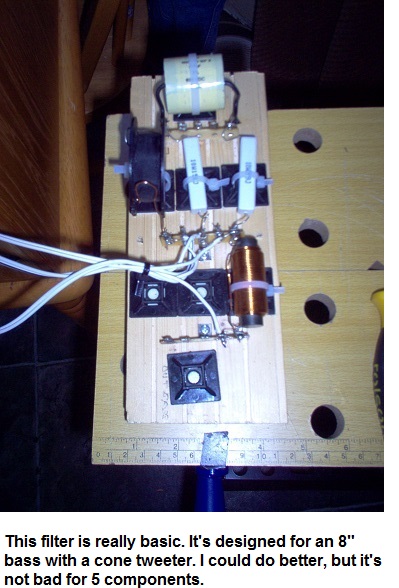

The only really convincing measurement of crossover problems I have ever found was mutual interference between coils, and coils being affected by nearby thick ground planes.
456915d1420233771-inductive-interactions-crossover-components-coil-interaction-1mh-0-2mh-3-3uf-jpg
My 1mH ferrite coil measured 0.827mH due to a ground plane. Here a silver ashtray of high conductivity. Thin tinfoil had no effect. FWIW, aircoils are measureably better than ferrites on hysteresis and avoid saturation.
The tweeter picked up the 1kHz whine from the inductance meter too. You could hear it. Capacitors were unaffected by nearby coils.
My takeaway was mount coils at right angles or far apart. And point to point wiring might be better than PCBs for crossovers. I have some substantial generic 630V capacitors, but am unconvinced they work better than cheaper, smaller 250V types.
