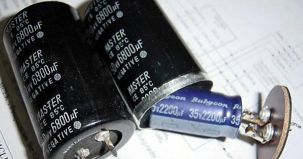

If the capacitors are bad, don't throw them away but donate them to a vintage radio society. They can always remove the contents of the cans and hide new capacitors in them to turn them into vintage-looking good capacitors for vintage radio restoration.
Like this?
Reactions: lene and grataku
