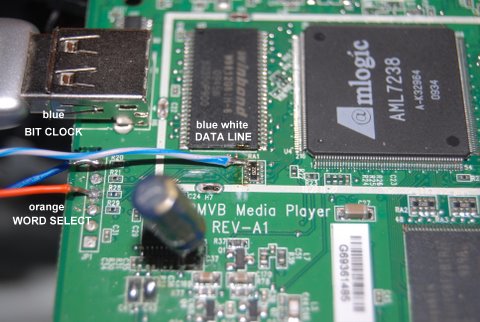

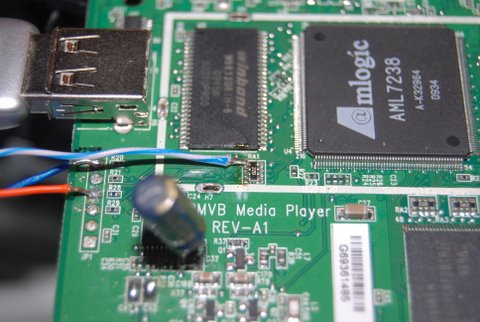

Here are the instructions for extracting i2s (philps format) from the WD mini media player.
1) open the case by removing the 4 rubber feet on the bottom of the case then remove the screws
2) remove the board
3) there is a metal EMR shield covering the IC's. You need to remove this shield to get access to the data line of the i2s.
Removing the shield is a bit difficult because of the lead free solder used.
there are six tabs attaching the shield to the PCB. I ended up cutting the centrally located mounting tab and then:
using some fresh solder applied to the next mounting point, and holding the iron tip in place, pry the shield away from the board until the mounting tab is free.
Repeat this process on the next tab until the shield is free at one end and keep doing this until the shield is held only by the far end centre tab, then cut this one off.
Now the shield is removed. (*note: it is probably possible to carefully cut all the tabs, rather than removing with the above method, as the shield seems to be there so the device passes EMR emissions testing, rather than to protect the circuit from interference. The unit works fine without the shield.)
4) there is a SMD resistor array of three resistors. the resistor furthest away from the DAC, and closest to the microprocessor is the one that has the i2s data line.
here you can solder your wire.
5) next to the USB port there is a blank header on the board, here you can access the other data lines.
The pinout of the header starting furthest from USB is as follows:
pin 1 3.3 v
pin 2 gnd
pin 3 master clock
pin 4 left right clock or (word select)
pin 5 unknown - but it is not data - that’s why you have to remove the shield!
Pin 6 bit clock
Now you can connect wires to the bit clock, LR clock and Data and connect these to your DAC
Photo of board attached.
Enjoy!

Dagwood,
You are most welcome.
If you want to use a media player as a transport with i2s with your Burr Brown Dac, the TEAC wap2200 http://www.diyaudio.com/forums/digital-source/153462-teac-wap2200-whats-inside.html
( i think) uses EAIJ (sony format) i2s which should interface directly to your PCM63 DAC. ( but do your own research to confirm this)
Although I don't know what it sounds like and whether this is a viable alternative???
I can highly recommend the WD mini as a genuinely audiophile stand alone HDD music source. Although it sounds better with a flash drive than with the HDD.
I will have to try a USB isolator ADuM4160 USB Isolator board, bare PCB and kits « Circuits@Home and see if this makes an improvement when using a HDD.
