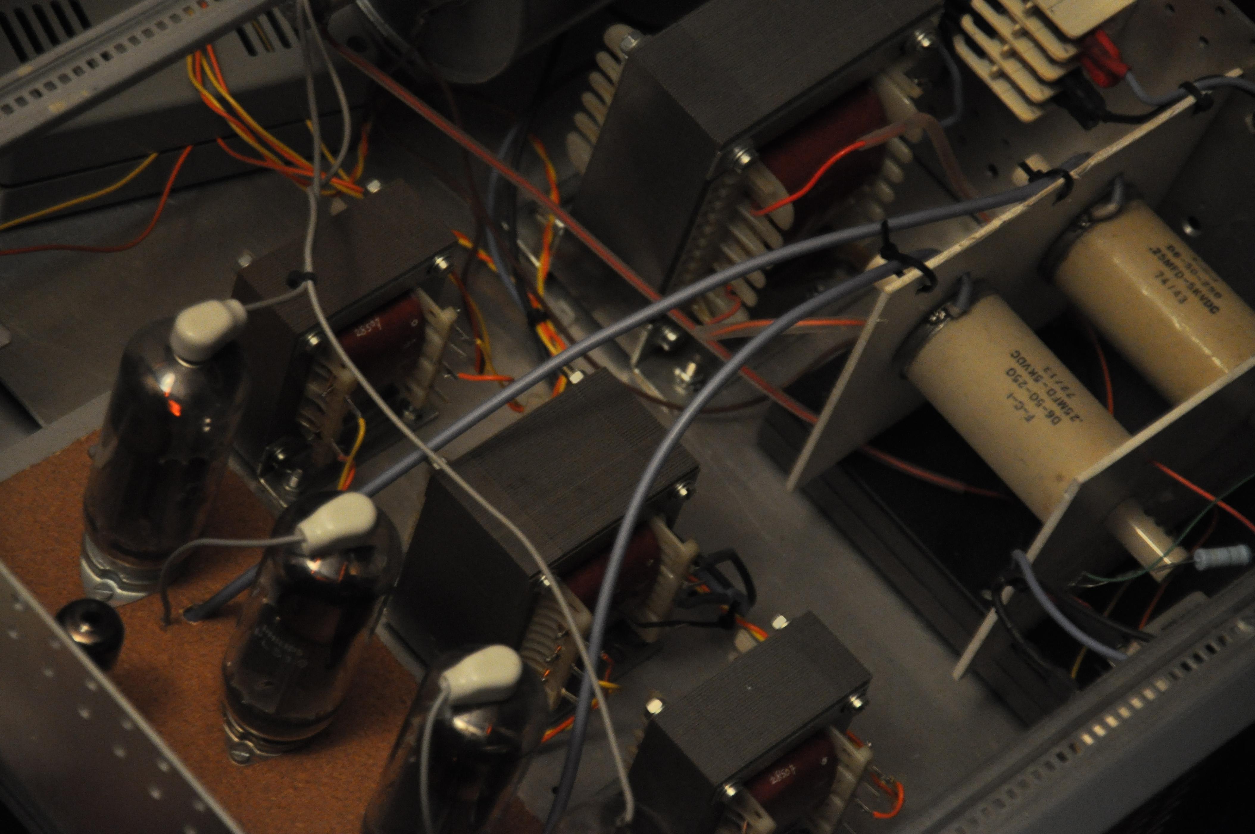

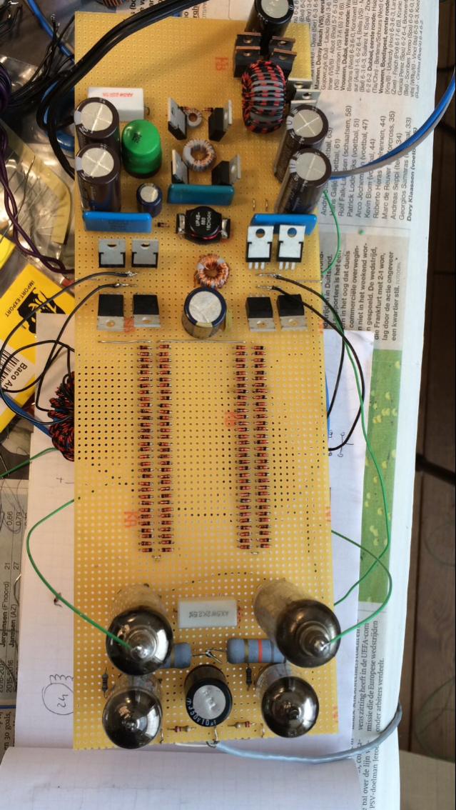

I could tell you if i had a chance to listen to all the speakers out there, but yes, they are special. I usually listen to my Acoustat ESL's as these can produce the sound pressure levels i need for the life experience. The Bev's have the "magic" of not being there at all (you can put your ear against one and still hear stereo). But they do have a "color" and this is less with the Acoustats or any other full range ESL i know. This because they are "boxed". This "color" is not annoying but if you look for the ultimate colorless speaker it will not be your choice. However the spacious sound is unequaled. I have heard the Bev's the first time in 1986 or so and knew directly what kind of loudspeaker i wanted "when i grow up" as these where out of my league at that time (i owned B&W Model 70 at that time). Later i found the Acoustats and never looked back. These have another important advantage of the Bev's, they do not break!
The Bev's are weak in construction, especially the panels and power transformers(compared to the Acoustats). The amps need to be rebuild (this is true for the Acoustats as well), but when being in good condition they are magical. If you have a chance to audition them i would sure recommend it!

I have rebuild the amps for the Bev's and the Acoustats (all tube) and these are stable for more then 10 years now. Yes, the old Quads are very nice indeed but can not give you a full range experience (sub bass experience) as the Acoustats can. I do not listen to ESL's with step up transformers anymore as these can not even come close to a direct driven ESL. I like the way the Beveridge panels work but only the older (aluminium frames) panels are stable not the plastic (blue frames) ones. They are a difficult to refurbish (diy). If you know a trick how to do this i would like to know as i have some that need new foils.
I use in my main listening room a set of Model 4 plus a set of 1+1 and some additional panels. These all can be driven by 2 amps only.
