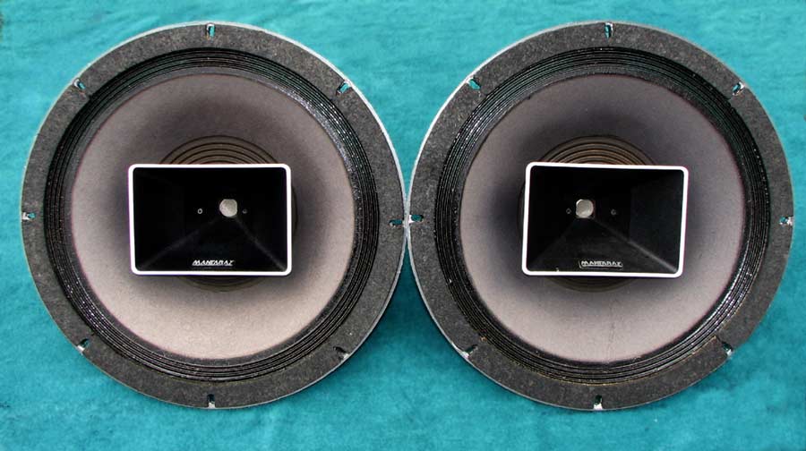

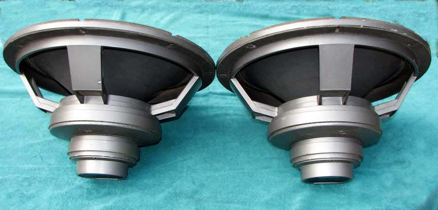

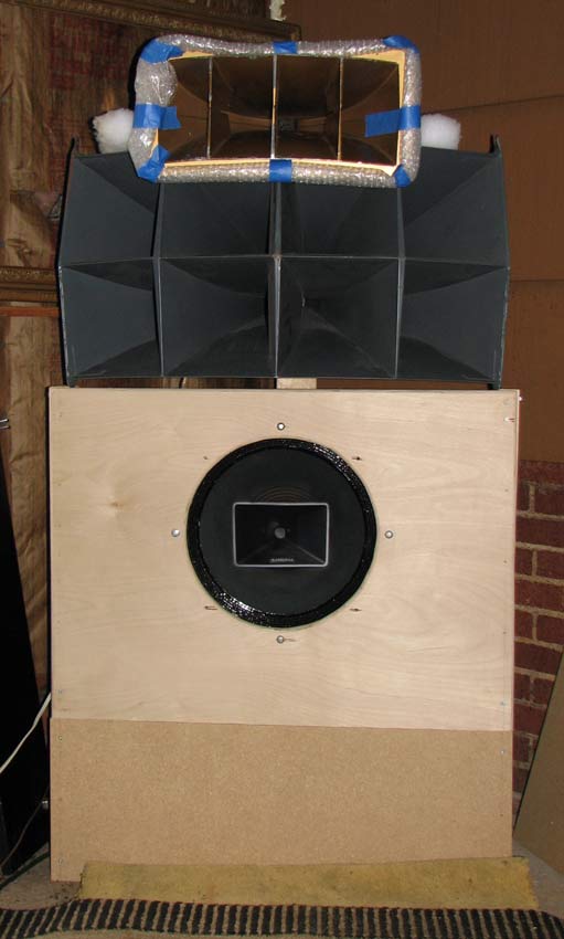

FWIW, here is a picture of a monstrosity I built a few years bad with a 604. They were the BUS - Big Ugly Speaker. The box was about 17 cubic feet, or around 480 liters which was what the T/S calcs called for, or maybe a little bigger. I used them both sealed and vented.
They started off with just the 604s which had been overhauled and renewed at GPA. The woofers by measurement were basically 515s, thus being very efficient and dynamic, quite amazingly dynamic. Only played down to about 48Hz tho, then rolled off. I didn't mind, as they were very solid down to that point, unlike many so called "20-20K" speakers.
Later, as seen below, I started experimenting with midrange horns, using the 604 as woofer and tweeter which worked well. I prefer the big horn midrange, but a lot of people prefer the punctuality of the coax.
Nothing performs very well with denser, over compressed more modern music. OK, maybe the speaker on your phone. :p
IME, the 604 and 605 retain all of their advantages on more recent music. If you like thumping bass, you can add a peaky subwoofer and have a lot of fun. But maybe other people will have more experience. Mine is more with larger horn systems, tho I do really like the Altec coax drivers.

I had a 604C in a Karlson and used a Urie 801C which is an E-145 with a concentric 2425 as my center channel for years. Really enjoyed both. I would be very careful with the older alnico drivers my cones were paper with doped edges and light not exactly deep bass material. There is quite a bit of sub 40hz bass at high levels in modern music even if they can do well I would use a subwoofer just to protect the 604. Eventually that paper is going to start cracking and the more you can limit excursion the longer they will last.
Rob :)
