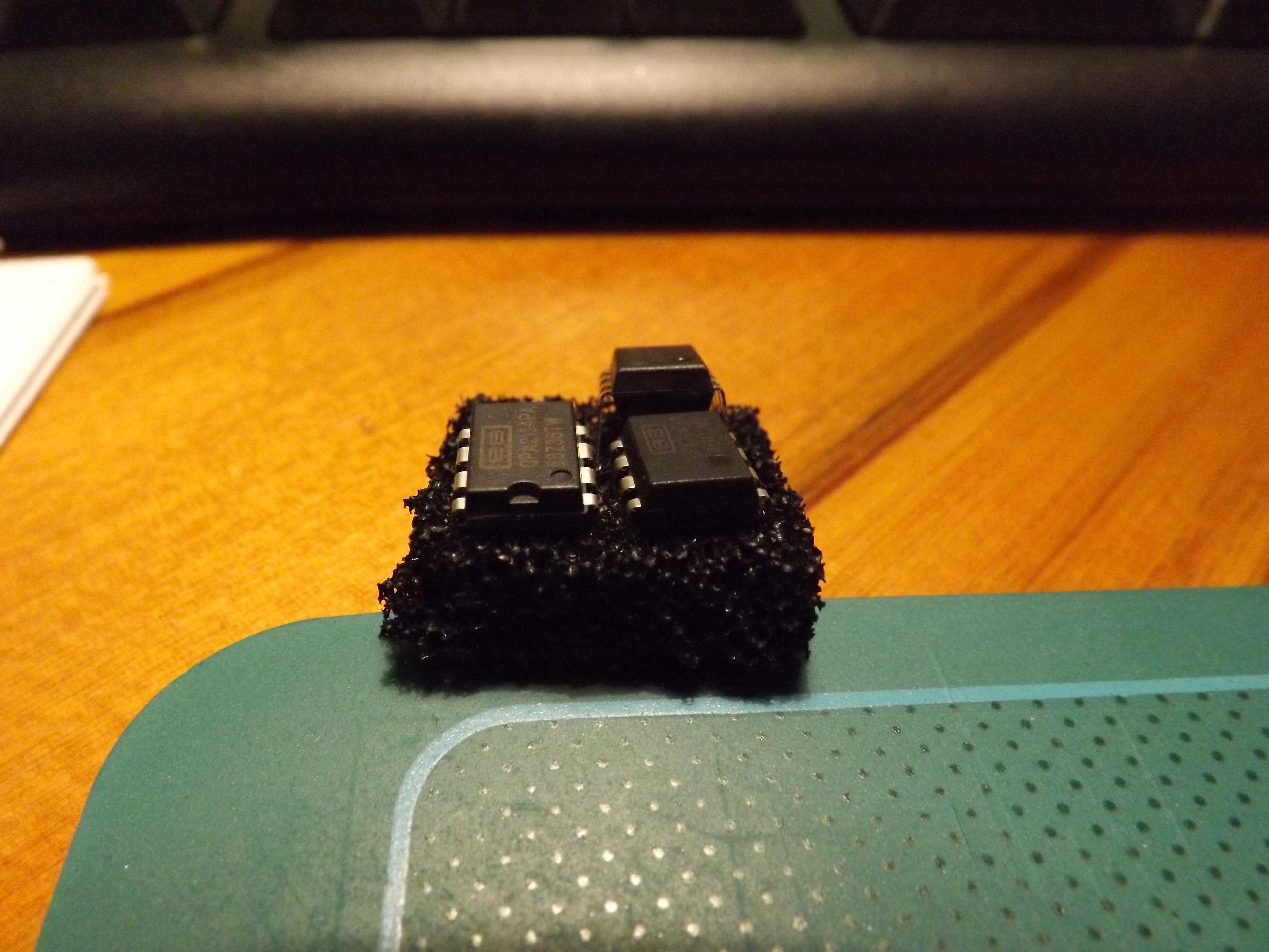

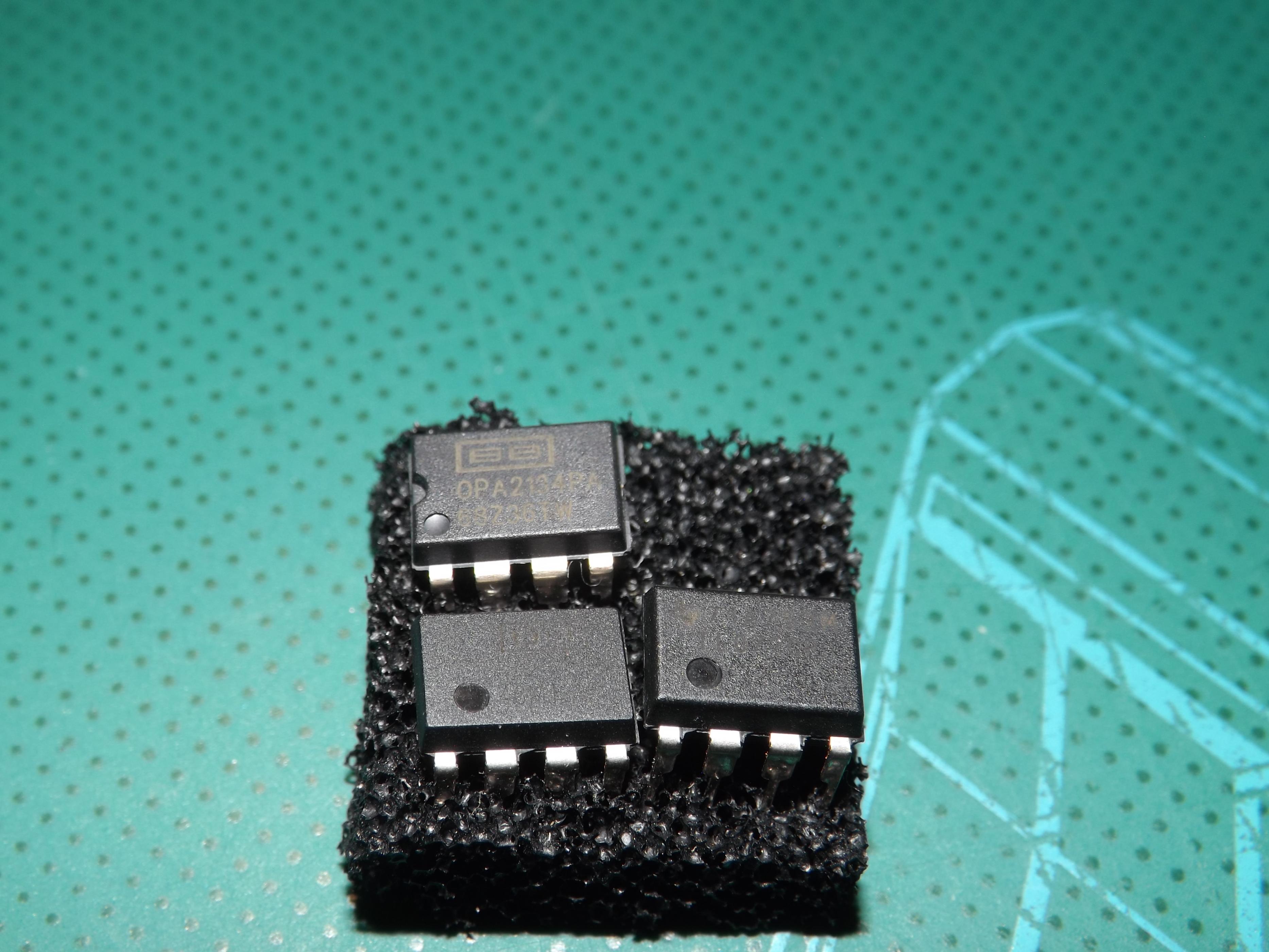

OPA2134PA counterfeit revisited
Hi, I know this thread stopped many years ago, but I hope that some fresh observations could perhaps revive it.
Firstly, the OPA2134PA is a fantastic amplifier engineering achievement that came out of the analog team at Burr Brown (now Texas Instruments - as everything else). It is widely used in high end professional audio equipment and quite rightly so.
Unfortunately, it also comes at a hefty price and so fraudsters seem to have found it another moneyspinning target.
I recently bought a few pieces of this amp from an otherwise reputable UK supplier. Only to find that the DC offset suddenly was at - or above the datasheet values. So, I had a closer look and had to realise that the new DIP's I bought looked a bit different from what they should look like.
If you look at the pics, the one to the top left is an original BB , the one to the bottom left is the new "2134" and the amp to the right / in the back is a dirt cheap old bugstandard TL072.
The first thing to notice on the "new" is the abscense of the nook between pin 1 and 8. Secondly, the print and pin1 dot mark are different. So, perhaps it simply comes from a different authorised 2134 production fab facility? I think not.
Compare the plastic mould and the lead frame points at the edge of the amps - the "new" amp mould is rounded and the visible frame pin points are more spaced apart (ok it is dificult to see on the pic) compared to tighter spacing on the original OPA2134.
But the "new" 2134 case fits the 072 build to the T - and I am willing to bet my last dirty PJ that this is a counterfeit TL072 re-marked as a OPA2134. That would also make sense of the measurements.
Take a look at ebay - you should now be able to spot these fake duds just from looking at the pictures. Unfortunately, some sellers display original pics and send you cr*p counterfeit devices anyway.
The disturbing thing is that fakes now seem to have infiltrated into the inventory of reputable suppliers as well. That's scary!
Or what?

Angel, I believe you are correct in that the chips you just got are fakes. I have 2 OPA134s purchased from DigiKey several years ago and they have the BB logo and all of the writing in white. This was not too long after I learned TI had purchased Burr-Brown and I think TI was still using the BB name. Looking at the TI web site, the current chips (OPA134, 2134, and 4134) all now have the TI logo on them in white and have the notch in the end by pin 1 but do not appear to have the dot by pin 1.
And I agree with you, the real OPA134 series are very good op-amps. Hope this helps.
Ken
