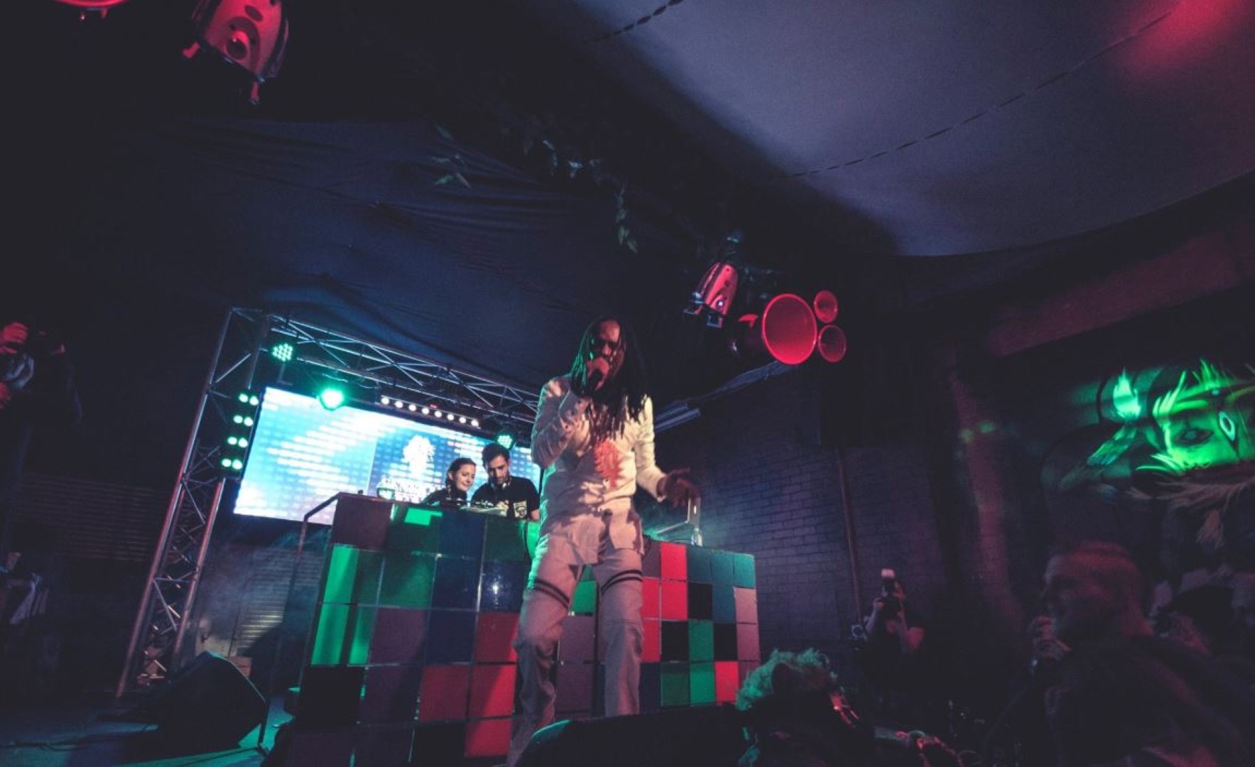

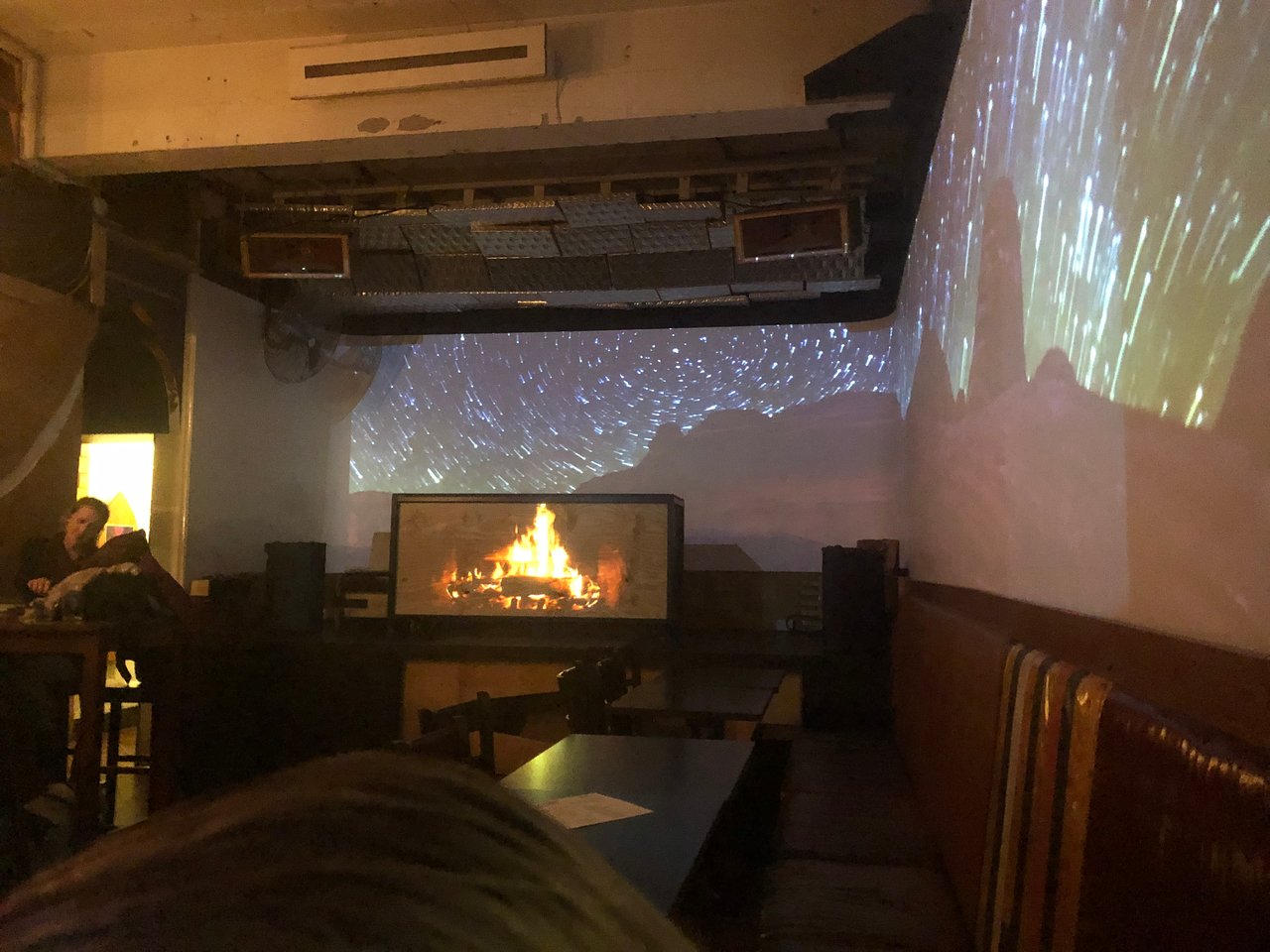

The pictures attached are a bit dodgy, but they show one system (Rubix Warehouse) that is vaguely like Avantgarde or similar horns, and two other systems (at 24 Moons and Horse Bazaar) that use synergy-style horns. All these venues are in Melbourne, Australia.
The first two are nice - loud and "clean".
The Horse Bazaar system I can't evaluate in the same way; I haven't been to that sort of event there, and I doubt they are able to play as loud for legal reasons (nearby apartments).
I've also seen Synergy clones used outdoors.
I've tried making my own Synergy clones. It is pretty easy with DSP + copying (approximately) other designs.
...so my recommendation is to to do this.
a) Clone a good DIY horn system (synergy-style or whatever) that uses well regarded pro components (for midbass and above)
b) use the biggest / best system you can for LF. Pick up vintage gear and tweak it (e.g. add DSP), or build it from scratch, doesn't matter.
