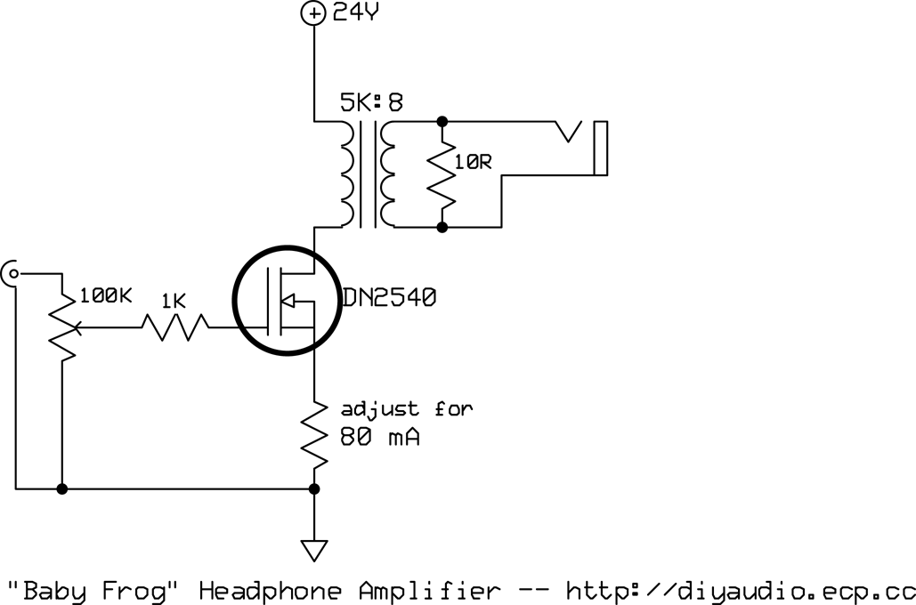

I used these to make a little Gm headphone amp with some Edcor OPTs. Works pretty well for Low Z phones, actually.
