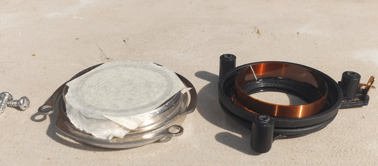

I recently bought a pair of Tectonic exciters, 32mm 30W, and have been testing and measuring them on different panel materials and shapes.
THEY BUZZ!
I am driving no more than 1W at a time, and have rolled them off at about 300Hz, 12db/oct. I'm getting mechanical buzzing on them, even when not attached to a panel, at about 370Hz and 650Hz.
Anybody else had this problem? Any suggestions?

Here's the exciter datasheet: https://www.tectonicaudiolabs.com/wp-content/uploads/2019/04/T-DS-TEAX32C30-4B_Rev-1.1.pdf
Free-air Fs is 260Hz.
Obviously, when the drivers are attached onto a panel of any description, the Fs reduces closer to the fs of the panel itself, which is generally less than 100Hz depending on the combined mass of the driver/panel/suspension compliance etc etc etc. But yet, the buzzing happens at the same frequencies approx 370Hz & 650. And these two frequencies are not harmonically related (rationally) so I suspect there are TWO mechanical issues here.
I'm using various active cross-overs and concert-quality amps that you could probably weld with if you were in a tight spot... Damping factor on these amps (at the output terminals, excluding speakers and cables) is usually in the thousands or tens-of thousands, which translates to milli-ohm output impedances (not to be confused with load impedance)
It appears that nobody else on this forum has experienced or addressed this problem, so today I'll be taking the drivers apart to see if the rubber seals have maybe come unglued somewhere. The metal spiders seem to be OK since they are screwed into their mounts.

Right... update.
The voice coil assembly on the right has a soft rubber shroud around it, apparently to keep rubbish out of the pole gap.
That shroud fits around the magnet assembly. It fits loosely. It is not glued down. And it dances around like a hoola girl on hot coals. I tried gluing it down, but the problem although ameliorated slightly, was still there. I eventually just cut it off with a scalpel, reassembled the whole lot, and the problem has disappeared.
Next step: Get better quality exciters.
