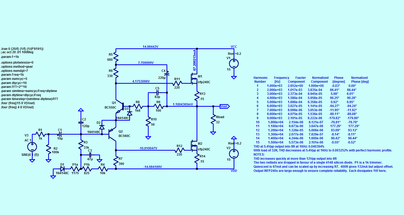

Should be enough to protect against accidental > ~20V input.
indra1,
You mean >2.0V input, right?

Another could be two diodes, 1N4001, reversed biased across base/emitter on Q1 and Q2, and a simple 15V zeners katod at gate down to source on both outputs. I should have suggested them at the time, my mistake.......

No, I mean > 20V (more than twenty volts) for a short period, depends on heatsink capacity. But I leave the burden of testing on live circuits to Diego, along with sound quality assessment. My ears are no longer as good as they were.You mean >2.0V input, right?

Somehow the God of Luck smile on you. A simpler solution was found. I tested a 1k8 resistor at the base of the NPN (R12 in attached schematic) helps to contain the cross conduction issue. Should be enough to protect against accidental > ~20V input. LtSpice asc included.
You should test effectiveness and impact on sonic performance.

Hugh, could you sketch or show on the schematic Indra1 attached, what you propose in post #562. I am a novice and I need to see things rather than just read them at the present moment. I have some of the pcb's that Prasi introduced, and would like to see how difficult it might be to incorporate the proposed solutions developed by Indra 1 and yourself.

I had a lash at it this evening; this is my take on Indra's and my own ideas.
I have not checked stability but I believe it should be fine.
It is a better HPA than power amp; the Rush Cascode is not ideal for wide headroom. But it's very fast, and intrinsically high gain.
