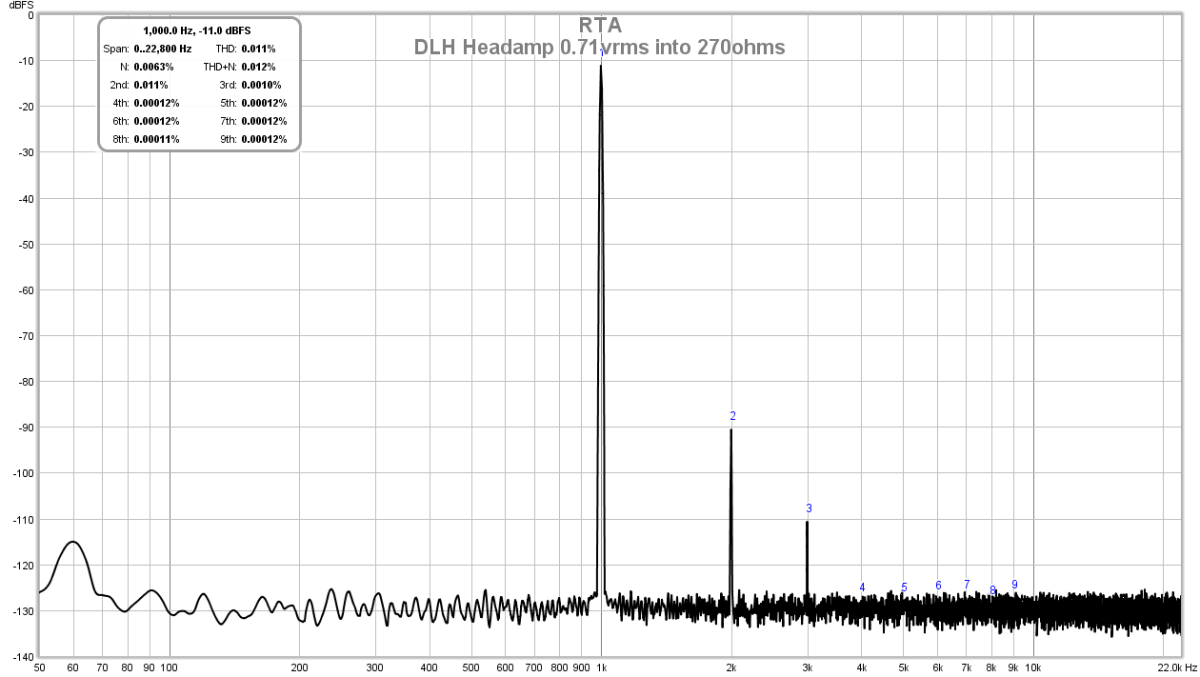

Here is my DLH headphone amp performance, driving 0.71vrms into 270ohms:
Still a nice performer.
It's difficult to argue that H2 at -80dB, H3 -100d, and H4 and beyond below -115dB is not a good result.
It SHOULD sound very good.
But then, we have to consider the noise, big issue with cans, and slam for bass. Last, how are the spatial qualities; can you locate all the instruments left to right front to back in the orchestra, and does the solo instrument soar over the riffraff behind it?

Thanks Hugh. It sounds quite nice, spatialization and soundstage. I need to work on adjusting those source resistors to give it more slam. It is a bit reserved and polite at this point but I think the issues are all fixable with some tweaking. Certainly there is a lot of promise here for such a compact headphone amp.

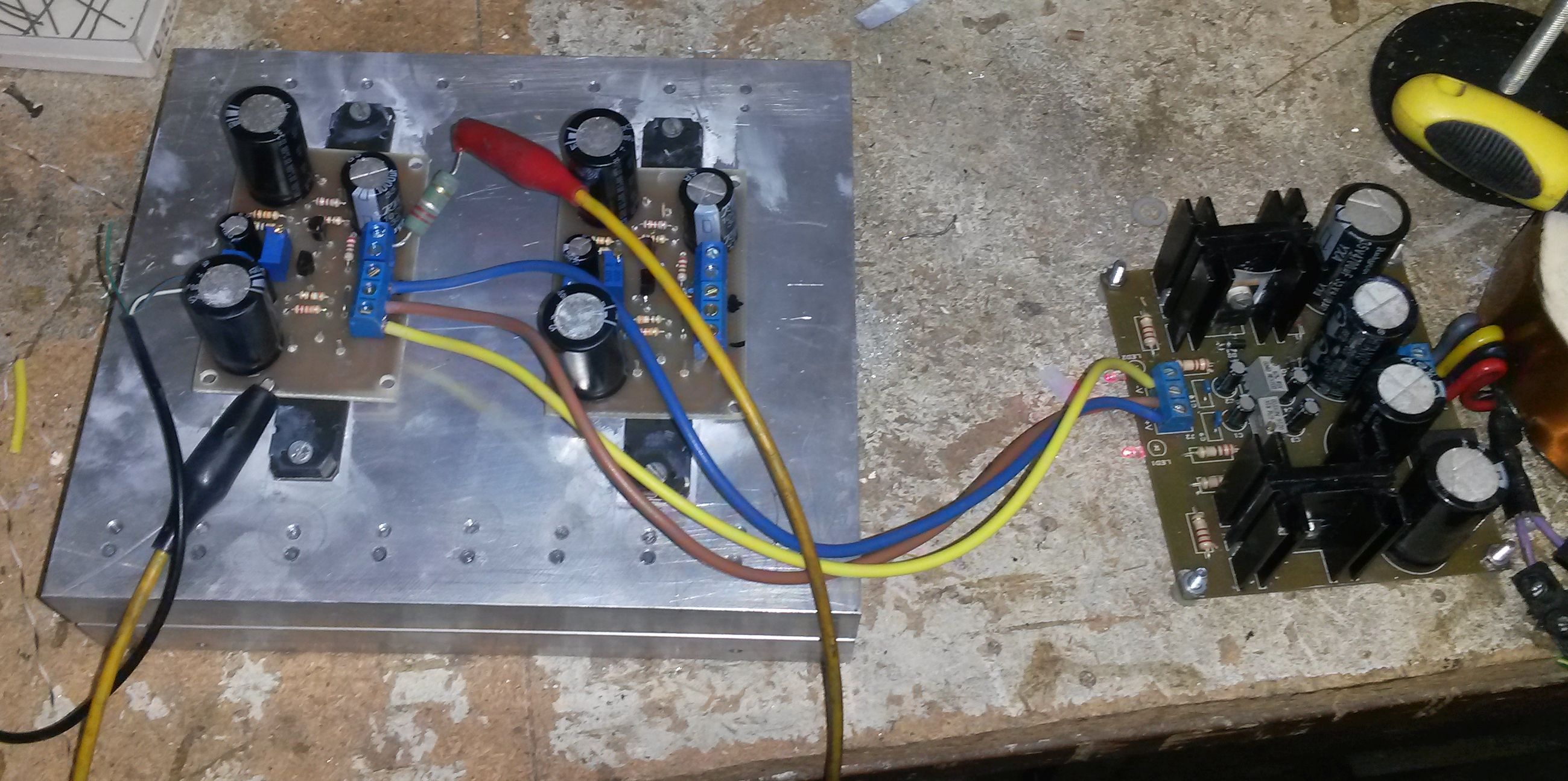

for those who are interested I have also now completed a prototype of the DLH. Yes it is extremely simple. Has only a few components, was made relatively small and performs okay.
Unfortunately it is very unstable. The off-set runs all over the place and the amp will need some work using an auto off-set adjust if it was to be used in your installation.
Because I am also a fanatic head-fier I used it last night after completion as a head phone amp. It was a little ridiculous running it at 1.3 Amp bias driving a pair of HD 800s, but I tried it because XRK's suggesting this and also to satisfy my own curiosity.
I was met with serious listeners fatigue after an hour or so, and felt very tired of music, although I can listen to my two-transistor SE for days without removing my phones. In fact I feel undressed without them.
I must admit, the amp does not sound bad at first listen, maybe even impressive but as time goes on it just didn't do it for me. It may be perfectly suitable for another's taste. I listen to mostly Jazz, popular classics, 60's 70's and a little early eighties rock and blues.

Nice build! I never listened to the full size DLH as headphone amp for too long - mostly for debugging noise and hum and then maybe tracks. I was too fearful of the possible massive DC rail flop that would kill my cans.
I wonder if you may be experiencing some oscillations (inaudible) but they cause fatigue? This amp is very high bandwidth and needs RF filter on input, and RF filter on output to prevent RF pick up from cans coming back to the amp. Did you look at FFT or oscope output?
I notice you only have 4 actives and 2 BJT's - if you build the version with the 4 BJT's the drift would be a lot less. Otherwise, you can cap couple the output and not worry about DC drift with two.
