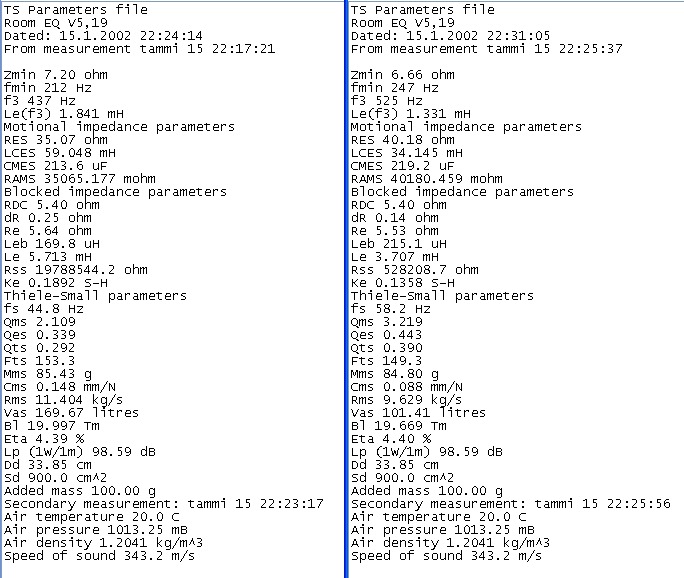

Yes, dont worry. It just needs some punishment and real world duty to settle down to the manufacturer specs (break in). Dont except it to happen in one hour. Been there, here is one example. Some parameters are depending on how you measure. manufacturer may have different procedures.
Left: old well used driver. Right: almost brand new. RCF L15P540. So yes, those parameters will shift a lot in some woofers.
