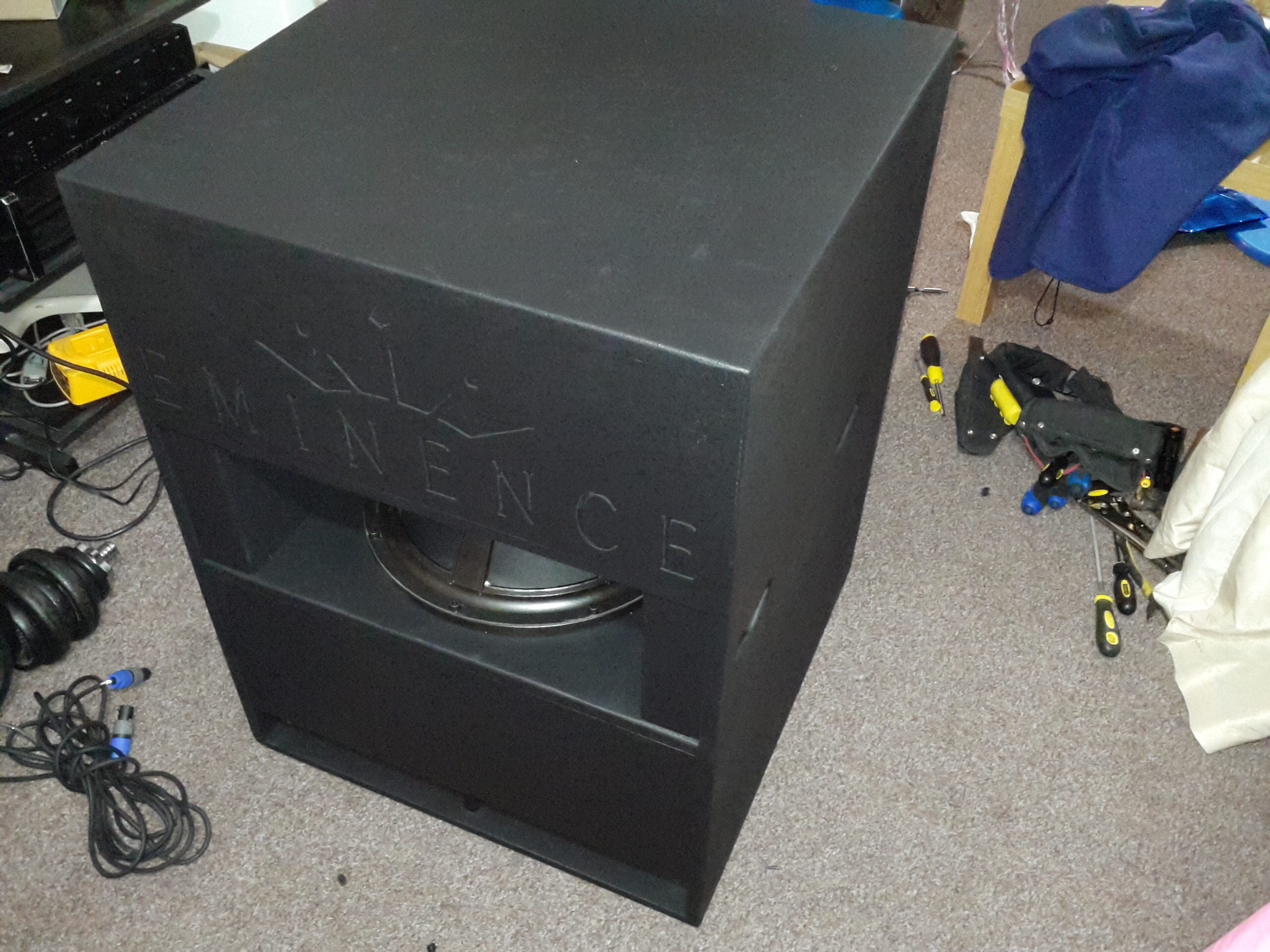

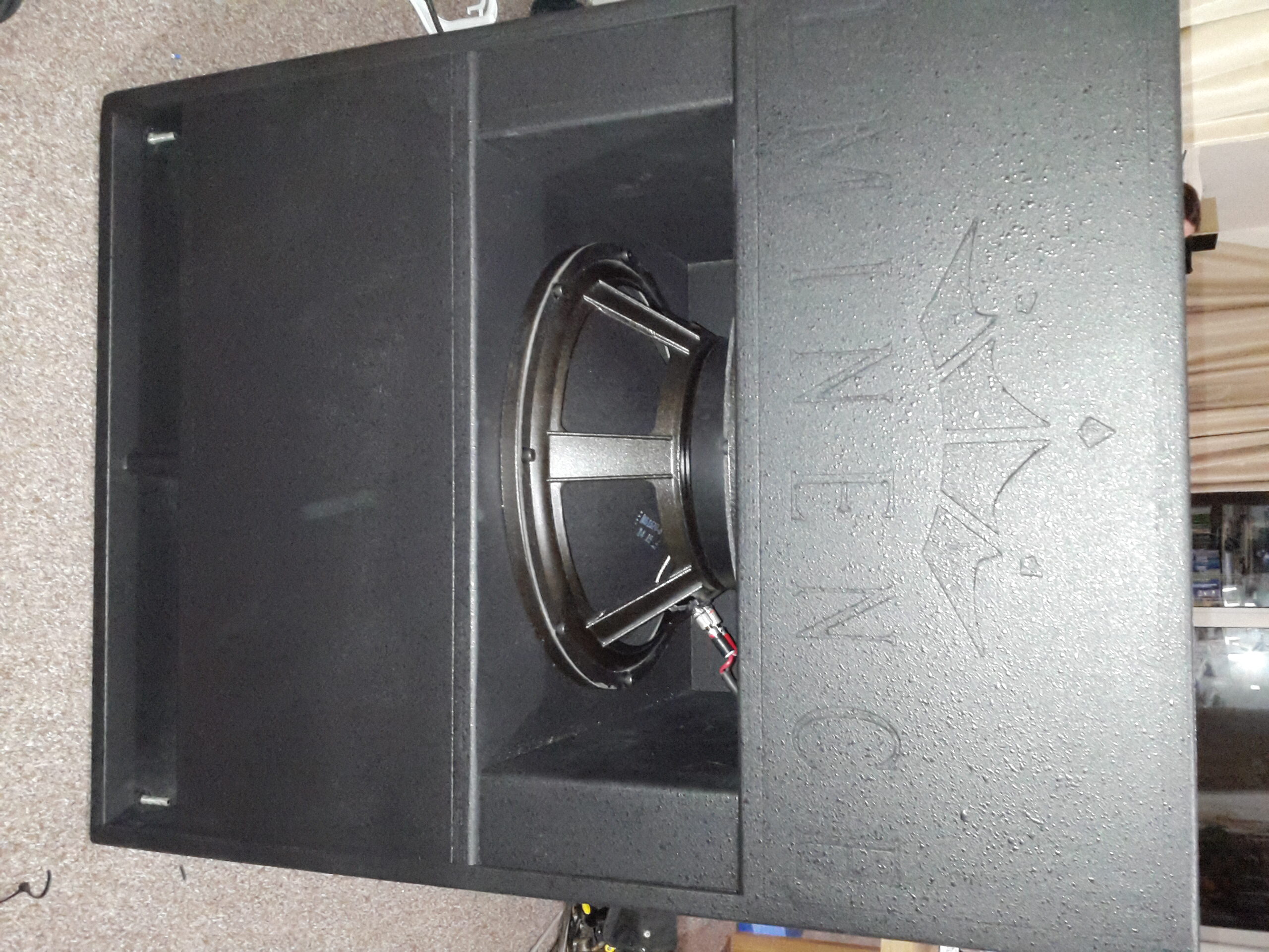

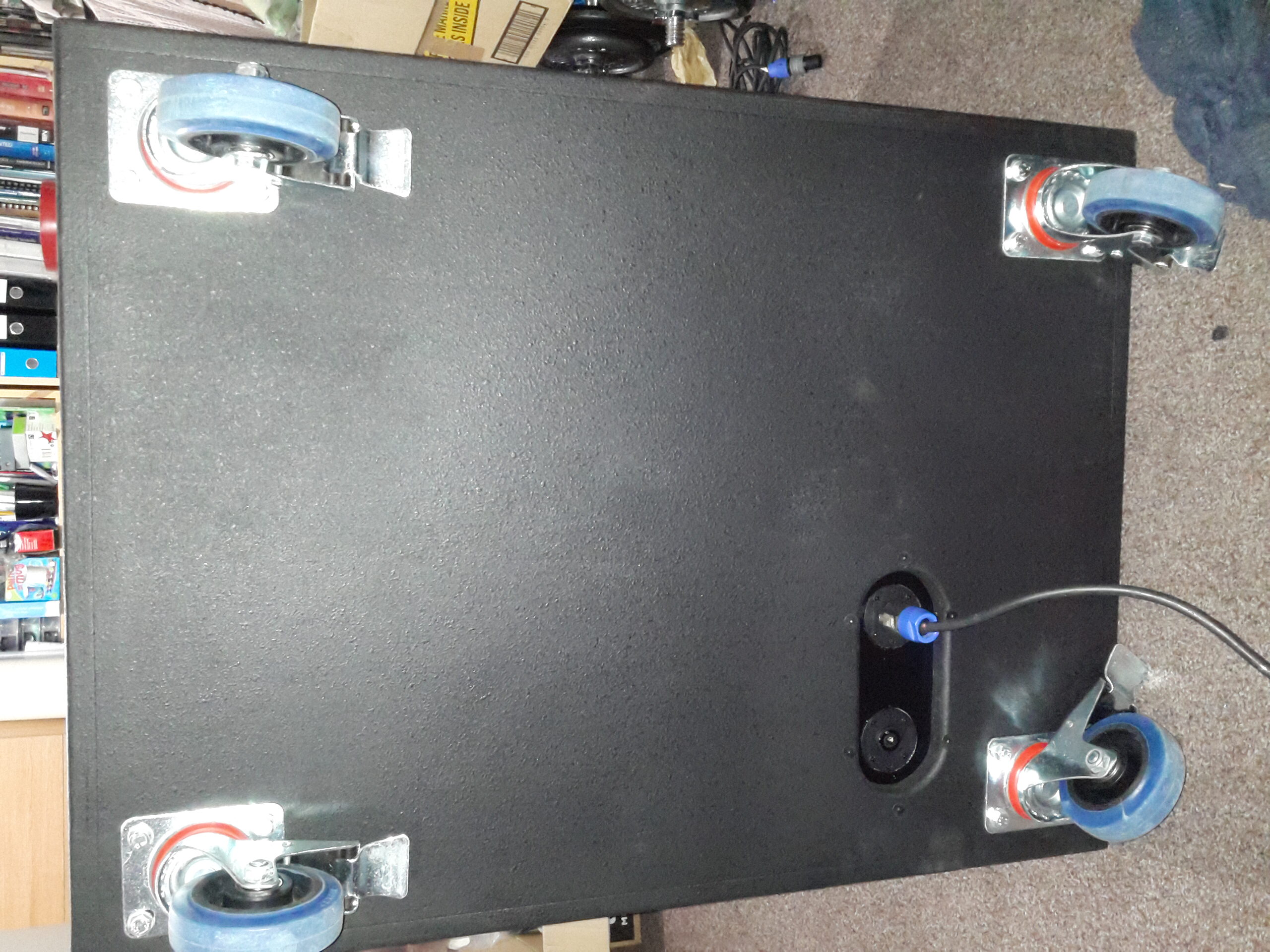

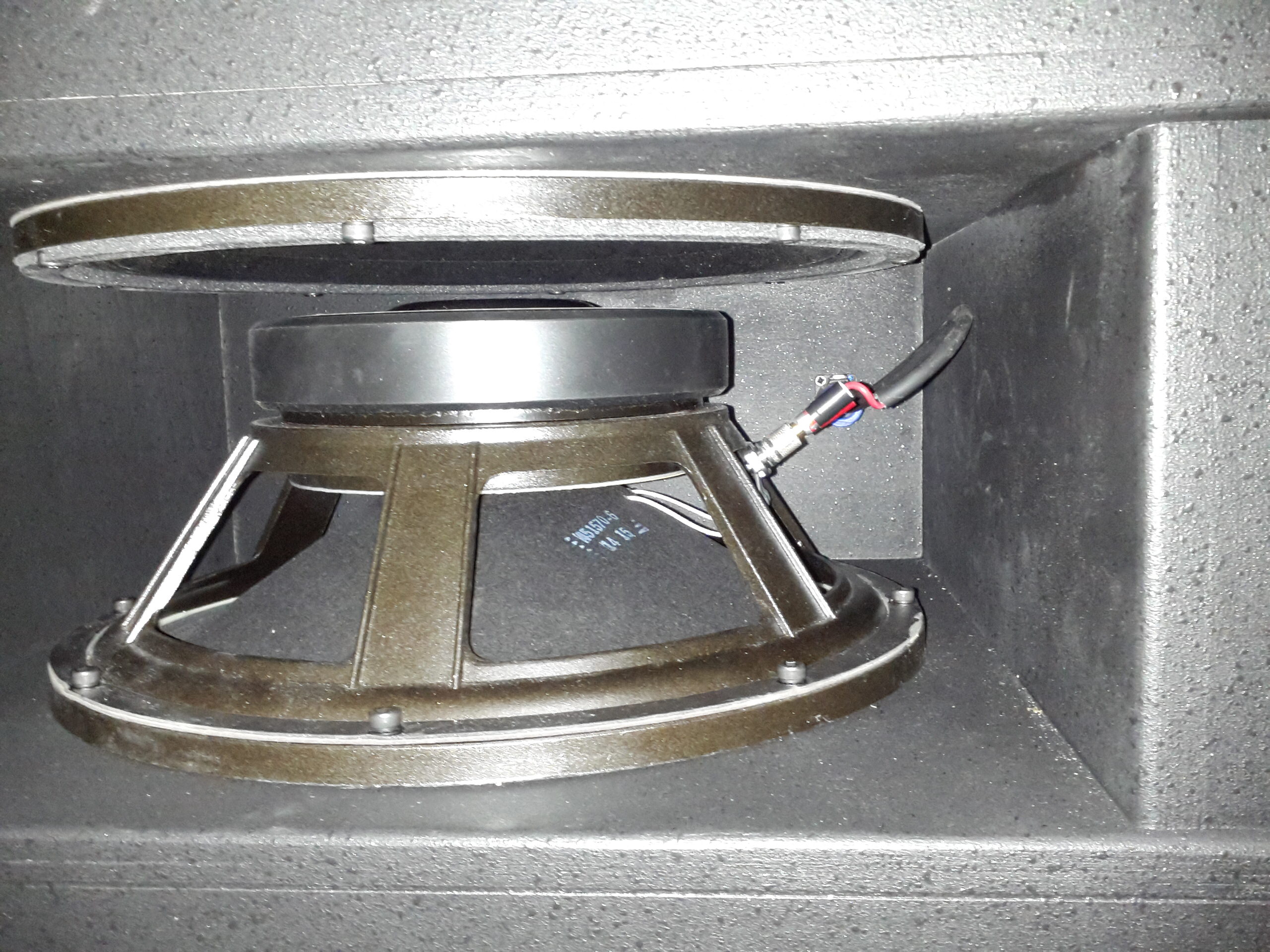

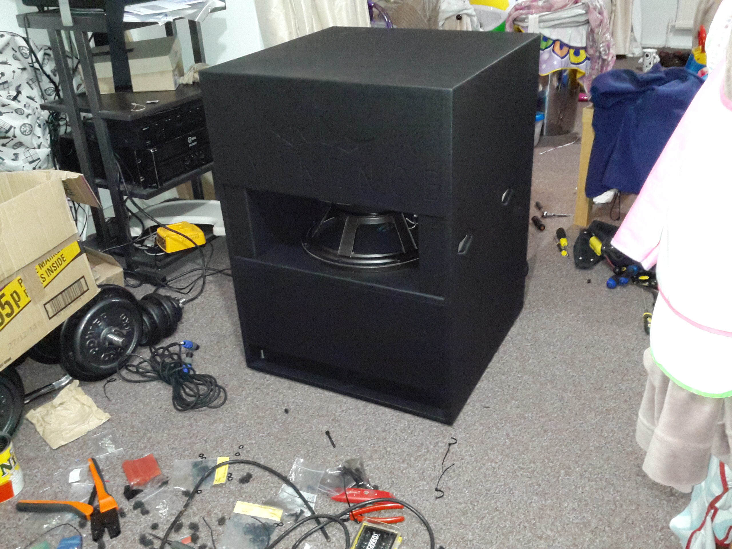

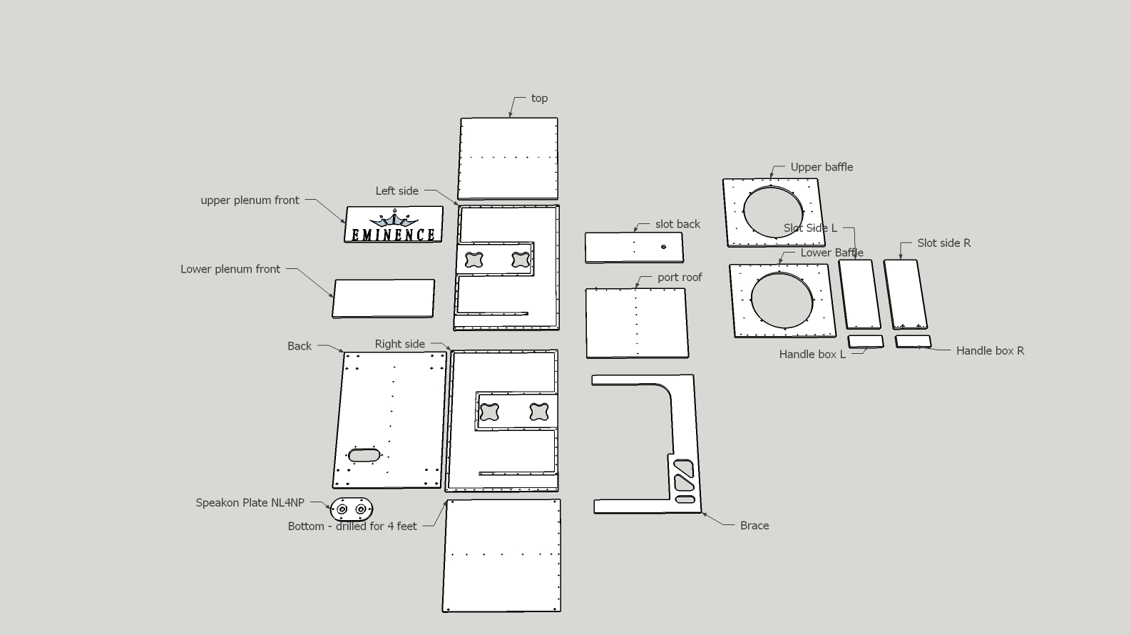

Bump, finally finished it.
Sprayed in warnex - which was a learning curve. For those in the UK I used a 3hp compressor, a machine mart pressurised paint pot and Clarke pro 18c gun. I wasted a load of paint by not having enough air flow to do the base coat meaning it spattered first. Got there eventually. Think I'd use tuff cab in the future though.
Tried to do a good job, all mounting hardware is chemically black steel, shake proofs used. An nl2 socket is in the slot to connect the slot driver, all spades are locking type and soldered. Socket plate was sprayed in gloss, I will make a spec plate for it some time.
Massive respect to those who have built complete systems this was a mission for one sub and one mid high I built at the same time.

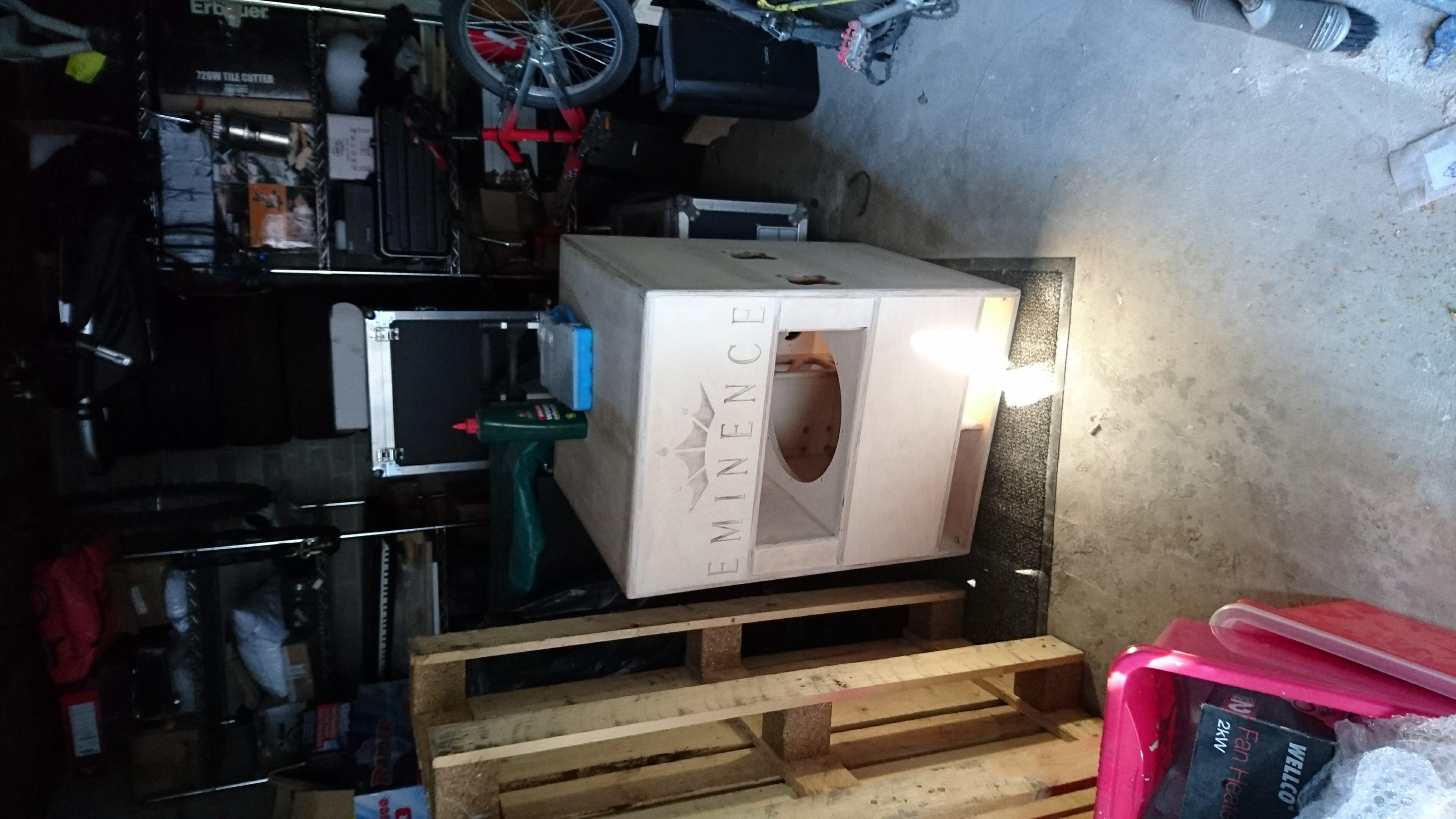

Cab number 2 in production. Taught myself some CAD and put a lot more work into the drawings to make the CNC router do more work. Rebated the side panels, new handle design to help loading, and more intricate main brace.
One was good but 2 has to be better!
All built, warnex is in, when the back is better it will get painted. I don't like the look of corners but I might have to add them. I'll keep with my macro tech 2402 but in parallel mono.
