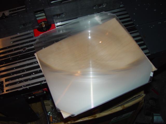

i am about to split alans 12.2 fresnel right now
the largest area it will alow the lcd to display is 11 7/8 "
the fresnels are plastic

i will post some pics of the spliting prosess in about 20 minutes
the whole thing only takes like 2 minutes but im waiting for my buddy to stop by its his fresnel

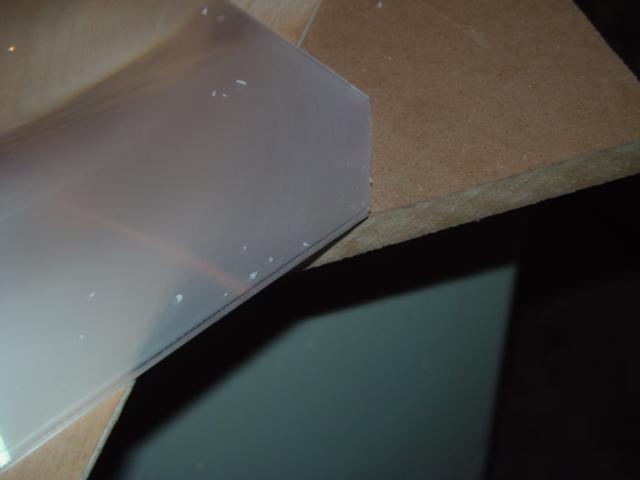

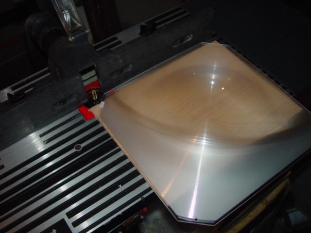

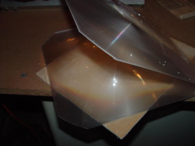

I split the 12.2 fresnel with a dremel and a cutting wheel. Cut off most of the excess platic around the edge and then dremeled any area that was not completely split. Took me about 20 minutes. May not be the straightest or easiest, but got the job done.
