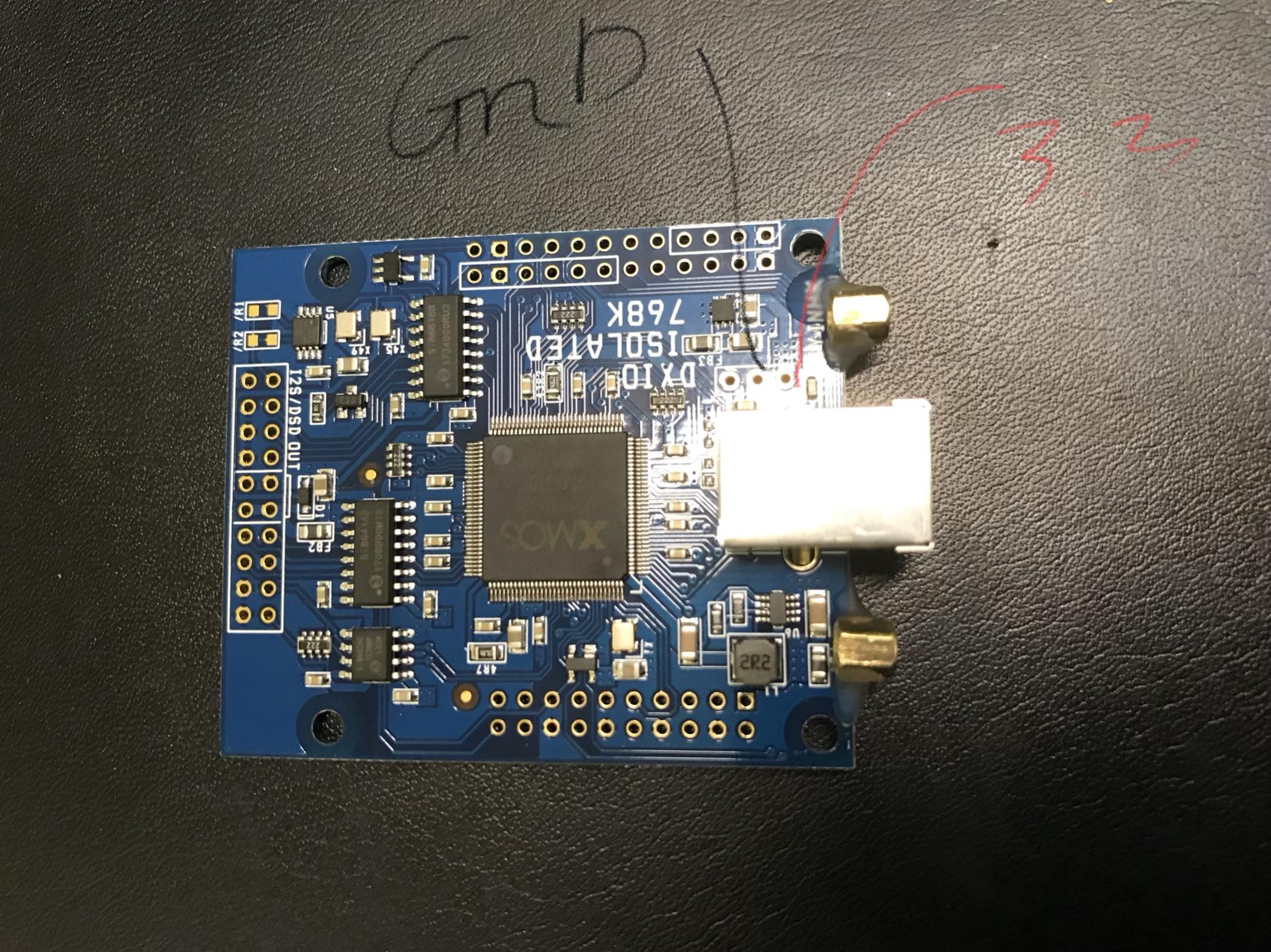

Hello!
I have this board but the Isolated version, and I am confused. The description is saying that it only need 3.3V by X2 and Ground on the 20 Pins output with >100mA. But then I put in 3.3V with 200mA, and I only have noises with some music ?
Customer support says the module need another external supply on the un-clean side, or computer side ? Then where do I supply the power to ? And what is the current draw for this ? Please help. Thank you

Hi Whitigir,
You could try contacting the diyaudio member DimDim ... IIRC he has the same or a similar board.

I'm afraid that I don't have this board, I have the multichannel one, and it's very different.
Looking at this one's documentation, I see hints that the "dirty" side is powered by the USB port so no external power is needed. The "clean" side does need power though, otherwise the board won't power on.
So it should work with external power applied just to the "clean" side.
If you're only hearing noise and some music, double check your I2S wiring. You might have swapped one of the cables.

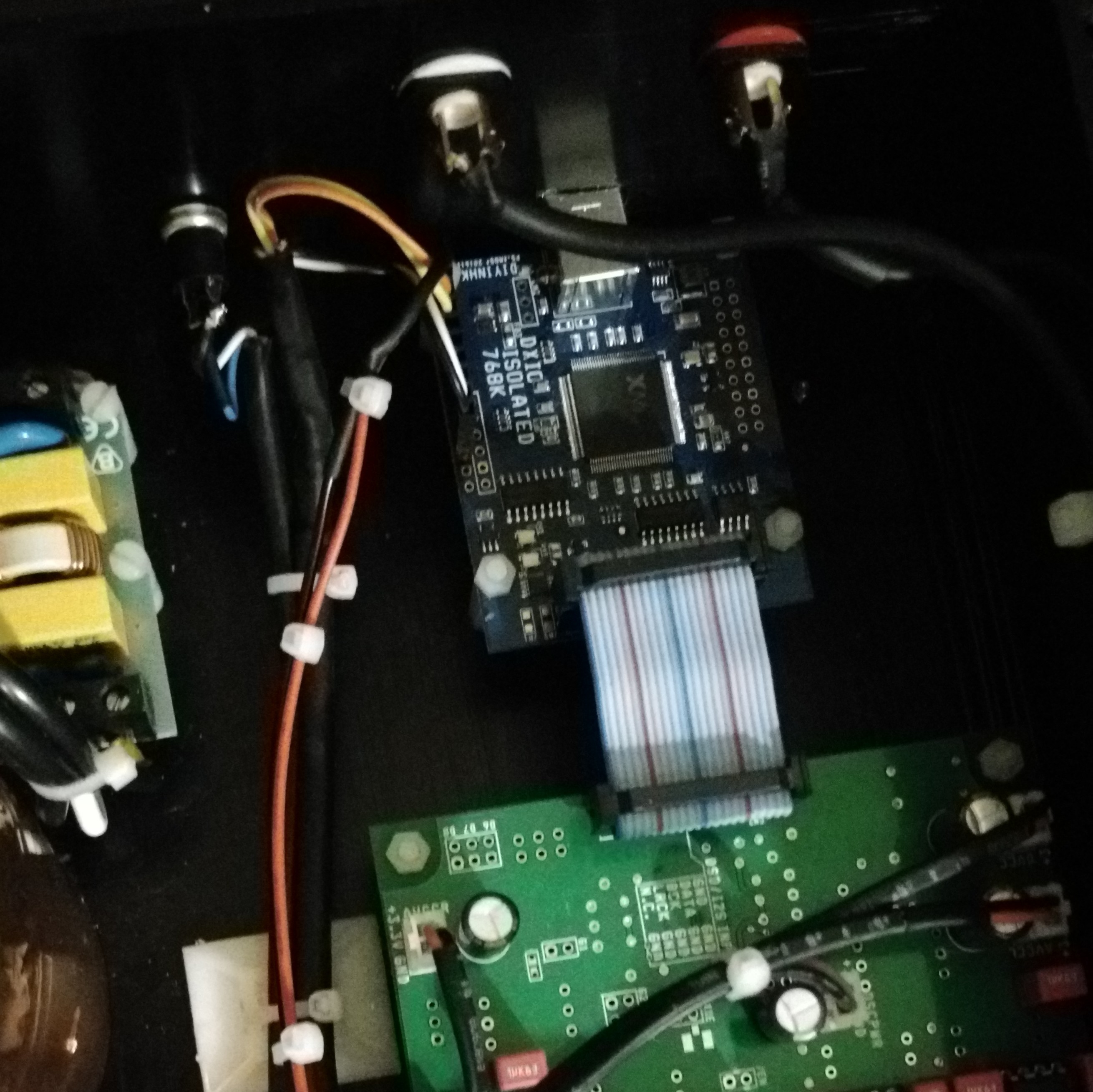

Is this the correct pins out for the PS into the computer side ? How much current will it draw ?
3.3v you bring it back to the first 2 pin or there is the connection of the screen Oled, but normally on the side of the Xmos without display the power of the USB is enough! But if your no display you only need to supply 3.3v the side dac side to feed the insulator, no need to feed Xmos side its alone by the usb. 200ma it must not be enough for me it takes at least 500ma at least, I measured but I remember more! This version requires a lot of current ...
