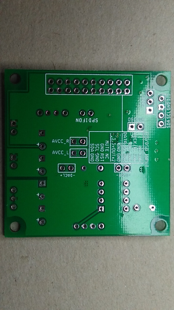

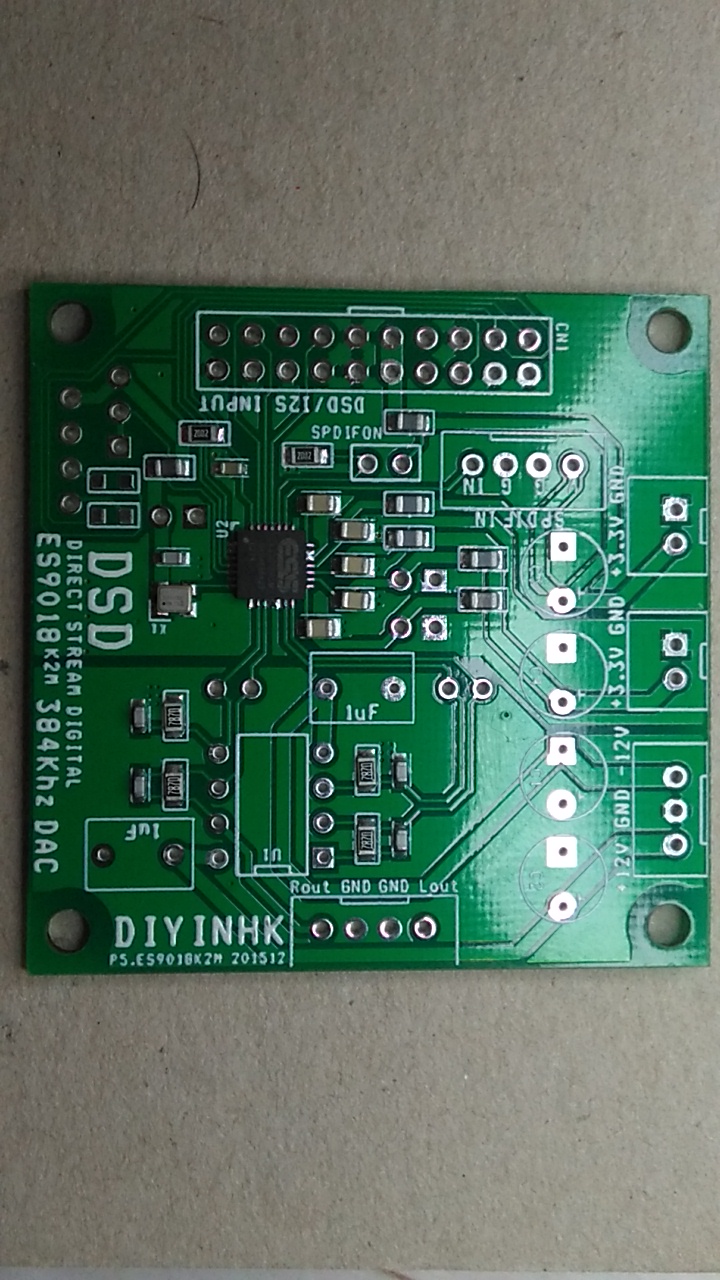

I need to know exactly all pinout of my dac pcb becouse i need to connect it by i2s with my old philips cd transport and with usb/i2s converter.
And i need to know were to connect power supply and were to connect to withdraw the current output to be sent to my i / v converter.
Here is my converter:

You need a SPDIF -> TTL converter. Check the bottom of this page, there is a circuit you can use: S/PDIF Digital to Analogue Converter
Parts are of decent quality. The layout is probably worth a miss though. The mixed-mode board is one of the worst ways to route digital signals, and the power supply routing leaves a lot to be desired.
Hi i have tried this converter (coax to TTL) and the output level is reduced from about 3vdc to about 0,5vdc once connected to the dac board. When I remove only the connection to input of SPDIF input on dac board the output of the converter gives back the 3vdc....

Fab, coax consumer spdif should be at 0.6V, TTL level is 3.3V. A coax to TTL adapter should actually amplify the signal from 0.6 to 3.3V. If your coax is putting out 3.3V then it should work directly with the dac.
I have used a twisted pear optical board for optical spdif input to a diyinhk k2m board and it works fine. The spdif input pads were the opposite way to what I thought they would be in that the square pad is ground and the other pad is signal also if you don't use a microcontroller you will need to jumper or switch the spdif selection pads to force spdif input.

Hi
I received the no isolated combo kit yesterday.
I have made some test and i don't understand the DAC behavior, may be you can help me.
I did not allready received the supply for output stage, so i have made a test supplying 3,3V digital and 3,3V analog only, and i take the output on the differential output.
I have a single ended test amp, so have took DACL+ / ground for left channel, DACR+ / Ground for right channel.
I have sound, but ...
The DAC is working with the digital 3V3 supply only.
When i plug the 3V3 analog supply, i have a strong DC offset to the amp.
With the 3,3V digital supply only, i have mesured 1,8V DC on the analog supply input.
I am doing something wrong ?
What can be the problem ?

There isn't a problem you are just not using the board as it was designed.
You will need to use both of the 3.3V supplies for the DAC to work properly you can always wire them to the same 3.3V supply for initial testing.
If you don't use the opamp based output stage you will need to use something else instead.
If you use the raw differential output there will be DC offset of half the AVCC voltage, you can use a passive I/V or just a capacitor to block the DC for testing. Have a look at the audiodesign guide page I linked you to before that has some information that might help you understand.
