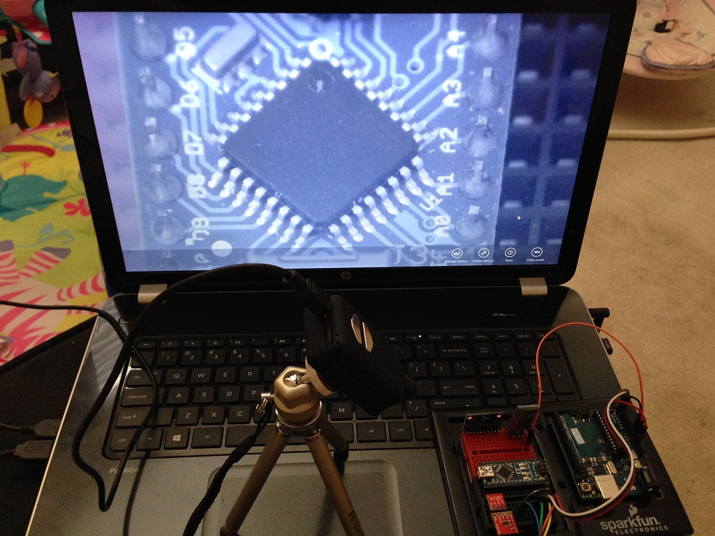

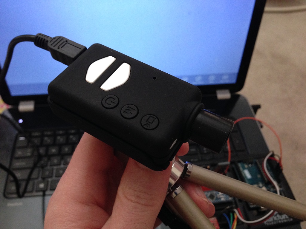

I bought the lens from diyinhk, it arrived in yesterdays mail. I hoped that in the custom Microsoft Lifecam housing, there would be threads that would allow me to unscrew the lens and use it with a different camera.... there were. The lens that diyinhk sells has a 12x.5mm pitch, which is the same thread pitch the Mobius 1080P ActionCam has. I like the Mobius because it's easy to find, is much easier to mount, has lots of software support, can be viewed on tablets, etc.
Mobius ActionCam
All I had to do to install the lens was take 2 screws out of the Mobius, loosen a small set screw on the metal lens holder inside and unscrew the stock lens. I then screwed the diyinhk lens into the same lens / sensor holder and carved a little plastic away from the bezel so that the outer casing would go back together.
It work's great! Here are the results:
