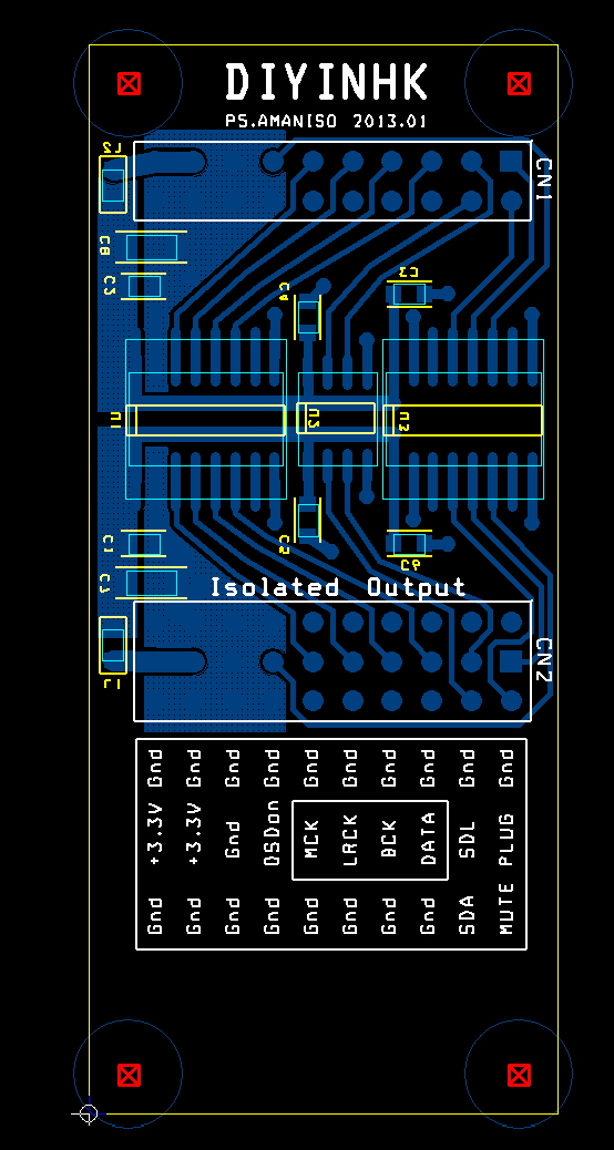

I have the isolator in hand and would like to know the orientation of the texas isolator before soldering.
I only using it as isolator between the amanero combo converter and the BII dac
Please see the attached
1)Is the isolator orientation correct ?
2) The arrows point to the isolated BC ( bit clock )output?
3) The corresponding pin on the left side of the image corresspond to the BC input ?
4) Where to apply the dc voltage in ?
thanks

the bar on the board pattern for the parts (indicated on the pic on first post of this thread) indicates the side that will be pin 1 and 16, as is the standard. pin 1 is indicated by the dot on the isolator

This is my build of the board with iso7240 from texas.
I test it just now.
The input of the isolator has 3.3V supply from the amanero board . It measure about 3.2 on the isolator board. The output of the isolator has a 4.8V power from another source. The amanero usb i2s board is powered from the usb input itself.
There is sound but music is very soft with very prominent background hiss that correspond to the volume pot.
what are the likely problems ?
I appreciate input from more able diyers .
