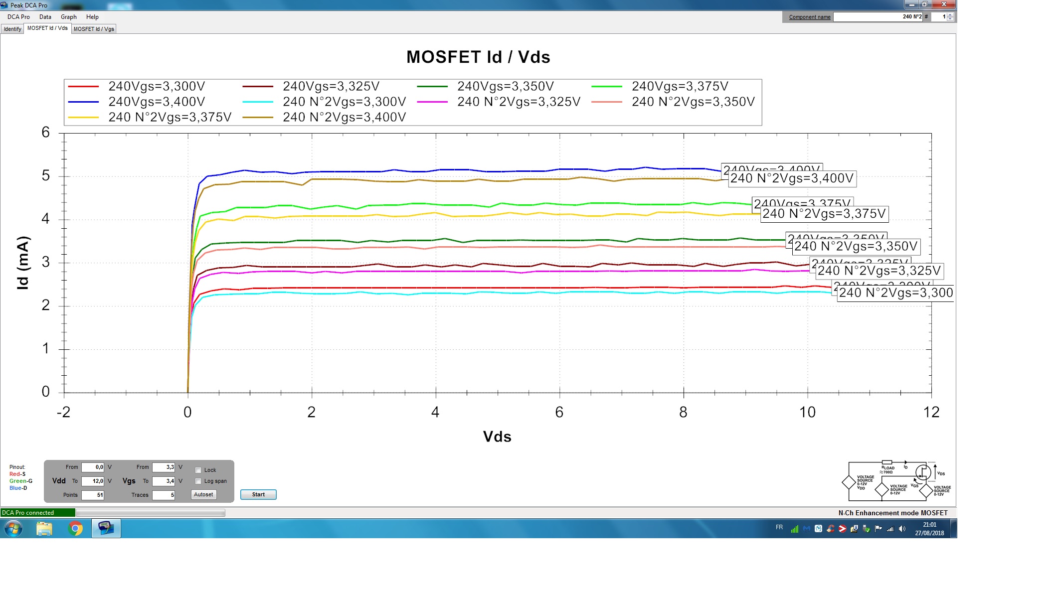

Here are the curves of the transistors bought on the store, what did you think of pairings? The measurements were made with the peak atlas dca75 pro.
Thank you

They are meaningless at that current compared to normal use.
You need to build a tester that works at least at 1 amp.

IMHO you can do fine at 100 mA.
Ok thank you, for your answer. I thought that the paired transistors on the diy audio store was close because normally when have the pair have the fact on all the curves and not only on some points of polarization so has any current of test should have a similarity of the transistor already paired
Matching at the intended operating voltage and current is ideal, but
generally requires heat sinking and more time. At a lower level
(like 100 mA) you can still get a pretty good number without much
thermal drift.

OK ,
thank you Nelson I understand you I thank you

It depends if the relationship between turn on voltage and pass current is linear across the working current range for each transistor.
If it is then you can get away with a lower current.
If not then the transistors could become misloaded at different currents to the test current.
As the current gets higher it takes a higher voltage to push out the extra current.
I have seen lateral mosfet amps that use this voltage to be limited by a Zener to limit max current.
I have a semiconductor analyser which works at a few mA and its readings usually come out way to high. I am getting massive gain readings for transistors as against the datasheet.
To avoid the thermal drift problem I developed a method to match IRFP240s by mounting them to a temp regulated aluminum plate and using high current pulses. I then convert the resulting output voltage to a VGS reading. Doing some basic statistical analysis on this method it had very good precision comparable to using a constant high current and heatsink mounting the part. It is much faster though.
