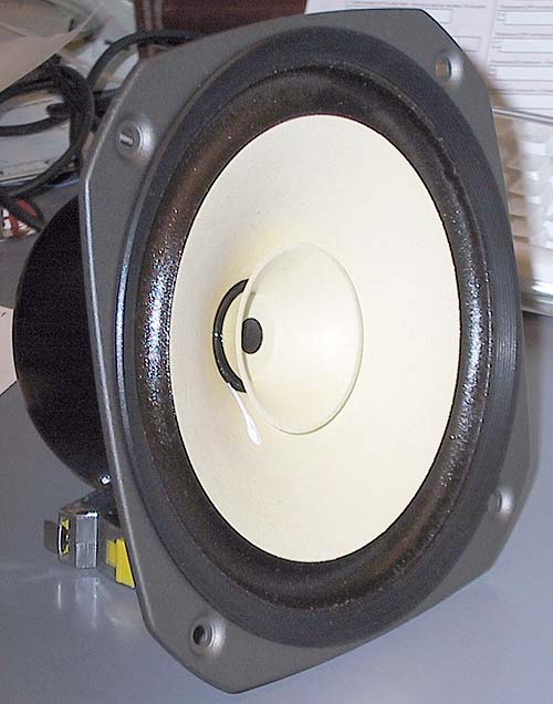

Variac said:
I don't keep up w/ all the Fostex, but is the FE127E good?
I haven't heard that one, but my buddy Chris was quite impressed (at VSAC) by the Pi Speakers bipole that uses a pr of these.
Personally i don't think you could much go wrong with almost any of the Fostex drivers. We've had some of the woofers thru here & they were very good, and i finally laid eyes on some 167s, pictures don't do them justice.
dave
