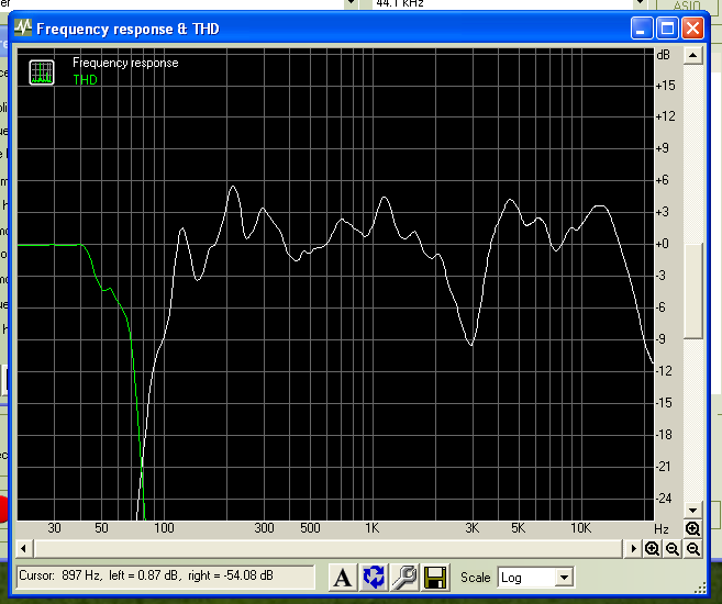

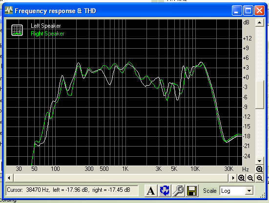

I recently bought a microphone (a Behringer B1 condenser, which I believe to be reasonably flat) so thought I'd measure my speakers.
The overall level for the tweeter and woofer are reasonably well matched, but there's a sizeable (>6dB) hole at the crossover frequency. I can swap the polarity of the tweeter, I suppose, but that'll just mean there's a peak there rather than a null. What's the usual method to clean this up? I suppose I could increase the crossover frequency for the tweeter a little...

First, I have to ask what it sounds like?
You can create an overlap of the woofer and tweeter by increasing the cap size and decreasing the inductor. Try increasing the cap by 1.5-3.3uF as this will drop the xo point of the tweeter which will overlap the woofer. You can also remove some turns from the inductor to reduce it's value by up to 15%. The question remains will it sound as good which is the main criteria.
I've become quite wary on mic measurements as has led me astray in the past by making a flatter response but killed the speaker sonics. Final tuning here is now done strictly by ear.
What location do you have the mic... in line with the tweeter and 1m away?
They sound pretty good. But then they sounded pretty good with the tweeters out of phase and the hole in the frequency response, as well. With the tweeters in phase, the treble still isn't flat. There's a broad region from 2-6KHz where they're down 3-4dB.
Actually, if I look at the published frequency response plots of the microphone I measured them with, the high region from 6-15KHz is likely the microphone, not the speakers.
I'm toying with reducing the series resistor on the tweeter, to bring the level up a couple of dB to compensate. Maybe I should get a properly flat microphone before I go nuts with the measuring.
Oh, and the measurement was done with the mic about a meter from the tweeters, with the speakers in their usual position on my desk.
