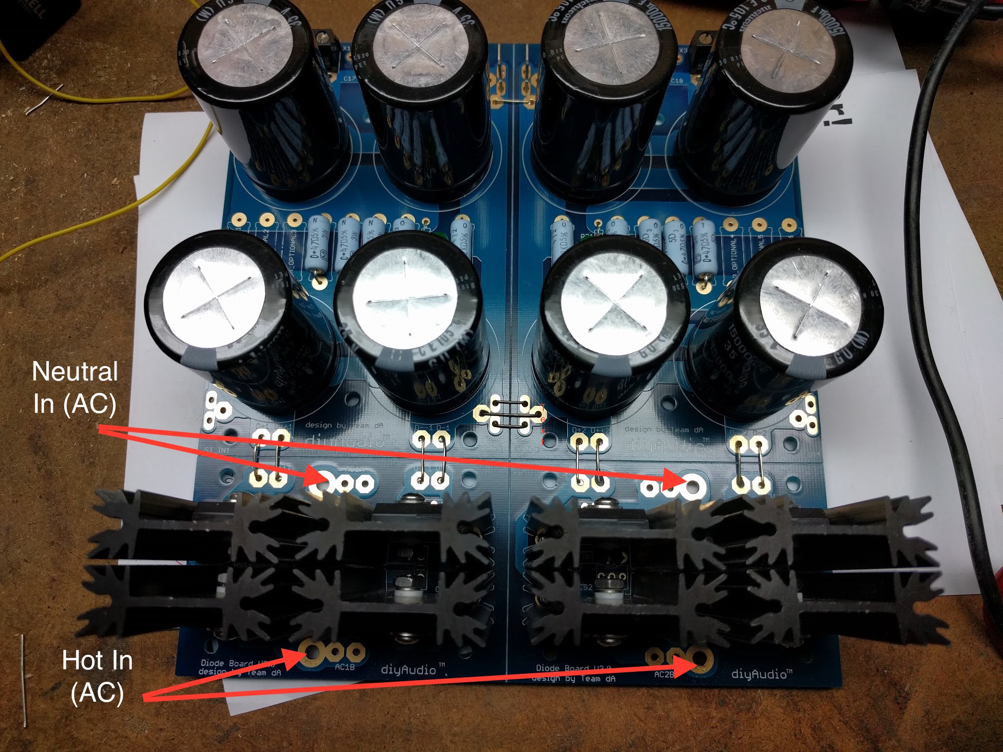

Correct wiring for rectifier bridge for PSU v3 board?
I have read and re-read this (entire) forum, but cannot definitively tell exactly how to connect the 18V AC leads from my transformer to the PSUv3 board using the diode rectifier bridge. I've posted a photo of my current build below -- and indicted what I *think* I understand about how this should be connected to the 18V AC input. I know this is a trivial question and one I should be able to figure out (or infer) but I simply don't feel confident that I'm understanding this correctly. Thank you in advance!
Reactions: Jezza56
You have 70,000uF 50V caps that fit that PCB??
You'll need a bigger mains fuse.
Nothing else really changes in the PSU... other than your inrush current on power-up will be immense.
You may seriously want to consider using 4 of the caps. It's still much bigger than stock.
