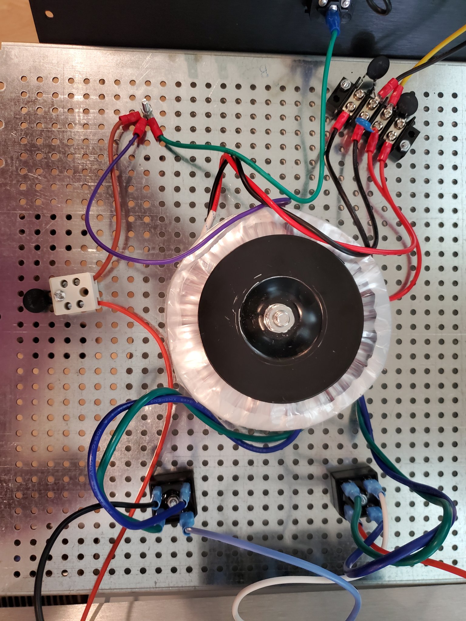

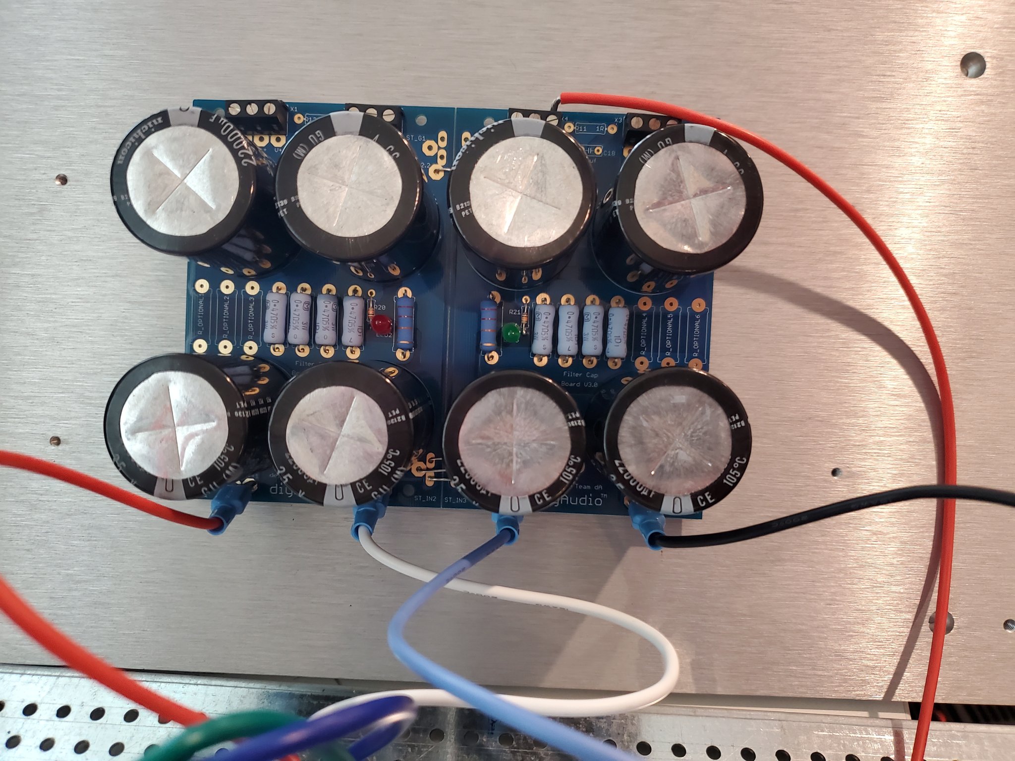

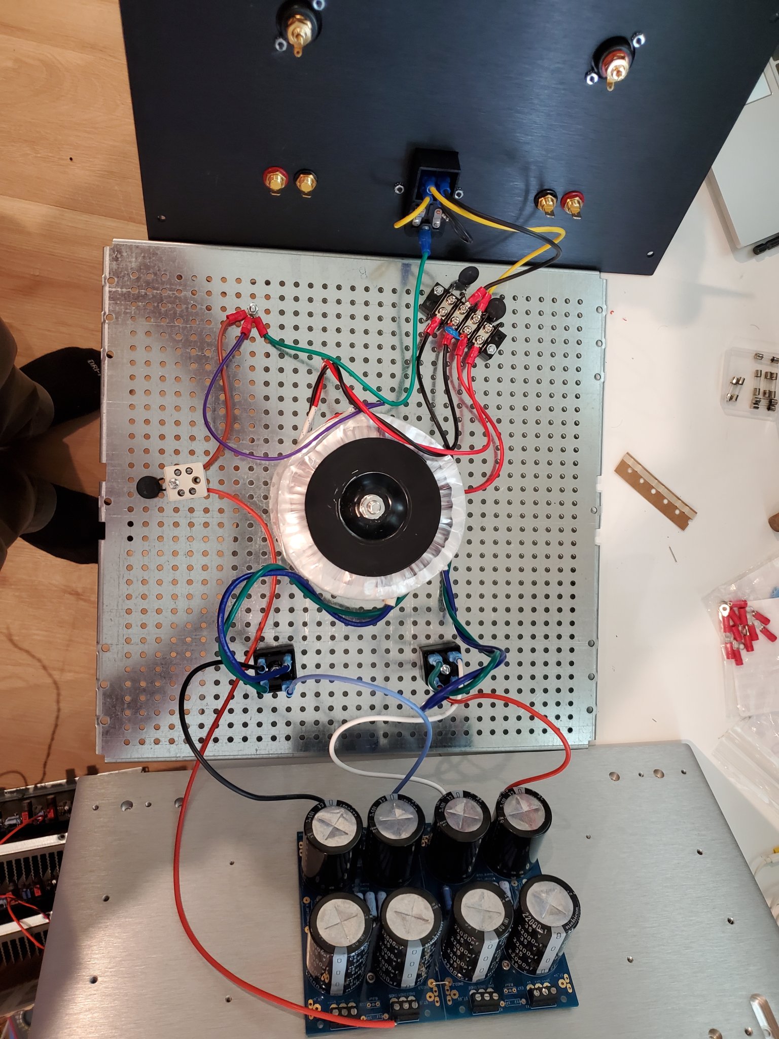

Hey yall. I'm doing an Aleph J build. I'm just testing the psu, and getting 56v just on the positive side of the psu board. 0 from negative. I know it's supposed to be 28 and 28. I'm sure I botched something. Anyone had something similar happen? Thank you!!
Pictures would be very helpful. Show how your transformer is hooked up to the rectifiers and the rectifiers hooked up to the filter portion of the board.

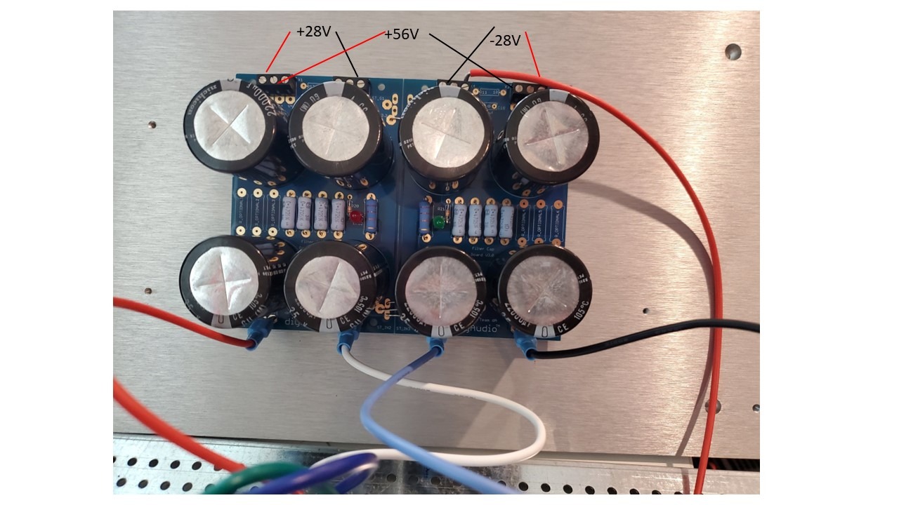

Looks like you've got red for your positive rail, and green for your negative rail. If the green LED lit... you don't have 0V to that side of the board.
In addition to 6sX7's advise, be sure you are measuring properly. If you are measuring between the two outermost sets of contacts... you will read 56V.

Nope I'm stupid. You're totally right, both leds were lit, I was measuring AC. DC is 25V positive on red side, negative on the green. Now I am curious to know why the positive side sees AC current. Thanks a bunch to both of you.
^ 56VAC would be very, very odd. Are you sure there's not a decimal in there... and/or that it's not showing mV, or that you're measuring in the correct spot? My best guess (so far) is that you may be measuring the ripple and not reading the meter correctly. A quick and dirty sim of that type of PSU shows 103mV of ripple with a very, very light load... just your resistors / LED. I get 53mV with an estimate of two amp channels loading the PSU. Not too far off... and I used big fat estimates. I have a rough time picking up mV level AC with a handheld DMM, but yours might do a really wonderful job. YMMV.
So... I'm not saying that's the reason, and that you're having another measurement issue, but it's an idea.
Noted that you're closer to 25VDC than 28DC. 🙂 If not, my next questions were going to be around your mains voltage and if you got a 20VAC instead of 18VAC transformer. Awesome progress.
Check that AC measurement one more time... maybe post a pic of the DMM and where your probes are placed if you don't get it sorted.
