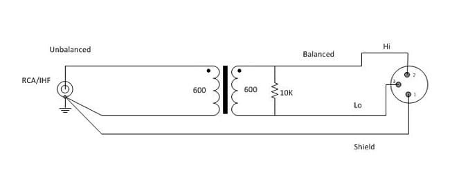

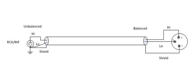

@ldarieut
I received a question regarding using the balanced output of a pre-amp to drive the Wolverine's single ended input.
I put this question to our small group and there was a few solutions put forward.
Here is one from @thimios , Thanks Thimios.
Below are a few options
The not expensive way
A more expensive option depending of the quality of the transformer.
For best results, use high quality transformers like Jensen, UTC, or even WE 111C (although they are huge) can be used. I have found several places where these transformers can be “scrounged,” DATS cards on the old 7300 series Scientific Atlanta satellite receivers, old modules from PRE consoles, etc. A simple audio “balun” can be constructed for little cost or effort and sound a whole lot better than doing it the wrong way.
I hope this helps you @ldarieut and other members.

Both of those examples connect audio ground directly to earth ground. Perfect way to make a humming mess out of a home audio system. If you are going to used balance connections in home audio where they are not meant to be used they need to be modified to let loop breakers and lifted grounds do their job.
Thanks Jeff, I will admit I don't know the finer details of converting a balanced output to single ended but, if this helps start a conversation that helps out @ldarieut then I don't mind posting.Both of those examples connect audio ground directly to earth ground. Perfect way to make a humming mess out of a home audio system. If you are going to used balance connections in home audio where they are not meant to be used they need to be modified to let loop breakers and lifted grounds do their job.
Is it not possible that the images above just had the wrong ground symbol shown?
Or could the ground symbol just be removed and the ground reference taken from the lifted signal ground?
Pro audio with balanced connections uses earth ground for audio ground (so many different grounds!). If balanced is to be used for home audio it usually works best to connect pin 1 to chassis as pro audio does, then let the chassis loop breaker do it's thing and provide the ground reference.
THAT (1206) does an excellent solid state adapter to convert balanced to single ended but it too has the same problem with people connecting pin 1 to audio ground.

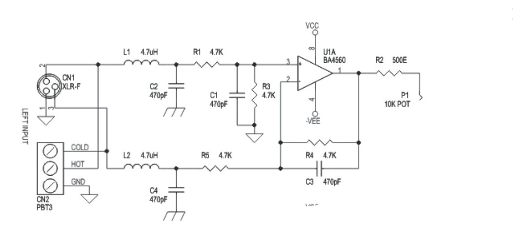

Back to my original question: balanced operation then is not possible using two amplifiers per channel (using bridged mode?)?
To allow balanced input you need to use an opamp with a circuit like I posted, or buy a balanced to unbalanced converter, or a high quality audio line level transformer (Jensen etc) and build it into your chassis. Most audio microphones run balanced (less noise etc) cabling, and you can quite simply tie the out-of-phase to gnd, and use the Hot as the drive. Or leave the out-of-phase disconnected, and simply use the hot and gnd.
Hi Jeff,i don't think so.Both of those examples connect audio ground directly to earth ground. Perfect way to make a humming mess out of a home audio system. If you are going to used balance connections in home audio where they are not meant to be used they need to be modified to let loop breakers and lifted grounds do their job.
Both of those examples do not connect audio gnd to power gnd.
Gnd symbol is the signal gnd,not the power gnd.
I use the first one every day,no hum st all.
Pin 1 of an XLR connector is connected directly to chassis normally. More often than not this is actually done right in the connector itself through the mounting screw. As soon as you plug your XLR cable into your source you are connecting audio ground directly to earth ground in the source equipment if pin 1 is connected to audio ground in the amplifier.
You are right!Pin 1 of an XLR connector is connected directly to chassis normally. More often than not this is actually done right in the connector itself through the mounting screw. As soon as you plug your XLR cable into your source you are connecting audio ground directly to earth ground in the source equipment if pin 1 is connected to audio ground in the amplifier.
The XLR pin 1 connection conflict!
In any case,do not expect any hum as soon as power gnd not connected at both end.
