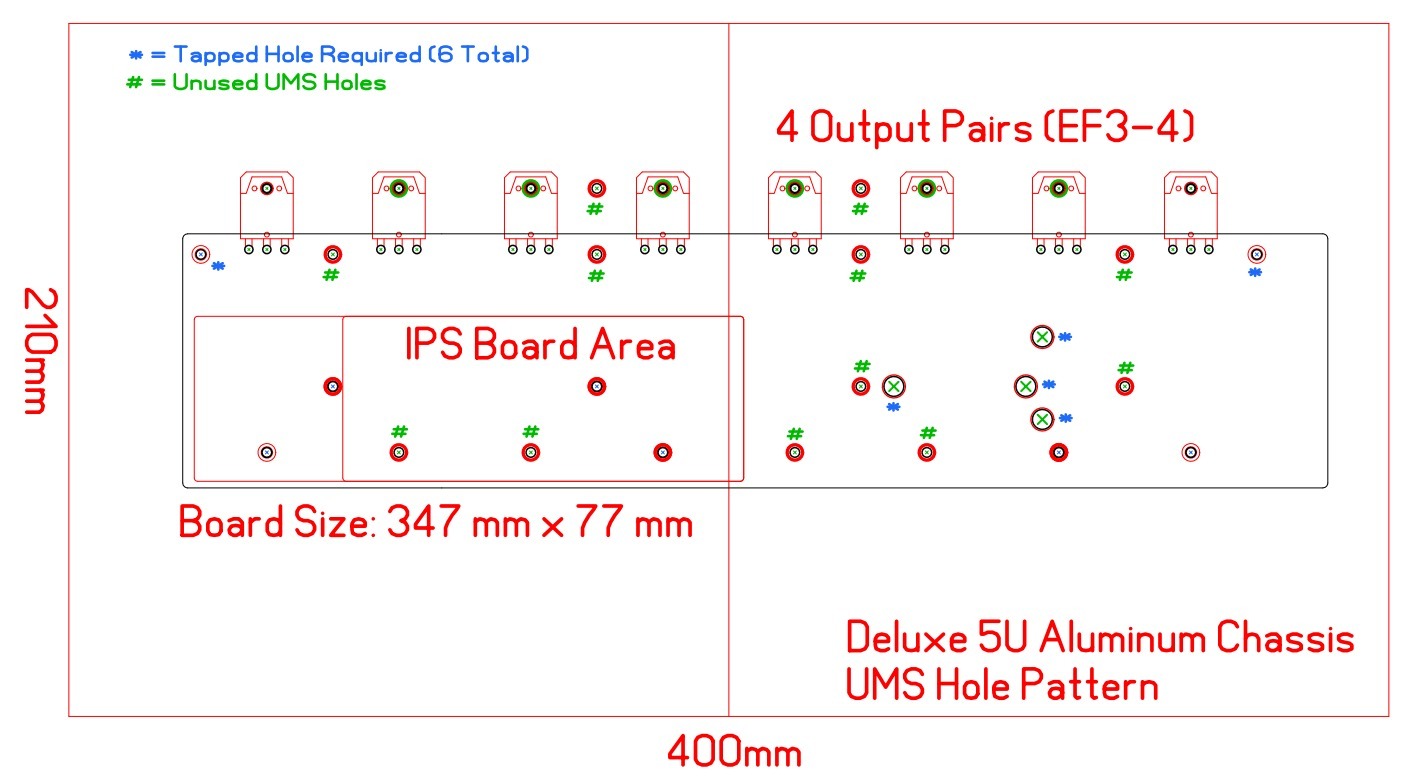

Hi Guy's,
Thimios is correct.
We thought that we would go all the way and give everyone the option between 3 pairs (suitable for smaller enclosures no drilling and tapping required and is a direct replacement for the honey badger pcb) and 4 pairs (suitable for larger enclosures. 6 tapped holes required)
The PCB's have been sized to suit rail voltages from 49V to 71V DC
We have named them
1. Precision EF3-3
2. Precision EF3-4
The Wolverine IPS can be used with either EF3-X board.
The EF3-4 board will also work just fine with 3 pairs installed.
Obviously the EF3-4 option is better suited to higher voltage, higher power, 4 ohm speaker loads.
The EF3-4 also gives the user the option when a parallel mounting option is used, to mount the drivers directly on the main heatsink.
I have attached images showing the pcb sizes and there arrangement on the universal mounting system holes (UMS)
