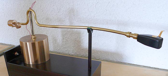

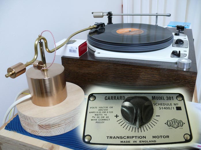

Anyway, details about the tonearm. I saw this tonearm the first time in Phy-Hp website. Original is designed by mr.Salabert.
I decided to try to make one for myself. It is made out of brass. I bended it to the shape and made counterweight. It is an unipivot tonearm. It is 18" long. I am going to use silver wiring to it, as soon as my order arrives.
It was relatively easy to make, because the design is pretty simple and easilly seen on the picture. I used 10mm brass tube to make the arm.
Here is a picture of the original tonearm, I used this photo as a guideline.
My tonearm might have different lengnth than the original, because I did not have any measurements.

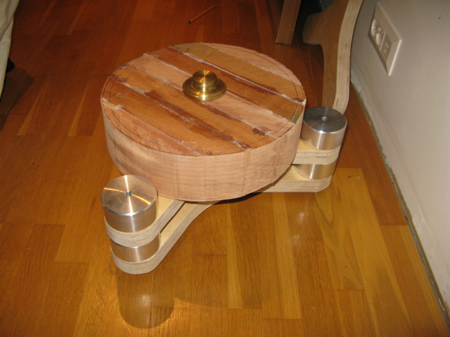

I made the platter of pieces that I glued together, and then I turned it to right shape. Here is one photograph from the platter in early stage.
Hi, it's amazing. I am planning to DIY my turntable and that's why I found this thread. I want to start with bearing...can you share some more detail on your magnetic bearing? I did see pics and drawings but it's great if you share more information. I am mechanic and I want to do it myself...
