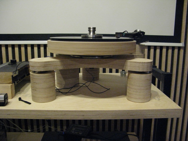

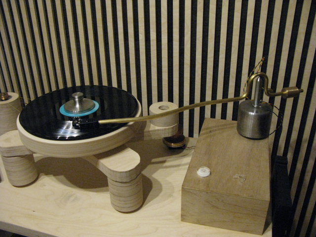

Maybe I should tell little bit about my projects. I started to think about building a turntable of my own about two yars ago.I saw teres audios wooden turntables, and was inspired. I had thorens td 320 turntable and I started by making a platter out of wood to it. Sound got better and then I made a complete turntable out of plywood, using parts of thorens(bearing, subplatter and motor). After that I made platter out of mahogany and the plinth out of plywood. I made the bearing myself.

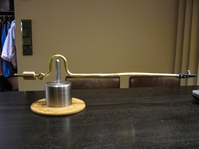

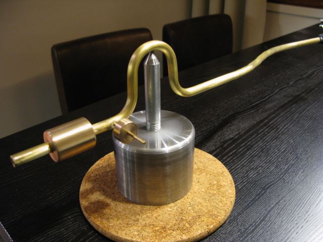

My goal was to make my own unipivot tonearm, and then I saw phy-hp:s Salaberts tonearm, and decided to try to make my own. I got It done, and It sounds good!
I have new projects in my head all the time, and I will put some pictures here when I start to build something new.

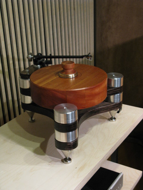

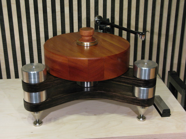

The platter is made out of mahogany, and oiled with uncoloured wood oil. The Plinth was made out of plywood(30mm thick) and oiled with dark wood oil.
nice job, how about the motor ? AC or DC, I give you my idea is to use a old direct drive tt as the motor, and use a really very thin elastic thread (from clothing material supply) for the belt. the only thing you have to do is turn both by hand first and power on, ratio almost 1:1 very quite and smooth, and the bearing of a direct drive platter is much better than any other power motor, keep going and good luck also happy new year

very nice indeed
a thing of beauty.

Love the tonearm as well. very nicely done! What material (dimensional brass?). Are the loudspeakers DIY with PHY drivers? (I'm jealous!)

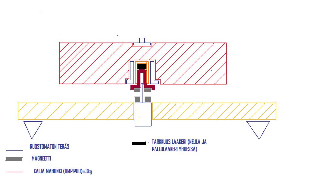

The bearing is not exactly like teres. I made magnetic bearing, a little bit like the one clearaudio uses.
In my experience wood is the best material for platter, and it looks beautiful. It is not the easiest material to use, because of the changes that moisture and heat might make.
I spent almost an year to finish the platter.

As I stated earlier., it is quite beautiful. Any details on the magnetic bearing?

Thank You.Here are few pictures.
All I can really say is wow! I bet it sounds wonderful..

That would be great, thank you. I actually have already done the tonearm, but I am going to change the wiring to it. The wiring I have in the arm at the moment is only temporary until I make new ones.
Here is few pictures of the arm.
The bearing is almost like the one clearaudio uses.

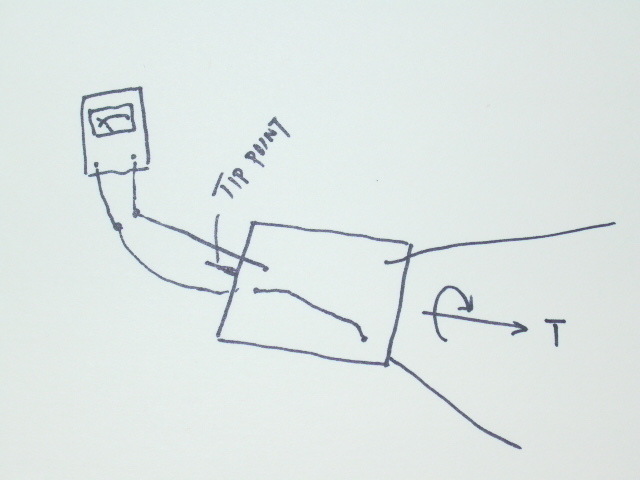

OK my cable is one piece about 4 feet long from cart direct solder to the phono amp's mc step up transformer's in-put. material is 28AWG 4N solid silver from Home Grown audio, 30AWG also will do the job but further thinner will not last for tie twist, will break off, they come with teflon tube, first cut 4 pieces in the length that you want, off the tube, hang them up with some weigh in the bottom, coat with polyurethane thin coat more than one coat is better. after dry through twist in two pair and twist again with the twisted, in doing this you will need a little tool. a piece card board as In the picture. drill 4 small holes with a tip in the middle for even distance in every twist and also with light tension force too, final wrap with thin teflon tape from pumping supply for outside protection . make sure there are no short circuit in twisting. and also it need break-in too load a resistor 2K plug to a radio line out play 24 hr. a day for a week, that will be enough for use. in here all my friends switch to this no matter how expensive tonearm they paid for .this is the bigger jump improve in the whole system but don't coast too much money . I hope you will understand what I talking with my poorer EnglishThat would be great, thank you. I actually have already done the tonearm, but I am going to change the wiring to it. The wiring I have in the arm at the moment is only temporary until I make new ones.
