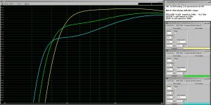

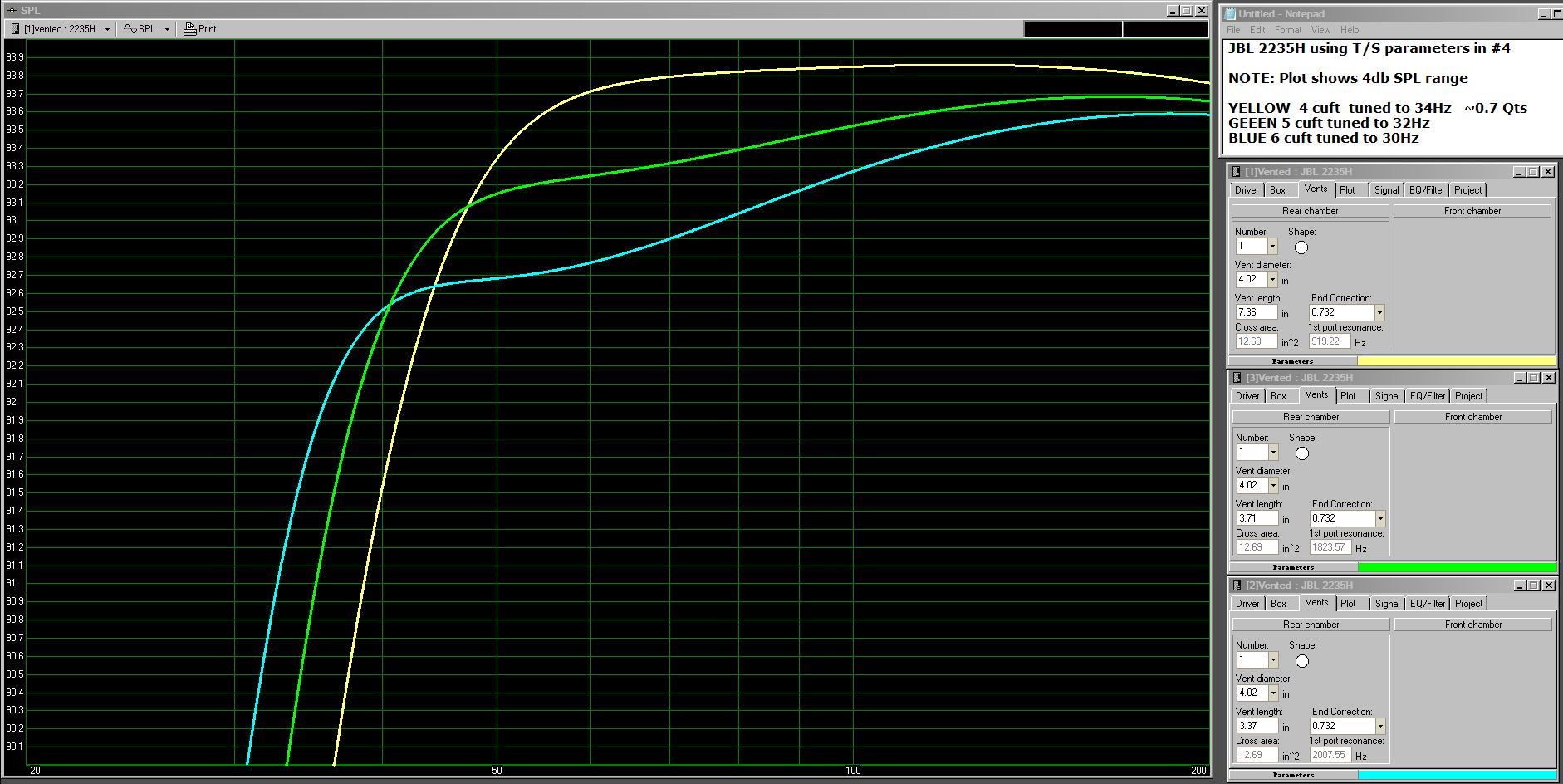

JBL 2235H using T/S parameters in #4
YELLOW 4 cuft tuned to 34Hz ~0.7 Qts
GREEN 5 cuft tuned to 32Hz
BLUE 6cuft tuned to 30Hz

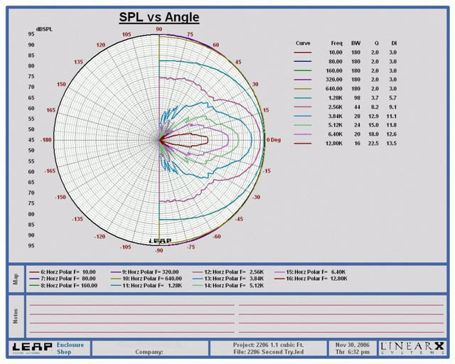

EXAMPLE Google search measurements for JBL 2206H.
Polar pattern example shows 98 degree polar response at 1280Hz.
Could help you decide on tweeter options worth further exploration.

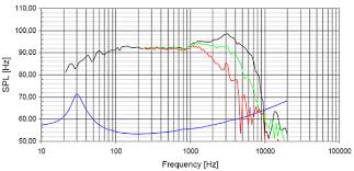

Your speakers could measure differently. A sweep plot of the speaker impedance vs. freq is the easiest first test, and useful to compare speaker A vs. B matching.
