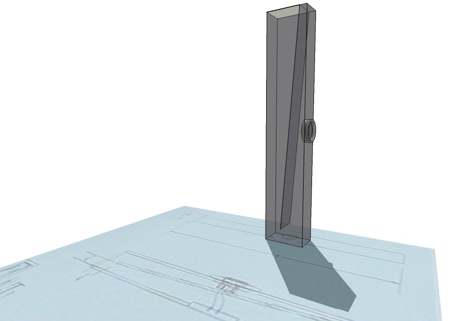

Here are the plans (and ACAD files at bottom) for the Autograph corner horn...
http://www.geocities.com/tannoy_autograph/Tannoy_Autograph.html
http://www.geocities.com/tannoy_autograph/Tannoy_Autograph.pdf

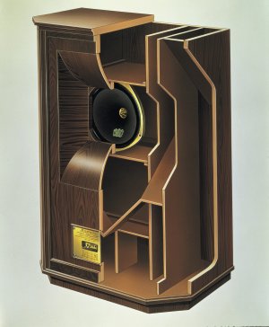

Here is the cut-away of the Westminster...
One Harvey "Gizmo" Rosenberg had a pair of the Westminster horns in his room. Albeit a giant huge, not very live room, fyi.
Not impressed.
It was run with a very wide range of tube amps and some solid state amps, iirc.
Imho, the little "horn" on the front doesn't buy you much of anything. The bass loading & output for that particular speaker was spectacularly poor.
Otoh, Martin's loading system does work - having heard his speakers. He gets rather impressive results from rather small and anemic looking drivers that in a sealed box or small ported box would likely not do much. So, if you build a speaker that has a folded horn of some sort that only mimics the Tannoy plan you might perhaps be on safe ground.

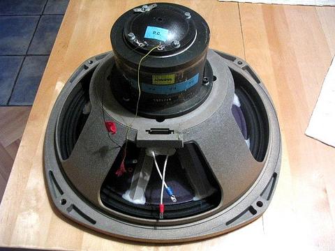

AndrewT - Tannoy have lots of 15" model numbers for different applications which are all pretty much identical. If I remember correctly from before Tannoy changed their website and still had the replacement part numbers listed, the Westminster used the 3833GG.
This is the same as the driver in the System 15 DMTII (3833) but with gold logo on cone, which appears to be same as 3836 used in CPA15 and 3860 in the CPA15FM (which just had a dust cap added - FM = Floor Monitor).
These are all Tulip Waveguide models, ferrite magnets. This was certainly true a year or so ago, don't know if anything has changed since.

The big Autograph corner horn plans looked way too complicated for me -- so kudos to you!
Yes, they are complicated, but only the first pair 😎
Why don't you try to contact directly a DIY builder?I could never find actual build plans for the Westminster, so I went my own way.

There are actual AutoCad plans at that same link I posted.
That is -- the 1st link (at the bottom, and downloadable).
For future builds, you can have them CNCd with the AutoCad plans 😎

I was offered a pair of 10'' Golds for +/-180GBP
Here: http://profesional.beyma.com/producto.php
you can find my coaxial wich is in fact a used 15KX.
I wonder if I can get some serious SPL...woofer handles 300W and 2''tweeter handles 100W, sens. is around 98db/W/m

MaxLorens
This is for a much small driver -- but it gets the idea across
TQWT
Oh! Don't know what TQWT could be but certainly sounds impressive ... and earns you redemption...
TQWT
TQWT = Tapered Quarter Wave Tube. A varient form of quarter wave resonator (or TL if you prefer) that's narrow at the sealed end, and wide at the open end, as shown in the excellent render qi has done above of Terry Cain's Bigger Is Better cabinet. (I like the original line drawing incorporated into it BTW).
