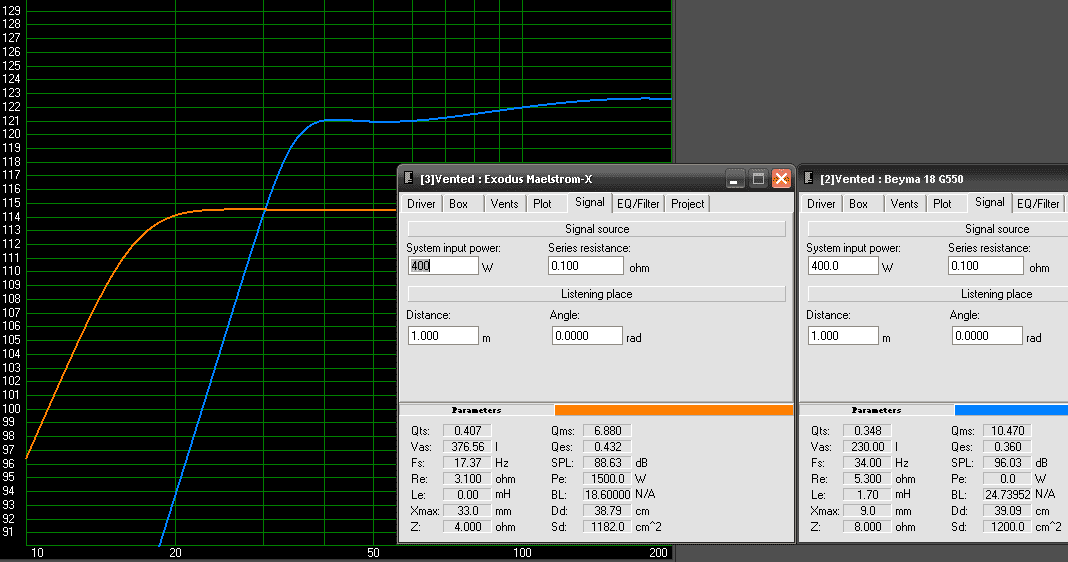

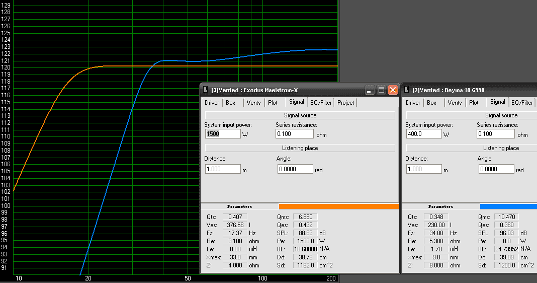

Here's a simulated example - a pro 18" with 9mm xmax and 96 db 1w1m and Exodus Maelstrom 18" with 32mm xmax and 89 db 1w1m.
What does this show? Two very different drivers for two applications. You would never consider them for the same job.
First chart shows 400w input where the pro driver reaches excursion limits (even with a 2nd order highpass that keeps excursion below tuning no greater than above tuning). Where this is enough extension the pro driver seems to have the advantage - more efficiency. We could give it 100w and get the same SPL level. Cone excursion would be less because the vent is helping where the HT sub can't claim that advantage. If the pro driver had sufficient power handling we could extract more output if desired.
Second chart shows the Maelstrom with it's rated thermal limit. It uses most of it's excursion and reaches almost as much SPL as the pro driver but with more than 3x the power - 1.5kw.
All very theoretical so far. If you have a lossy room without room gain and you want to get to 20 Hz or below, then you might start with a monster vented corner sub, and if one driver isn't enough then stack them. Then you might use more efficient subs higher up (the multi sub approach). If you have sufficient room gain and/or don't want to get down so low then I'd say efficiency makes more sense.

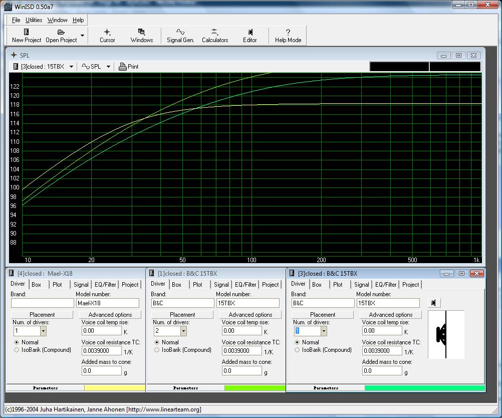

Paul, is your comparison using the same box size and Fb?
Here is a simulation showing a Mael 18, and a single and pairs of B&C 15TBX100, all in closed 8 cf boxes and 1000 W input.
Shrinking the box to 3 cf compresses the differences to a range of 3 dB.
Noah - no. The Maelstrom has a bigger box, but both are huge. They aren't suited for the same tuning.
