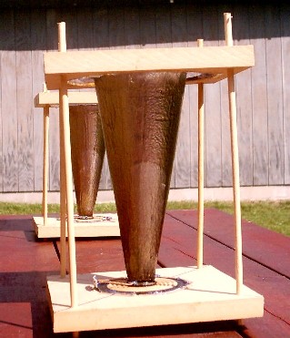

Pan said:You don´t use a stiff cone in this type of driver, forget it. Using a stiff cone will eliminate the bending wave principal and more or less make it a "odd shaped cone" with ugly break-up resonances.
The DDD driver use a titanium foil that is relativley soft and it´s also damped with something "glue-like" on specific places on the inside to improve upon the behaviour.
Don´t count on getting good results with a DIY DDD driver in the first couple of years.. this is complicated stuff.

True, true ! The DDD drivers cone are VERY soft when You touch them. It is very easy to make dents in them however it does not seem to effect the performance. It just looks nasty. Thes cone is very soft, like some thin plastic almost.
The principle with bending wave is that it travels along the surface of the cone - it's not working like a piston.

Initial test low level with a boom box as a sound source on the picnic table sounded very good. Not as efficent as I had hoped but it acheived my 1st and most important goal reasonably flat sounding and it doesn't sound like a box, imaging was incredible.
"imaging was incredible"
Did you listening inside or outside?

I had the drivers on each end of the picnic table and I sat in the middle between them.

"I had the drivers on each end of the picnic table and I sat in the middle between them."
I take that as a yes to outside? Guess picnic tables are usually used outside 🙂. In such case the relative freedom from reflections and standing waves helps a lot in reproduction of the record. Most speaker performs way better outside... except for the bass which becomes anemic due to no support from the room and cabin gain.
navin,
I´d say no. Jordan is a small direct radiator while the DDD is a 360 degree bending wave transducer. Very different animals.
