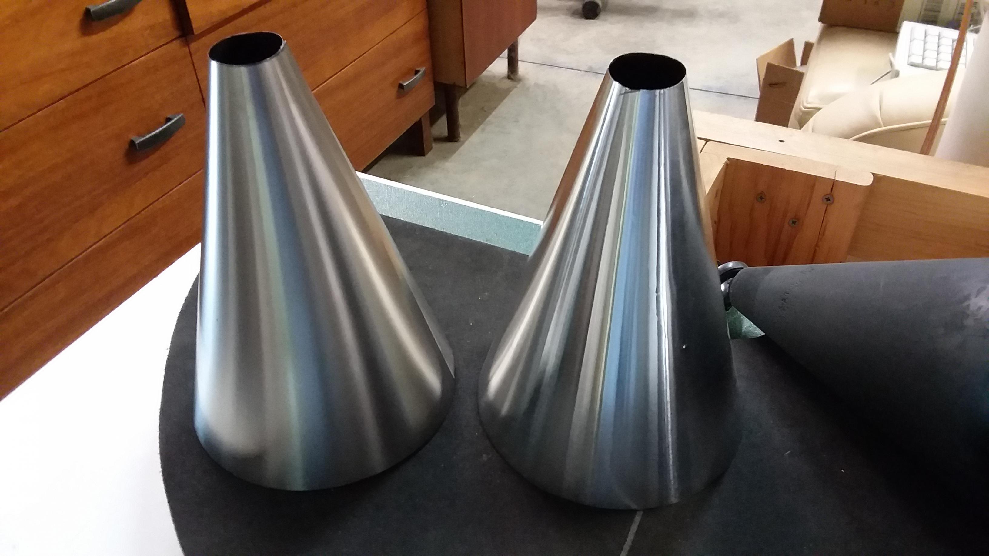

...and some pics...*S*
Promised pics...A
In some sort of order:

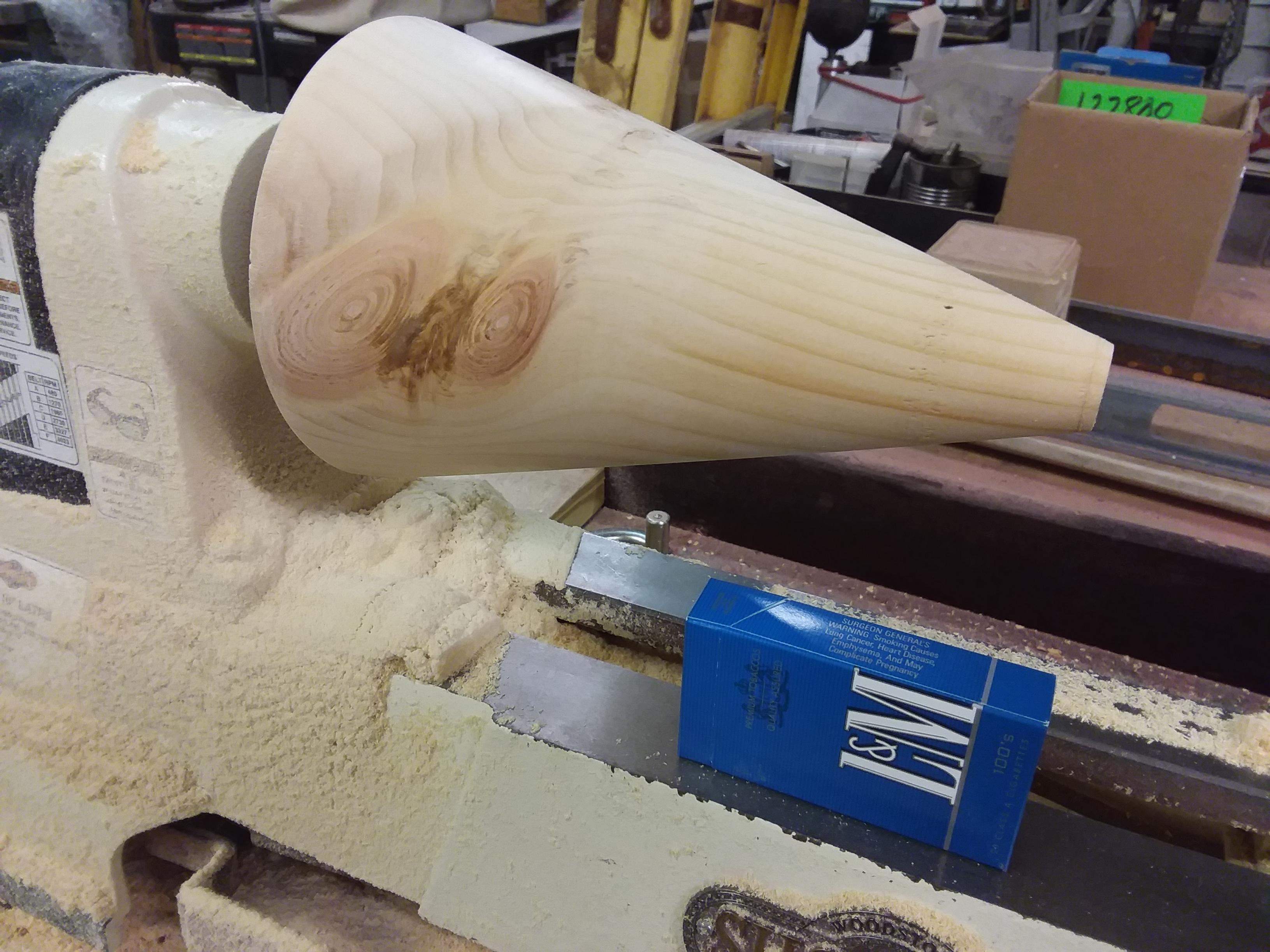

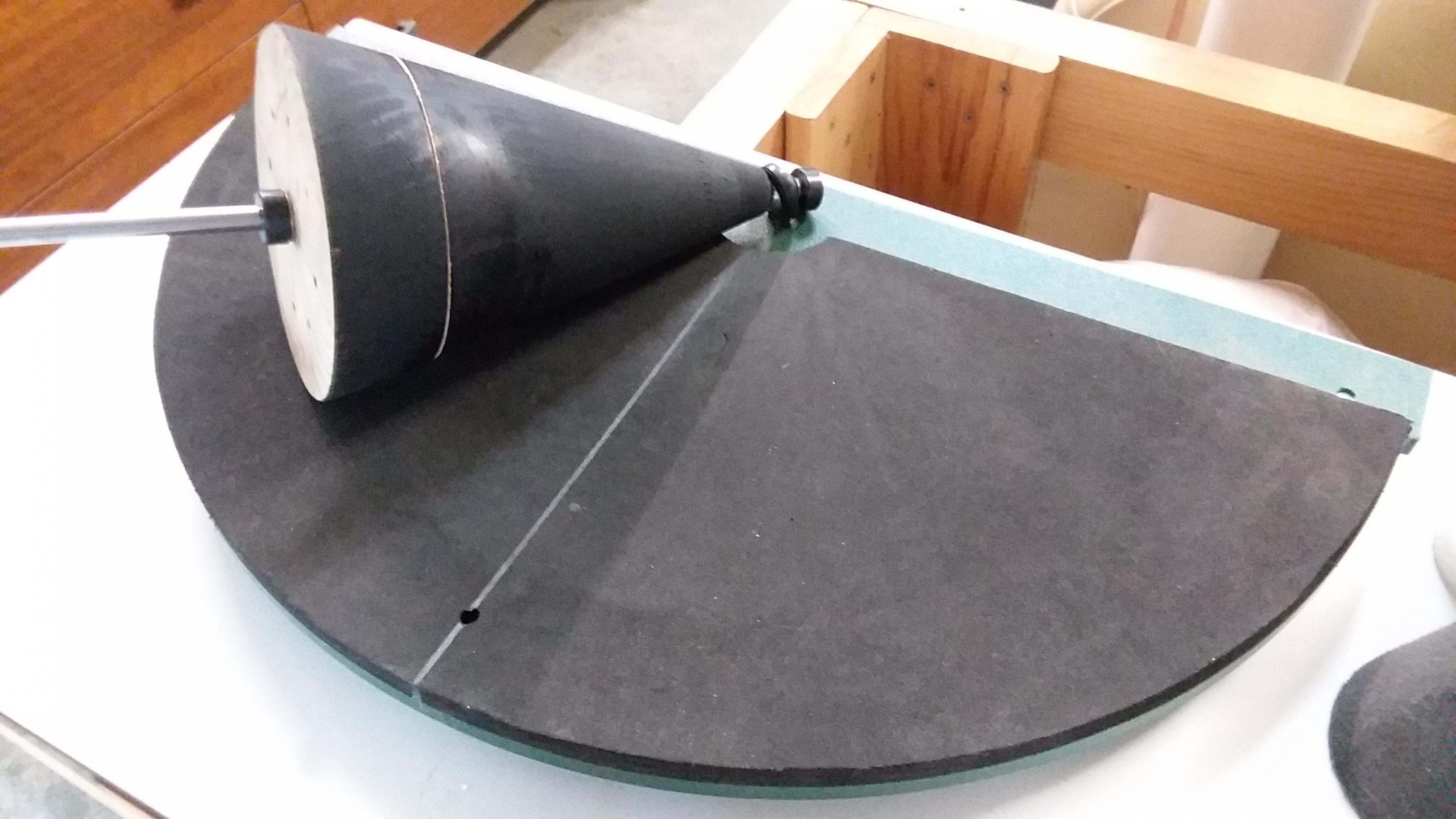

The cone form on the lathe (pack for scale)
Cone rolling mechanism....

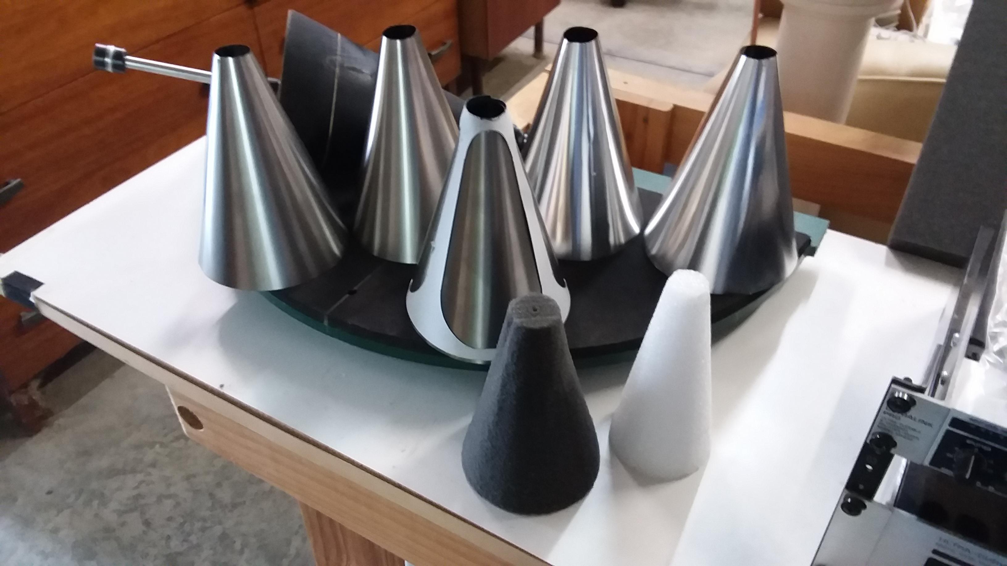

P.P. C
(The cone with the white 'skirt' is a concept I want to try....a 2 mil alum cone 'insert' over a 5 mil 'skirt' with 3 'windows', bonded together. It'll either be a buzzy mess or ?.....we'll see...*G*0

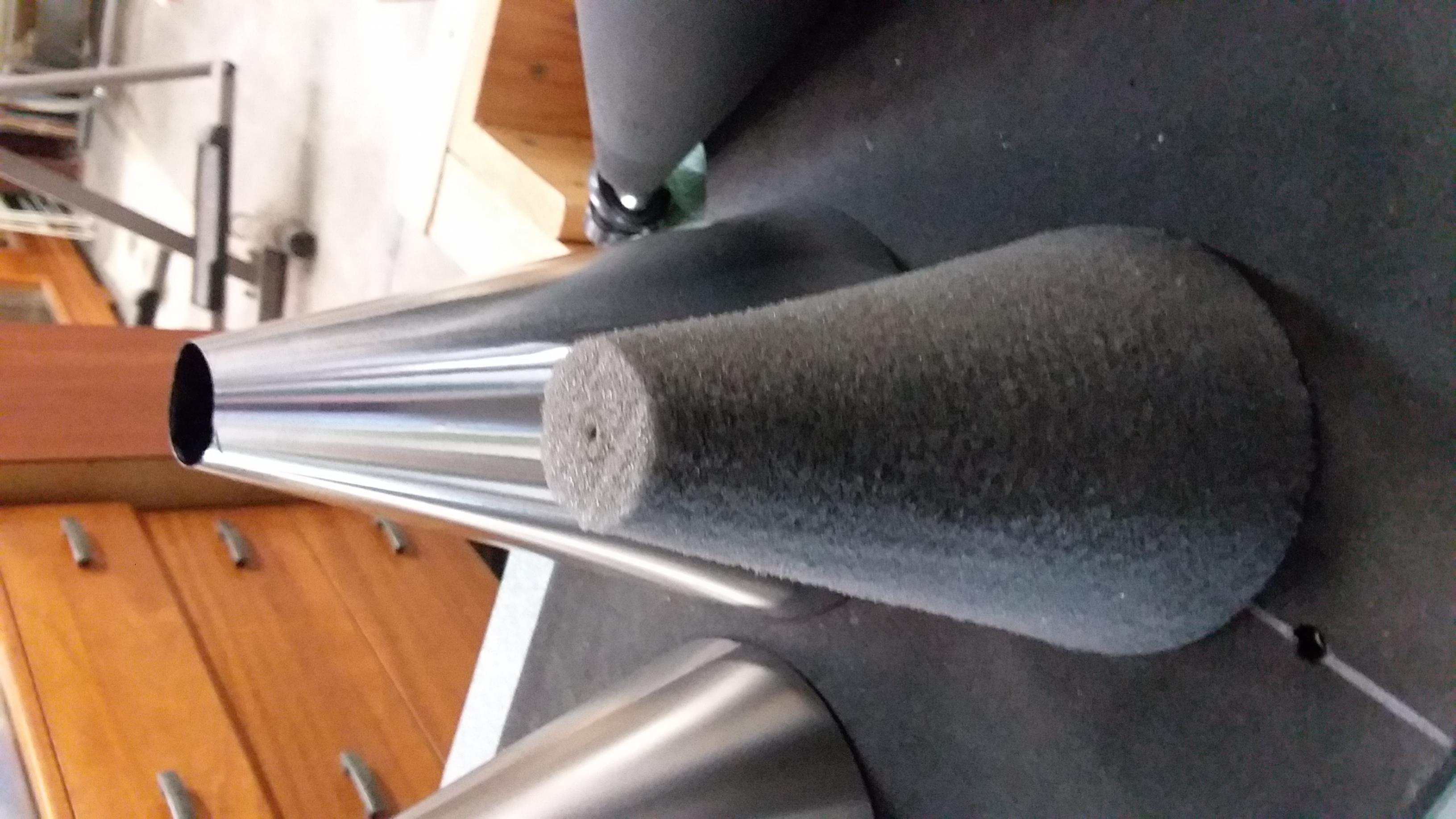

The black cone shape is acoustic foam....shaped on the lathe with an electric carving knife, turning the lathe by hand. It takes a few go's to get the feel of making it work, but the hardest part is getting it to Stay on the face plate....
Inserting the foam cone into the metal cones' interior wipes out 'cone honk', which I've noted before...

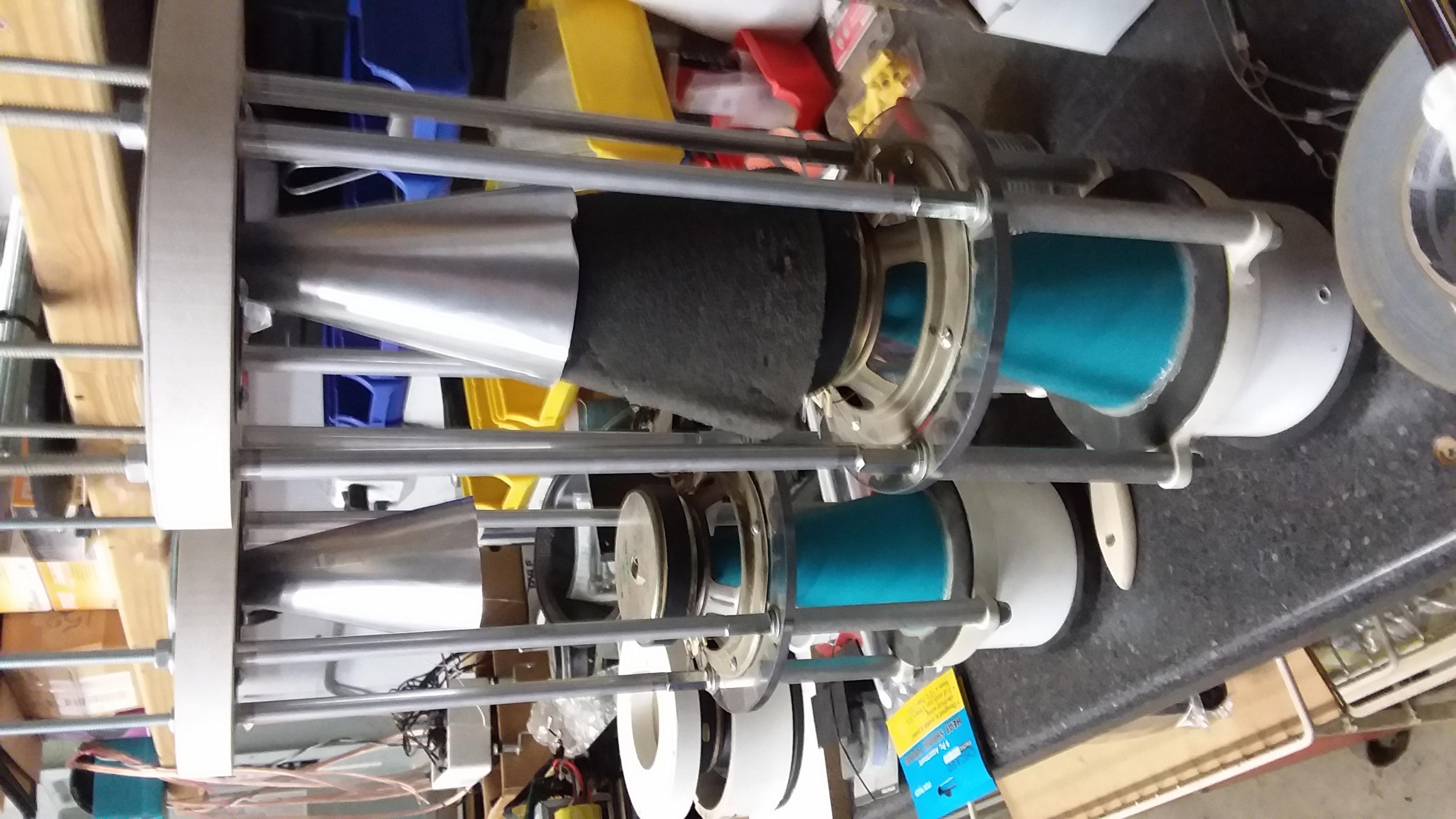

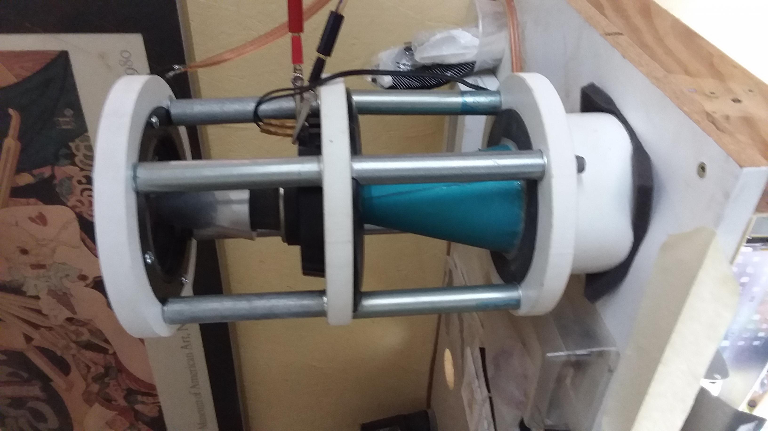

....and a pair of prototypes.....the one on the shelf is one of my 'puter monitors, the other pair is nearly ready to be played to death....*L*

Thanks, ABJ....and a big 👏👍 to Thomas as well...*VBS* I'm impressed by his venture and speaker, a nice blend of Walsh & transmission line 'sculpture' (calling it an 'enclosure' doesn't seem right nor appropo)...
I find the application of his driver choice and the means of support fascinating. No 'exterior support' or 'framework' to intrude on the cones' radiation pattern.
In the pdfs' attached, he's applying a DML driver; these typically are adhered with VHB film tape. Strong stuff....I use it to 'close' the seams on my cones.
Once applied and joined, it's 'over'; you don't get a 2nd chance to redo the seam without destroying the cone....🙁
A thought on a next version (isn't there always one in mind?...I thought so...😉 DIY is like that...*G*) is using a version that's screw mounted if available.
The reason I suggest this; the pair of my speakers shown on my workbench use a two-way driver with the original center tweeter removed. This left a center hole through the magnet structure, also centered on the voice coil.
Sized for a #10 or 5mm machine screw, one could have a mechanical joint at a very critical point. Not that VHB 'gives up' easy, but it's still a small contact point....
Just saying.... There is the issue of the metal basket of that sort of driver, and what to do with it....🙄
I'm still wrestling with that conundrum as well...a 'custom inverted basket' would do the trick, but not $ feasible at this time....*shrug*G*
*L* They may not be 'pretty'....but they do work.

One very critical point in this design is the alignment between the voice coil former and the membrane. It needs to be perfectly in line.Any miss-allignment Will generate distortion. This is the reason why I made number of the jigs to assure this.

Yes, try a foam cone within the driven cone...to my ears, it 'cleans up' the response without degrading overall performance. Size it to the same general shape of the cone, and mount it so there's a +/- 1 cm. space between cone surfaces...
Another thing to play with is that gap....I'll bet lunch + beer that a calibrated mic and a waterfall display will exhibit Something Happens....😉
The 'honk' of the cone, when listened to without an....'cavity' (that works; beats 'enclosure', since there's none...) beneath it goes away...
The two smaller 'prototype' unit pairs literally have no cavity. Their bases are sealed at their bottoms, an experiment with 'acoustic suspension'. With a smaller driver, it seems to give them 'punch' for their size (13 cm. tall x 7.5 cm. bottom dia. x 2.5 cm. dia. @ the v.c., 75 deg. slope).
That pair (used for my 'puter monitors) are mated to a small Sony self-powered sub. Tiny HF Walsh tweets with foam cones, simple cap xover....
Junk drivers all, driven by a Phillips 'desk-top' stereo with a 'sub-out'.
I can play them to max volume to 'clip'...haven't been able to break them yet...*L*

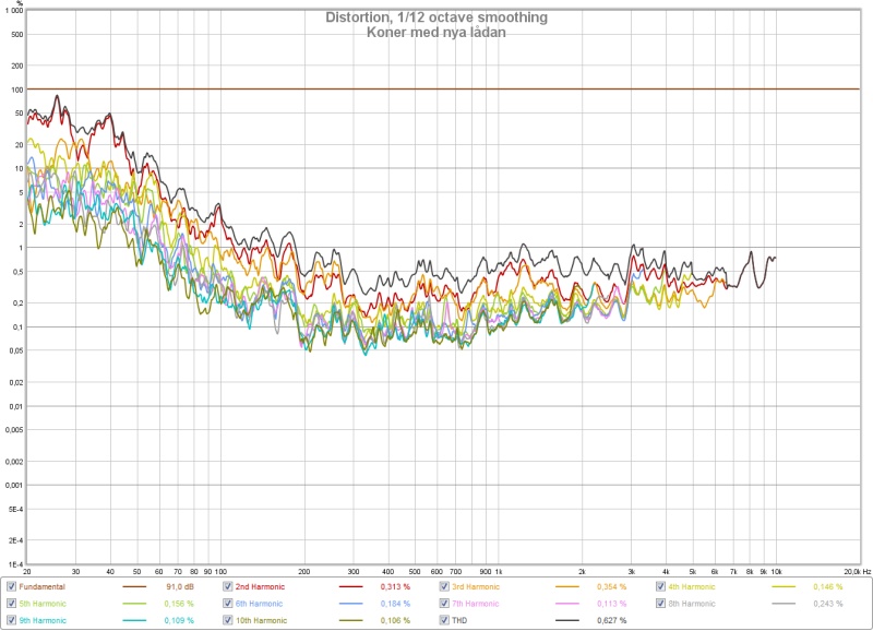

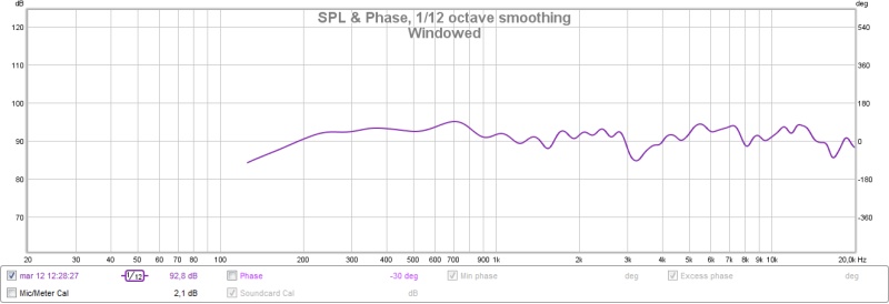

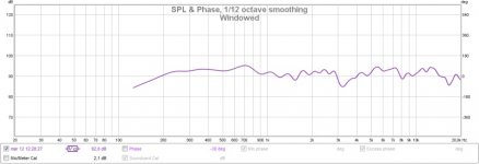

Measurements
I have Done some simple measurements (indoor) using REW.
Frequency response and distortion.
The frequency response is Windowed which means that the response under 150Hz is irrelevant. Measuring with pink noice indiciets that they play down to approx. 67-70Hz. i.e. they need support from a couple of sub woofers...

Looking Good....
..Thomas! I agree with ABJensen and you, a sub will 'fill in' the bottom hz for you.
I run a sub with mine....crossover freq varies with the size of the drivers...
The smaller ones obviously cross higher than the larger, which I suspect are close in base diameter to yours...
*G* Let the graphs and your ears be your guides...taking into account the room they're in, of course. 😉
Have a good Sunday and stay healthy...😉
Jerry
Yes, I Agree they need the support from woofers.
I have been experimenting with all sorts of woofers closed box, bas reflex, open baffle, H-baffle and infinite baffle. Reason being that it has been seriously hard to integrate.
I have found that the best alternative is the infinite baffle. However that is bit hard to implement...so I ended up with a sort of H-baffle.
I have also been experimenting with cross-over freq. I’m currently using 250 LR24.
Have very good Sunday!
