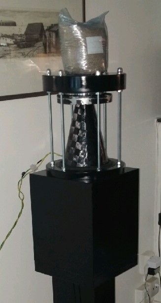

As requested,
First of all I like thank everyone on this thread it's given me a lot of input.
My current version is based on a full range driver with a 50 mm voice coil.
I'm using carbon fiber in the cone. The size of the cone is 220 mm high and 150 mm diameter in the bottom end. It's roughly 0,16 mm thick. I'm using a 60g/sqm fiber and epoxy.
It plays from 80 to close to 20000 Hz.
How does sound? It's pretty decent. There are still lot to do primarily in the area of resonances...
Thomas

Sanda, hey, that's Beautiful! *VBS* Your cone's +/- 25% larger than mine, and they roll off @ 100hz & 10~12khz @ the top. Probably due to the heavier/thicker aluminum (5mil) I use, as carbon fiber or titanium aren't in the budget for now....25mm voice coils as well.
Have you noticed any heat coming from the coils, BTW? High spl ought to warm them up, so beware 'enthusiasm' in that regard. But larger coils ought to allow more 'headroom' for you, so I'm totally jealous...*L*
...and the 'basic black' is sexy... 😉 Except for the box....I'd lose the box, but I'm committed to the 'column look'....MHO, you can ignore. *L*
Hi, thanks.
Yes, the sandbag is there to reduce vibrations that generates a lot of noice.
No, I haven't noticed any problems with heat build up in the voice coil (compressor) The coil is sound with rectangular aluminium and it is rated to handle 300w continius.
Yes, I'll drop the box. It's ugly I agree and it creates at least one problem. There is a standing wave at 425 Hz. The distance between the bottom of the Box and the voice coil is 0.4 meters. Ned to create a solution that does not involve loads of damping material.
Thomas
I suspect that the noise/vibration issue is due to the larger size of the voice coil and the overall strength and power that it can generate into the 'system' in general. I don't experience that with my current iteration, but they aren't rated to that level of wattage nor the strength of the cone material (aluminum). That and I still keep my 'exuberance' down due to heating up the coils.
You don't mention if the box is sealed or ported. If sealed, you might try porting or going to a transmission line design to tame that. I know that the current Ohm speakers do just that in some fashion.
I noticed that the German Physiks Walsh drivers seem to have no 'base' cabinet at all, which drove me to seal the bottom of the base of a pair of units I made. A venture into 'acoustic suspension', if you will. 'No cabinet, no standing wave' was the thought behind that. Or, at least, the standing wave is driven into a higher frequency... They're paired with a small subwoofer and seem to 'play well' in that configuration.
But that's just me 'playing around' with them. I really need to point a mic at them and run some 'sweeps' through them to see what that does to their performance.

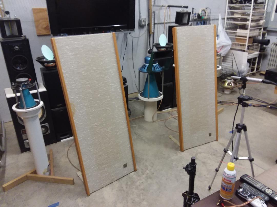

I use them as 'monitors' in my office space, which is a small (8' h x 8' d x 16' w) room. Certainly 'loud enough' in here for 'practical purposes'. *L* The space itself likely creates 'standing waves'. 😉

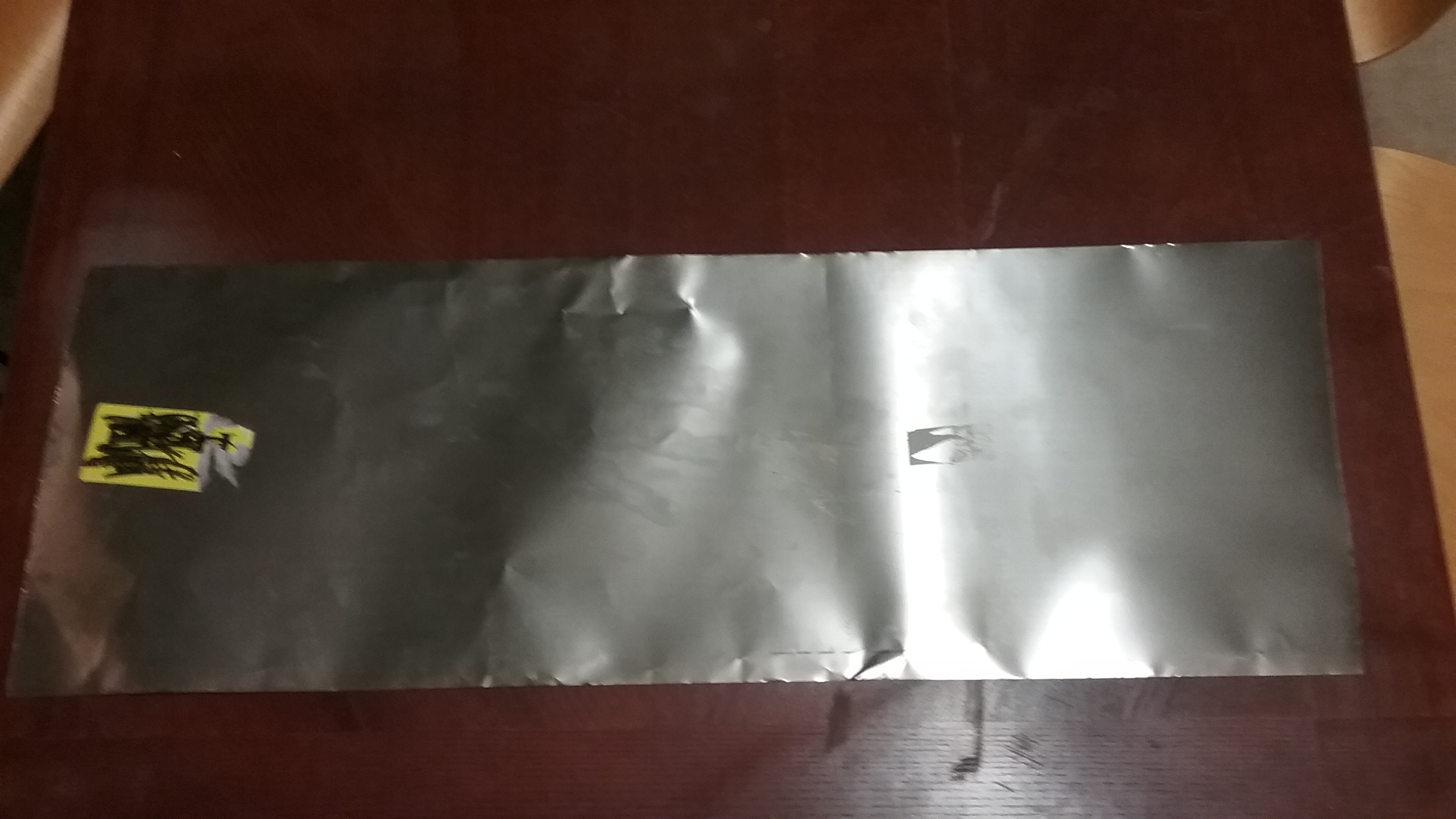

Have finally arrived at a methodology of rolling cones that will solve the issues I have with 'manual forming' by hand with cranky materials. And it doesn't resort to expensive machinery or Rube Goldberg extremes. I believe it will allow me to create predictable cones that don't have the issues that have pestered me with my previous attempts....
...and it won't cost an arm/leg or any other extremities that I'm fond of...*G* Every now and then the Muse smacks you upside the head and makes you pay attention...
Have also sourced some 2 mil titanium for V.5....Yes, V.5. 4, of course. Smaller, but Ti has intrigued me for some time and the opportunity arrived to give it a go.
BTW, I can get more of that material...12" wide, CP grade 2. Enough for whatever floats your boat, but I'd like some assistance with the purchase since it's more than I can conceive of using at this juncture. But if I can get a few equally 'driven' individuals interested in a 'bulk buy'...and it's not as expensive as one might think. PM if curiosity overcomes you. *G*

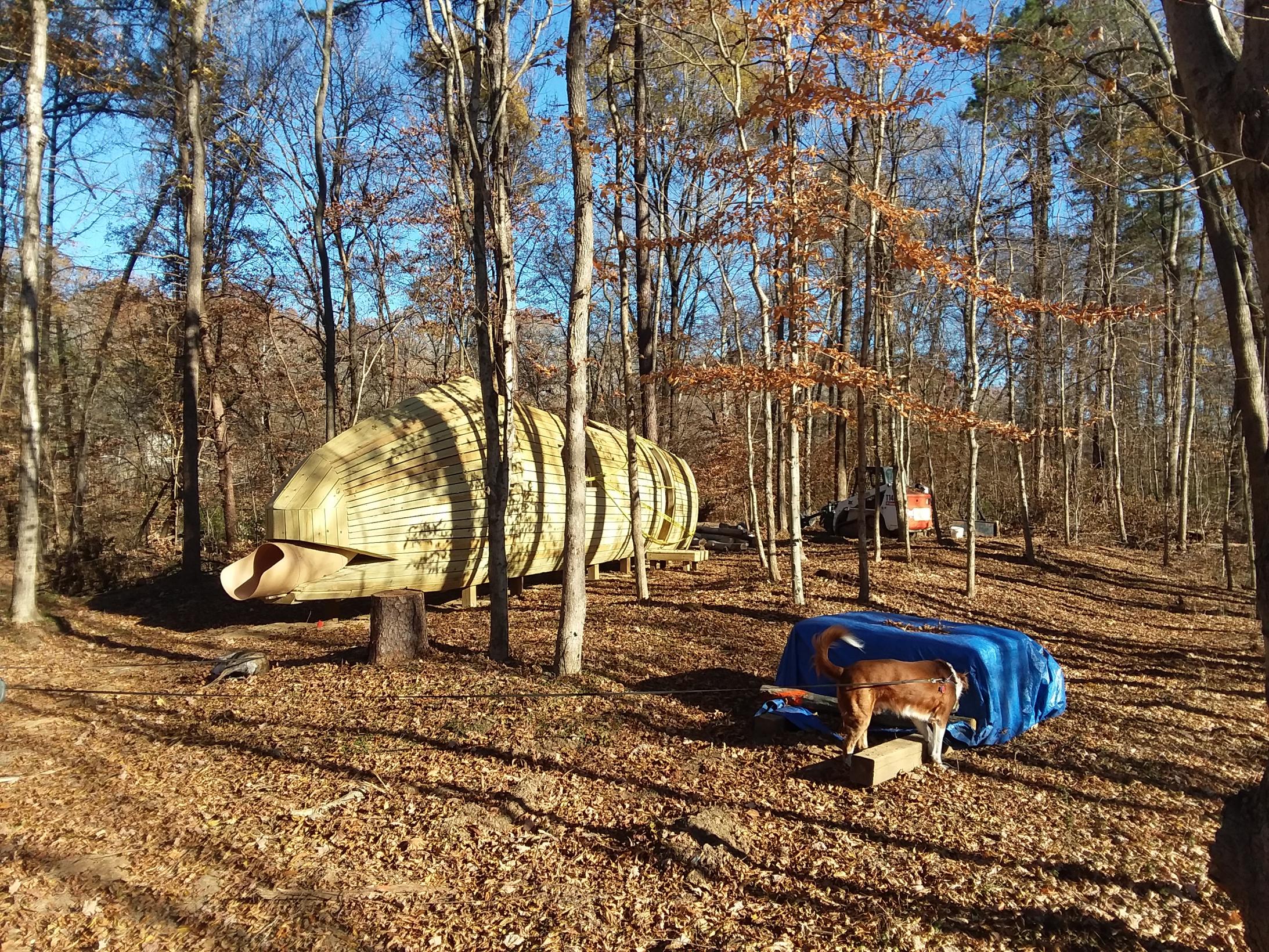

(Attached is a RL job that's about to 'wrap' near Chapel Hill, NC. That's a fish play structure, awaiting it's metal pipe 'fins'...currently being powder coated...36' long, 45' with it's tail...206 CNC 'rib segments....)
