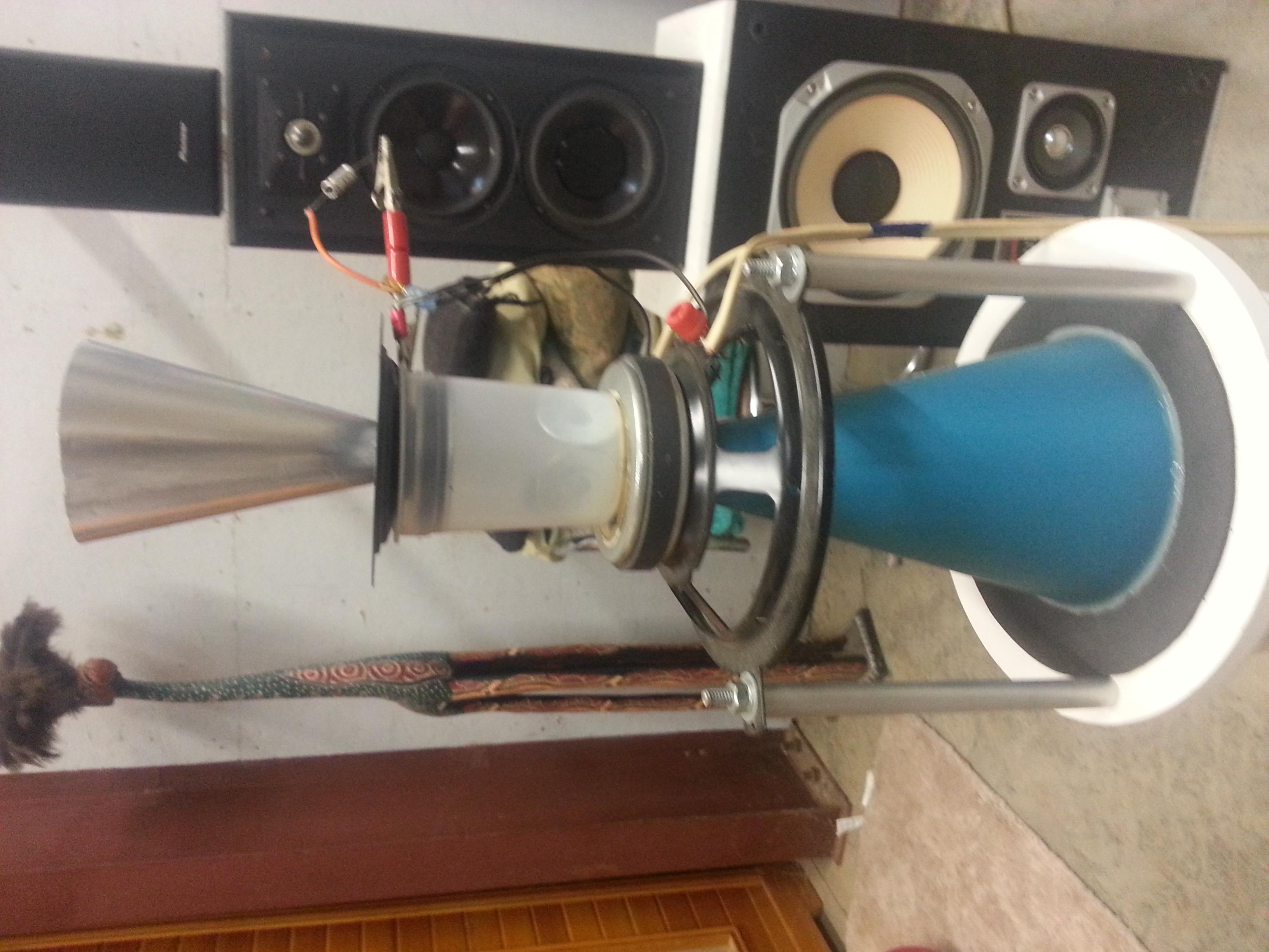

Some progress
After and amidst a long hiatus (work related, same old same old...), the V.4 upper radiators are partially completed. You'll pardon the 'test mount'...one does with what's at hand...
All 4 functioning as hoped, a 'broader' midrange and the highs extended. A rather cursory analysis with the calibrated mic and the RTA agrees with what my less calibrated ears tell me.
Unfortunately, the lower 'main' radiators will be waiting in the wings for awhile. One has to remind oneself that patience must be a virtue, as any other description sounds like an agonizing wait.
2 mil aluminum cone, no interior treatment or damping. No plans for a surround...the only thing I could conceive of using for that would be have to be incredibly light, as the alum creases if you look at it hard. I have some dental dam latex that I might try on a test cone and driver, but adhering it to the cone without crumpling it will be a test of practical levitation....
...which means I'll have to try it...*G*

Yes, it posted sideways although it's properly vertical 'here'. In the final application, the cone will actually be flipped like the V.3 beneath it. They work properly that way...

How does altering the spider and/or surround stiffness change the sound of your aluminum cones? My hypothesis is that for a Walsh-type driver one would want a stiff surround, to minimize excursion, and maximize the bending or transmission-line effect of the aluminum cone. The logical conclusion of that premise is a higher-wattage/low X-max coil pushing the aluminum cone against solid board. Perhaps this would work better fir some frequencies, but maybe not so well for others?
Your V.4's don't even have a surround for the Tweeters, so that shoots my theory down (but what happens at the loose edge? does the sound from the inside of the cone blend with the sound from the outside?). How about mids/woof's, would you recommend a softer suspension on the woofer surrounds and spiders for more excursion and lower frequency, or go stiffer than the mids and feed the woofers with more power?
On a separate train of thought: How are your splitting frequencies between your multiple drivers? (I may have missed this on earlier posts) 2 channel amp after active crossover, or single amp channel with passive crossover? I like the idea of active, less chance for clipping and distortion but it's definitely more work.
Keep up the good work, It's inspiring, and wish I could hear them directly!

In proxy; I would say a stiff termination would yield as much of a terminal wave reflection as a free ended termination would. It is frequency dependent but, highs are less effected because they are absorbed faster due to cycling time.
All 'speaker cones' exhibit bending wave radiation, it's just that Walsh configurations are better suited for coherent radiation.
Walsh cones (for their intended use) are only good down to their 'co-incident' frequency i.e, the frequency where wave velocity drops below super-sonic, that; being a function of frequency.
Not sure if I answered your question.

Thank you, Cochleus - makes sense. I did not consider the wave reflection factor. Makes it even more important to establish the right degree of surround-compliance for a given frequency range.
Also, I wonder how one would go about determining the "coincident frequency" for a given driver (material, size, shape?). Seems like an important parameter for a multi-driver configuration.
I may not be able to tinker at this time, but I can't stop wondering about how these drivers work and how to tune them to sound as accurate as possible (minimizing distortion at their intended frequency range)
Six - Minneapolis
Yeah, some resistance at the terminus is important for the sake of reflections. In general, the higher the frequency the faster damping occurs because energy is absorbed with each phase cycling.
A simple way to establish a coincident frequency could be to just measure sound pressure level during a sweep with the driver in an 'open baffle' setup.
Below the coincident frequency sound waves do not radiate from the cone surface into the medium (air).
