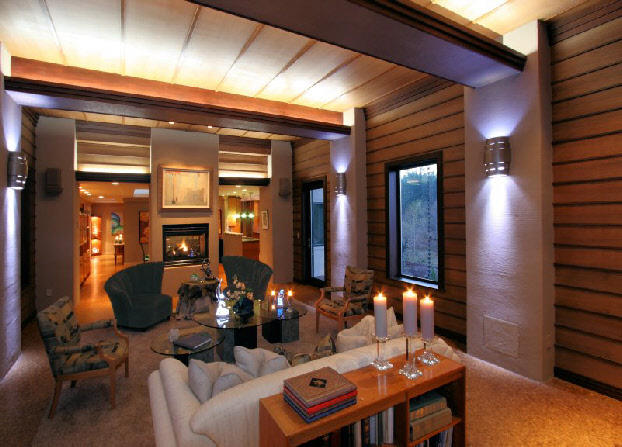

My current sound system is really very nice, Kef 101 and home-brew 10" subs (4 of'em). My wife likes good, deep bass, and we found an acceptable compromise for placement in our wall columns. The 101s pretty much disappear. Sound is quite good, though. The room is quite rigid with slab floor, ICF (Insulating Concrete Forms) exterior walls and all.

Lovely home, and a admirable 'stealth' install of your system. It disappears, but with 4 subs it certainly can make its' presence known. *G* And I'll applaud your use of ICFs'. Know the specifics of them, and wonder why they're not being used more often. Although home construction technologies have improved, so little is being actively applied on a useful 'large scale' by the industry. Our recent install reminded us of that, being in the midst of a new development in progress. I've yet to be impressed by any 'mass market' homes' construction. If it's faster and cheaper, it's there. Don't expect much more than house wrap on the exterior, and it's still just a pile of sticks nail-gunned together. But I'm just another old cranky, crying in the wilder mess...

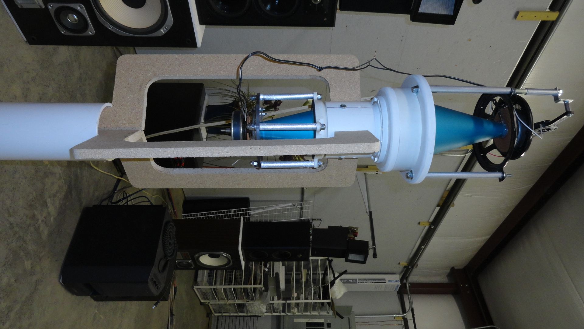

...a long threatened 'experiment' comes to fruition...
Just some particleboard scrap utilized, not elegant but suitable. Sizing of the lower void was meant for a 6" V.3, but a V.2 pair was siting around idle, so...
Mags, it's just as I thought (if you're watching)....there is no noticeable negative effect with regards to gross cancellations of response, at least in a listening test. If anything, volume/spl seems to be augmented...which IMHO relates as to why GP 'pairs' their DDD units and indicates such in their specs.
Because of the difference in size of the cones of my drivers, there seems to be an 'evening out' of the tonality, much like what we'd experience with different driver sizes with a conventional speaker. If there's anything going on that's perhaps not apparent without 'getting deep', there may be the condition of the cones moving towards each other in the lower frequencies being cancelled out. If the seal between the two was airtight (which it certainly isn't now), any tendency to 'push air' as with a conventional driver might be damped out. Just thinking...
If there's anything noticeable that's a negative, the spatial qualities at the intersection/collar at the bases create a 'null zone' in the near field, say 1~4'. Not surprising, that. The radiation pattern tends to be tilted 'up' from the cones, more or less at a right angle from the cone's angle.
...but fun to play with, none the less....*G*
Next variant: Mount the units reversed from as shown, but spaced apart vertically...think of the lower unit above the upper one, but say 3~4' apart.
Will the created dispersions 'blend' better, much like the interaction of the T/M/W of a conventional speaker? My experience with my little clones says they will....stay tuned. 😉

Hi, Gary. Yeah, this is/was one of those 'what if's' that intrigued me. Since the patent shows no real enclosure/cabinet beneath the driven cone....and since air motion as in an regular driver isn't really a practical factor in the sizes I've been making...I wondered what would occur if they were put 'butt to butt', literally. One could dispense with a 'base' such as I've been doing; simply a plate between two cones that would support the surrounds. Noting what the dispersion is doing presently, it might be interesting to suspend two radiating cones midway between floor and ceiling and see what occurs.
In my space, that's not a 'fair test', since the ceiling is 12' overhead. But in a conventional room with an 8~10' ceiling, it could be interesting.
What I've noticed with all of the drivers I've concocted, with their bases, if you pick them up and listen to them facing the bottom of the cone, they sound terrible. But, as soon as you place them on a desk top, or onto a column such as I'm currently doing (which is just to put them at a convenient listening height), they sound 'normal'....for a Walsh type driver, anyway. On two of the columns (an older pair), I'd drilled a hole to see if there was any appreciable bass being created. In actuality, No. No air movement from the 'port' (if you will), even holding a piece of tissue over it. Even tobacco smoke isn't moved ...
Now, the F's and A's DID create bass from the bottom, true. With a substantially larger cone structure involved, I'm not surprised. But it came at a price; too loud, too long, *pffht* went the voice coils. HHR has tackled that with modern materials and construction, so the reliability has improved without a doubt. But I suspect the inherent weakness is still there.
Having the cone structured in the way it is, with it's 'built-in crossover' in the materials used in the cone was and still is genius. And I can appreciate the 'full range driver' approach to reproduction by it's simplicity. But as you noted, physics IS physics. It's always struck me that it's better to have something do One Thing Well. You don't use a fork for soup, being really blunt about it.
If you do, it seems an exercise in frustration. You can only get so much done. *L* But that's just me, and the way the remains of my mind respond to things of this 'n that nature. *shrug*G*
