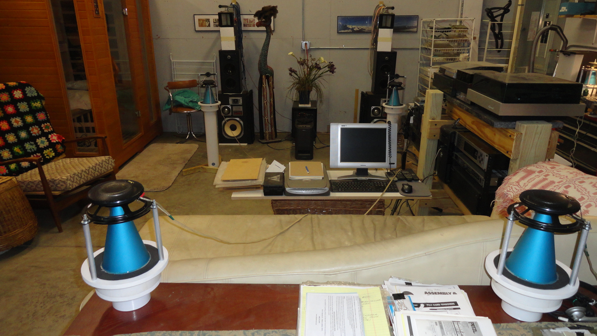

Oh, BTB...here's where the V.3s' live, and who they get to play with.
'Adventures in holographic dispersion'? Maybe...😉

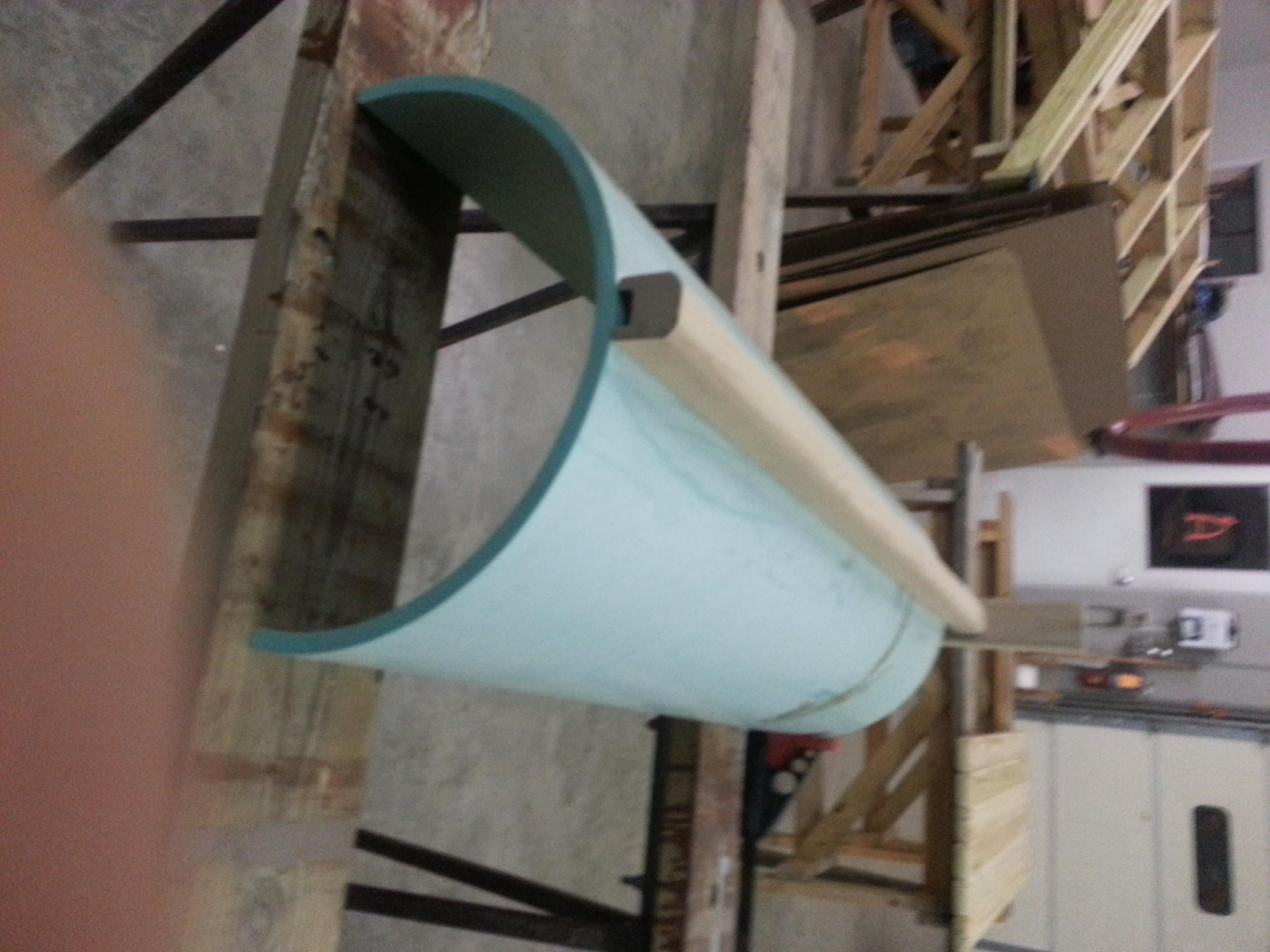

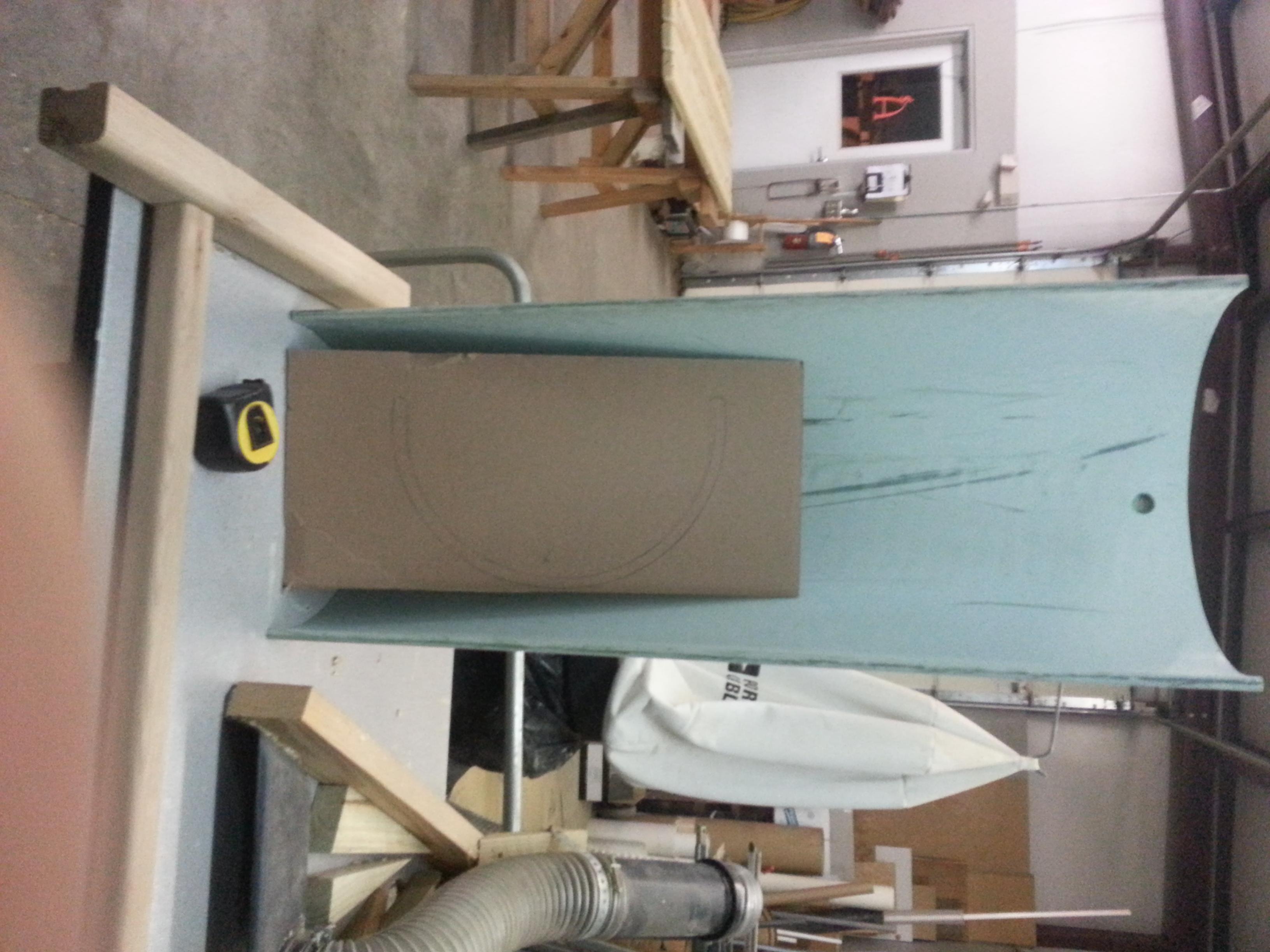

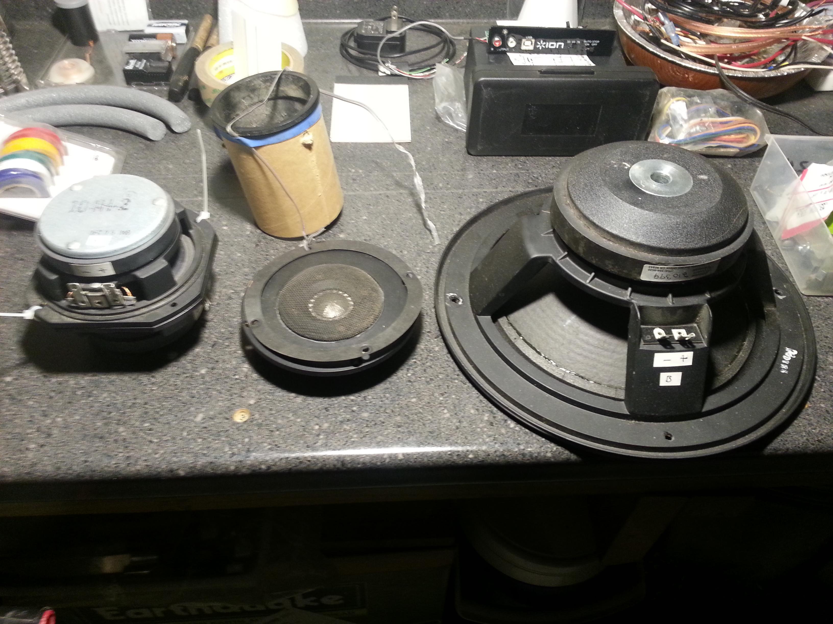

The drivers are from a pair of JBL LE-08s' literally found in the trash. Enclosures looked like they'd been massaged with chains, but the drivers were and are 'sound' *L*. Had the woofs reconed, ready to roll...
The 14" dia. x 36" PVC is 3/8" thick, ought to make great backs, no standing waves for this kid. Frame up the balance with oak and MDF face panels. Paint the PVC piano black. Size it to match the original enclosure volume....
Drop by, watch the show....😉

Sorry, too vague on my part...*G*
The half tubes will be the backs for new enclosures for the JBL drivers.
Walsh project on a temporary hold awaiting 'surplus' funds for new drivers to dice up.

The sound...hmmm. First off, they're omnis. You can walk about one, and the sound is uniform all around it. It's when you have a pair that they work their 'magic'. The 'imaging' expands beyond the speakers, and the speakers disappear. At least, that's what I hear...
The sound quality, based on my crude (yeah, they look 'cool' but they need improvement) units and tempered by their size (7" h. x 1"/4 1/2" dia. cones) rolls up at about 200~250 Hz and falls off at around 9ish KHz.
Currently I'm running my 4 with the treble +10 db, bass -10 db, keeping the volume at a max of -25 db for extended periods, -18 for short term to keep the voice coils from cooking. A small sub handles the bass below 200Hz.
The cone size doesn't yield all that much bass. And since the cone excursion is limited and constrained by design, one shouldn't expect much. The columns I place mine on are mostly to elevate them.
The sound I have is...'polite', if you catch my drift. These are not 'rock' speakers, although my tastes lean that way. They LOVE pianos. Classical music is rendered nicely, traditional instruments come across smoothly.
It reminds me of the whole 'LP/CD" or 'Analog/Digital' discussions. Walsh speakers would likely thrive in an 'Analog LP' kinda world. Without 'serious measurements' with resources I don't have, my impressions are about all I can offer you at this time...
