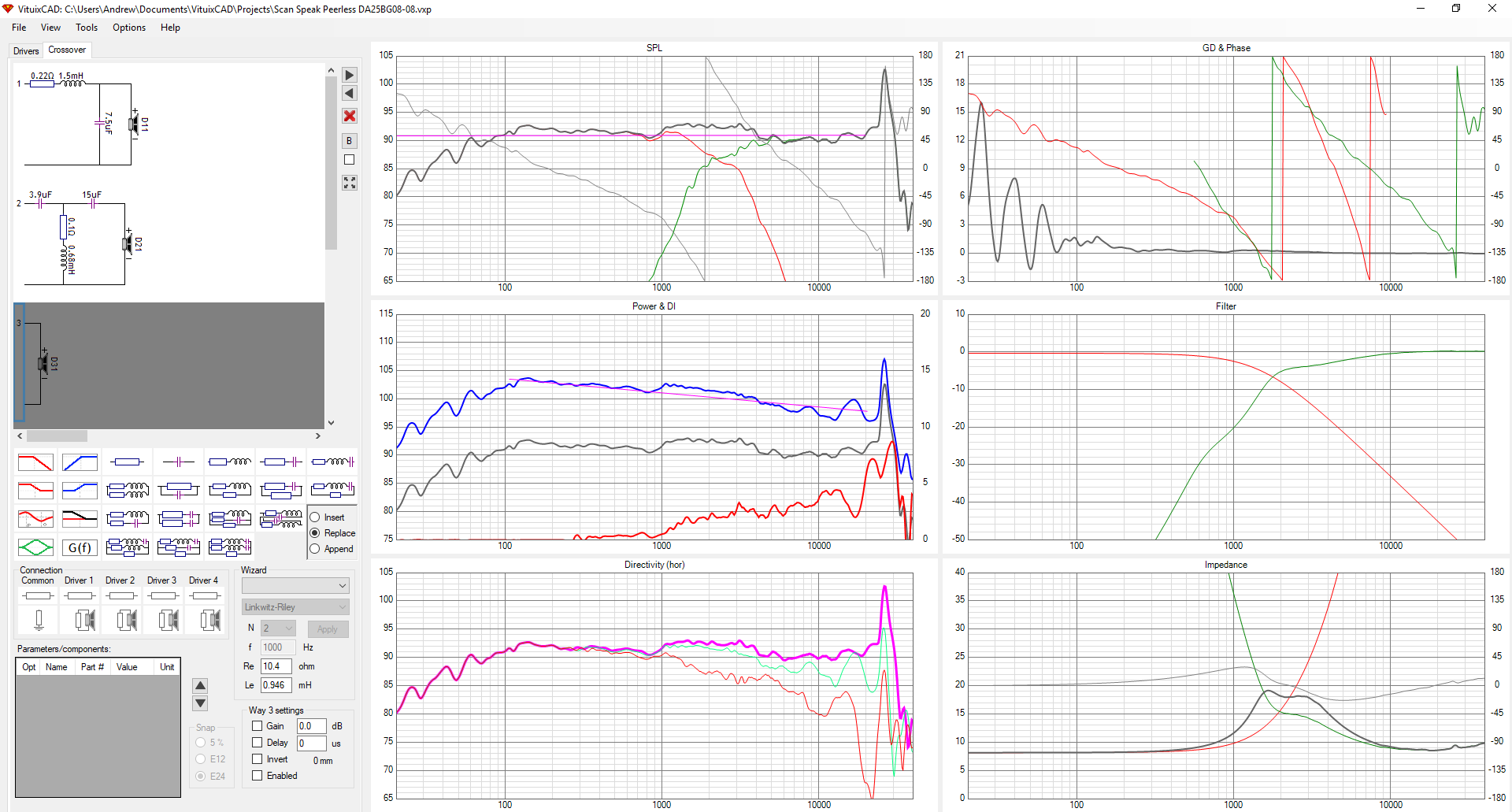

However, I would like to know what practical results can we expect if we chose an straight axial response ??
As already mentioned, axial response can be straight enough when power response and off-axis responses are optimized too. Problems are expected if axial response is optimized flat but everything else is totally ignored; not measured, not simulated, not in mind. Sound could be death and stuffed but harsh and too bright at the same time due to power dip at the crossover area and power hump about octave above.
This is not the worst example but some problems are clearly visible. Same drivers and measurements in both cases.
1)Axial response (black) is fully optimized, but power (blue) and directivity index (red) are totally ignored. Crossover slopes are electrically 5/6th order.
2) Axial (black) and power (blue) responses are optimized with weighting of 50/50%. Crossover slopes are electrically 2nd order.

Below of a different approach to combining the scan speak and tweeter concentrating more on off axis responses. there is still a region where you can see in the direction graphs the lines pull together as the tweeter becomes dominant. There is a limit to what makes sense to compromise. (This is just a driver simulation it has no box or baffle)
