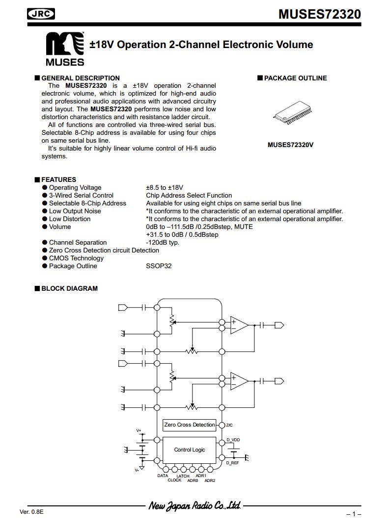

As -111.5 to 0db at .25db steps plus mute= (111.5*4)+1= 447 steps
Then 0db to 31.5db at .5db steps= 2*31.5= 63 steps.
I read this as a total of 510 steps. 😉
I like .25db steps better.
But, I would like to see a device that has .1db steps throughout the range instead.
jer 🙂
jer 🙂
.25db steps is way too small. I have attens that use half db steps and THAT is often too small of a change.
.25db per step means that you have to allocate more digits on a display to show it, more update chars (slower to display), more math to be done during the display and worst of all, you can't fit it all in a single 256-step byte. I really like being able to keep the volume setting in an 8bit byte.
just because an engine can go down to .25db is not a good enough reason to implement it that way, at the application layer.
fwiw...
fwiw...
".25db per step means that you have to allocate more digits on a display to show it, more update chars (slower to display)"
Yes, This is my thought too and is why I suggested .1db steps instead. 🙂
jer 🙂
jer 🙂
.1db is going to make you turn the knob SO MUCH, it will annoy you.
I built a .1db attenuator (using my relay atten circuit, 8 relays giving me about 32db of total range). the intention was not to vary it for program material but to use it as a 'trimmer box' to match levels with my subwoofer and the mains. set it once and forget it, but I needed fine db spacing since you do notice small changes with subwoofers.
regular daily use of vol controls would make you hate having .1db steps.
I strongly advise against it.
or, have some mode where you can adjust down to .1, but for daily use, half or even 1db is really all you need to do the daily ups and downs 😉
