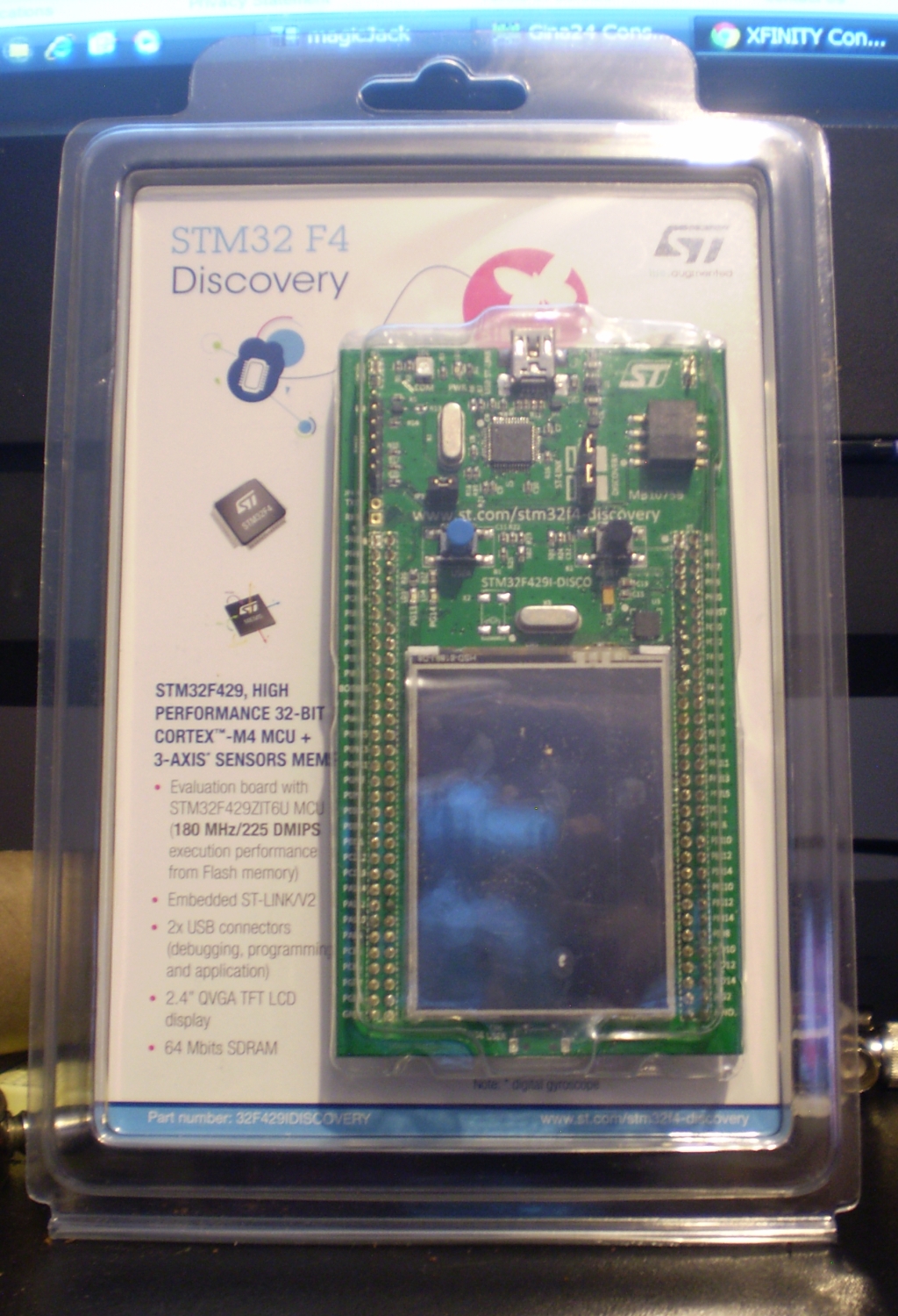

I am starting to embark on such a project myself for a patch bridge for my Multitrack recording system.
As a control you may want to look at that has everything you may need is ST's STM32F429IDiscovery board as they are only about 33$.
32F429IDISCOVERY Discovery kit for STM32 F429/439 lines - with STM32F429ZI MCU - STMicroelectronics
Once I start too learn how to use this thing it is going to open up a whole knew world for me as I haven't done any programming since the 8-Bit days of Basic.
It is an incredible little board and has a 800 X 600 color TFT touch screen as well.
It is a cool little board for what it is.
I liked it so much I got two more of them!!!

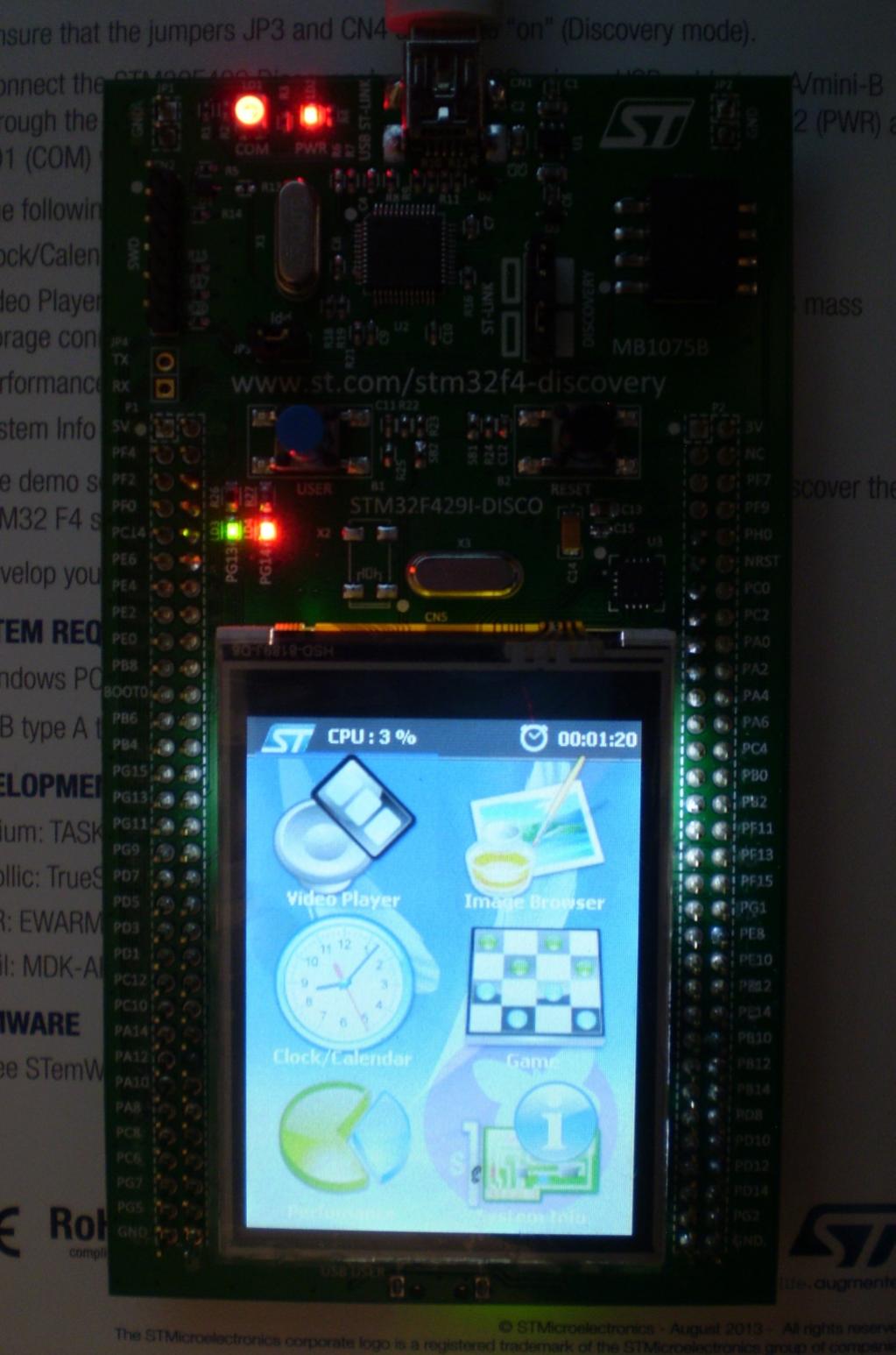

It is all new to me but going through the small course they touched on all of that and they did some demos of how to change things such as backgrounds and Icons and stuff with pictures of your choice.
The screen quality is much much better than what I could get my camera to produce a picture of (sorry about that)!!
They said it will play a movie from off of a USB card but haven't even started using it yet.
