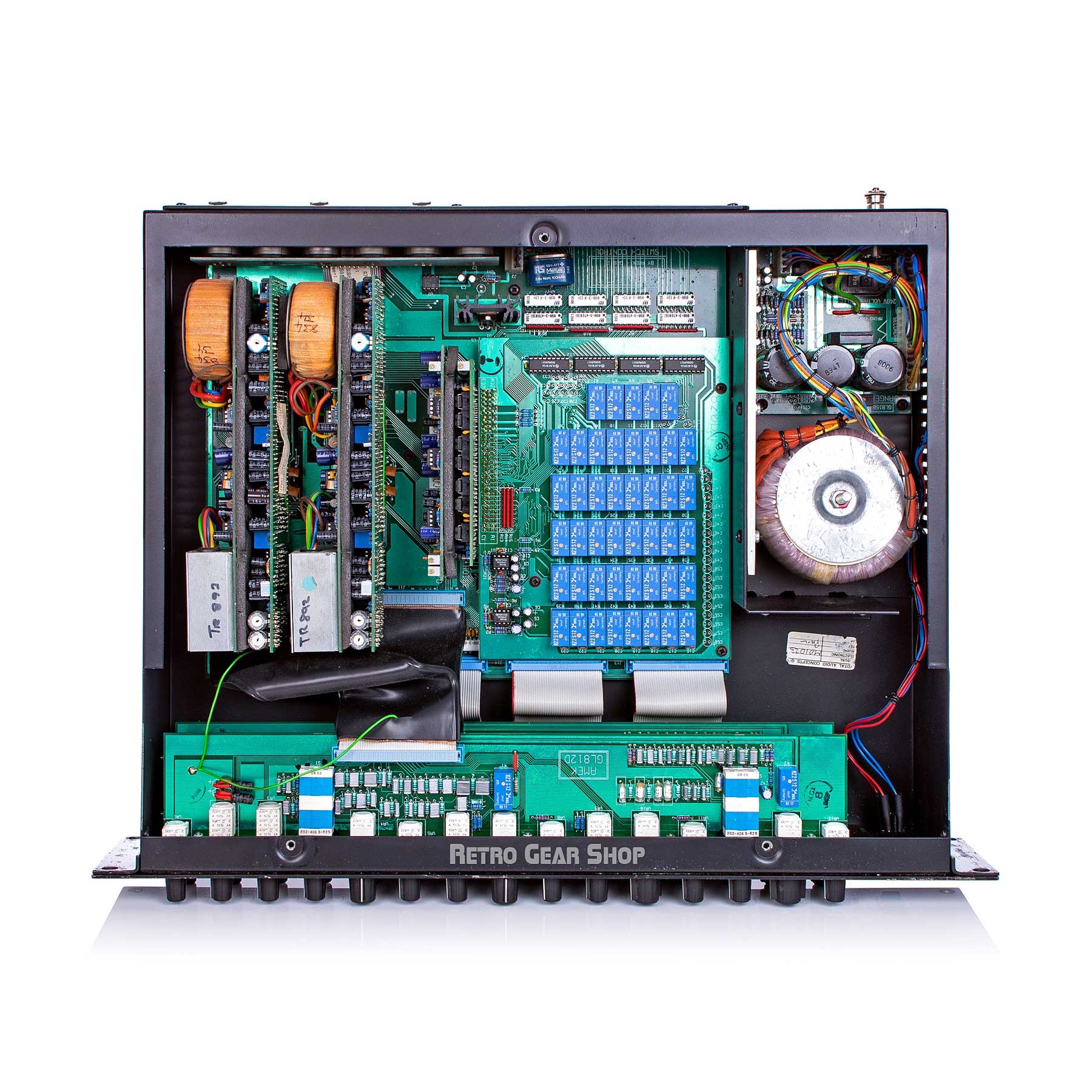

He resused the same topology ( and transfo) but simplified in Amek 9098 output circuitry including the transistor buffer stage after the 5534.
What makes me feels he didn't redesign for each generation is from the Amek line: the 'Medici' mastering eq is the same core circuit than the one used in the 9098 and Amek rack derivative: they all use a toroidal on output which is the same pumpkin as in the Focusrite consoles. See attached pic.
That said about non gapped transfo and dc, well he did differently in RND: the 'silk' and 'texture' knob introduce dc to the used transformer primary to gives an effect on bass signal by saturating core and there is change on the amount and frequency(?) of feedback around the transfo. I wasnt' able to confirm it's an ungapped core but i'm pretty sure it is.
On the last units there is a silk 'red' and 'blue' function and i'm pretty sure those are both trickery sperated one involving only feedback on hf, the other core saruration.
