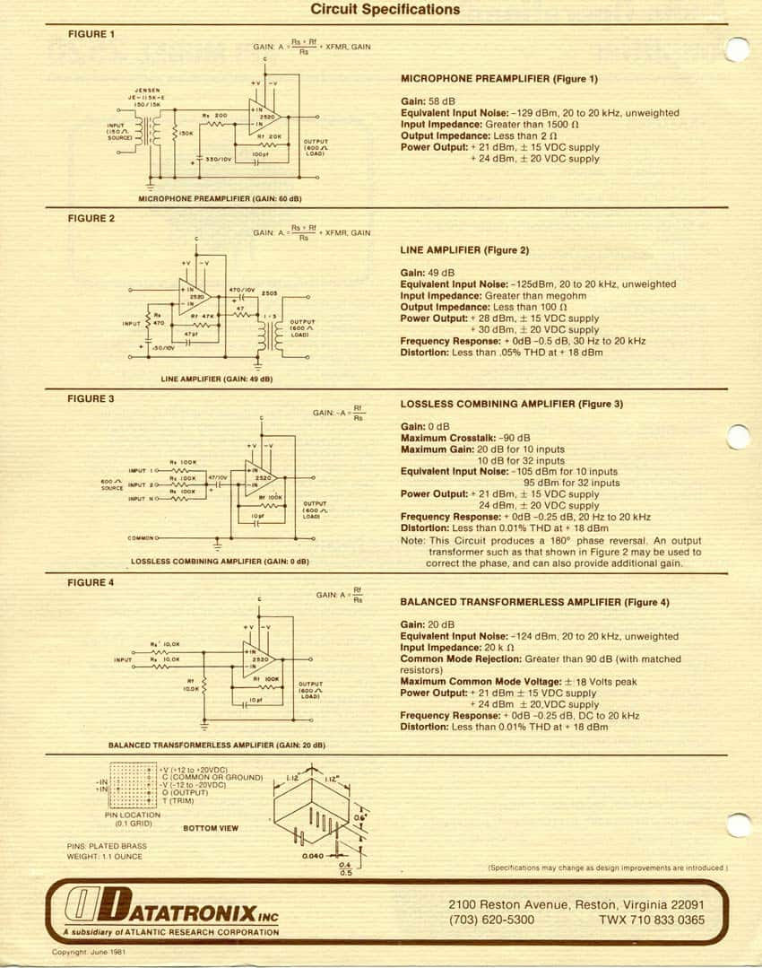

Api schematics, here we go.
Look for 'lossless combination amplifier' schem.
If you want the whole 'bus' thingy you'll need a pair of 2603 transfo on 'booster' cards ( see CAPI) and a pair of 2503 transformers to drive outside world ( in fact you put a 2603 on combining amplifier output, a fader ( 600ohm constant load) and then schem 2 and you have a 'booster' card...). 2520 DOA too ( many clones availlable, Scott Liebers 'red dots' are the undistinguishable from vintage originals, 'blue dots' modern variants as real API ones on offer).
