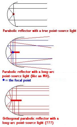

Below is an ugly sketch of what I think I understand about the orthogonal reflectors. Please tell me if this is wrong so noboby gets contaminated with my flawed logic 😉 . If the arc is placed in the axis perpendicular to the LCD, the area of the reflector that is actually BEHIND the arc acts as a normal parabolic reflector, with the back edge of the arc as the focal point. At points along the arc, however, the parabolic curvature changes to reflect radial light from the arc in parallel. This curvature continues until the end of the arc, where it resumes a parabolic shape. Is this right??? Maybe?
This would take advantage of the radial light from a long arc, which should be brighter and at least easier to control. In a conventional parabolic or elliptical reflector, much of the light is "wasted" if it is not being produced precisely at the focal point. Since we can't get our hands on a small arc bulb for a reasonable price, maybe this is our best bet?

Not quite right. In your #3 sketch all your parallel rays dont go parallel, they converge to a point to the right of the bulb. See my drawing few days ago.

the use of parabolic reflector only makes sense, if it has the at least the size of the panel. A spherical reflector primairly doubles the filament of the bulb for better brightness, that means it makes a real image on filaments plane. A PCX lens in every case converges lightrays, if parallel or not. In OHP the PCX lens pre- converge them before they go to the fresnel, which converges them finally to the projection lens.
